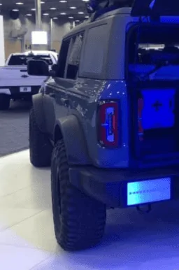

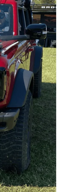

I saw the Overland concept Bronco at the Tulsa Auto show a couple of weeks ago. It has Fifteen 52 wheels on it with Sasquatch fender flares. I would assume those Fifteen 53 wheels are zero offset. Comparing these pictures of a Sasquatch to the Overland Concept. Looks like an inch plus more poke.

Do you plan to have offsets other than zero? Using a non-sasquatch Black Diamond if I swap the rims and keep the same tires, they're 2.2 inches further out. If I add the larger tires I want that moves to 2.7 inches, definitely a deal breaker.
June 14th build, hoping to install new wheels / tires day 1...would love the Traverse HD...but need the offset to be closer to +30!
