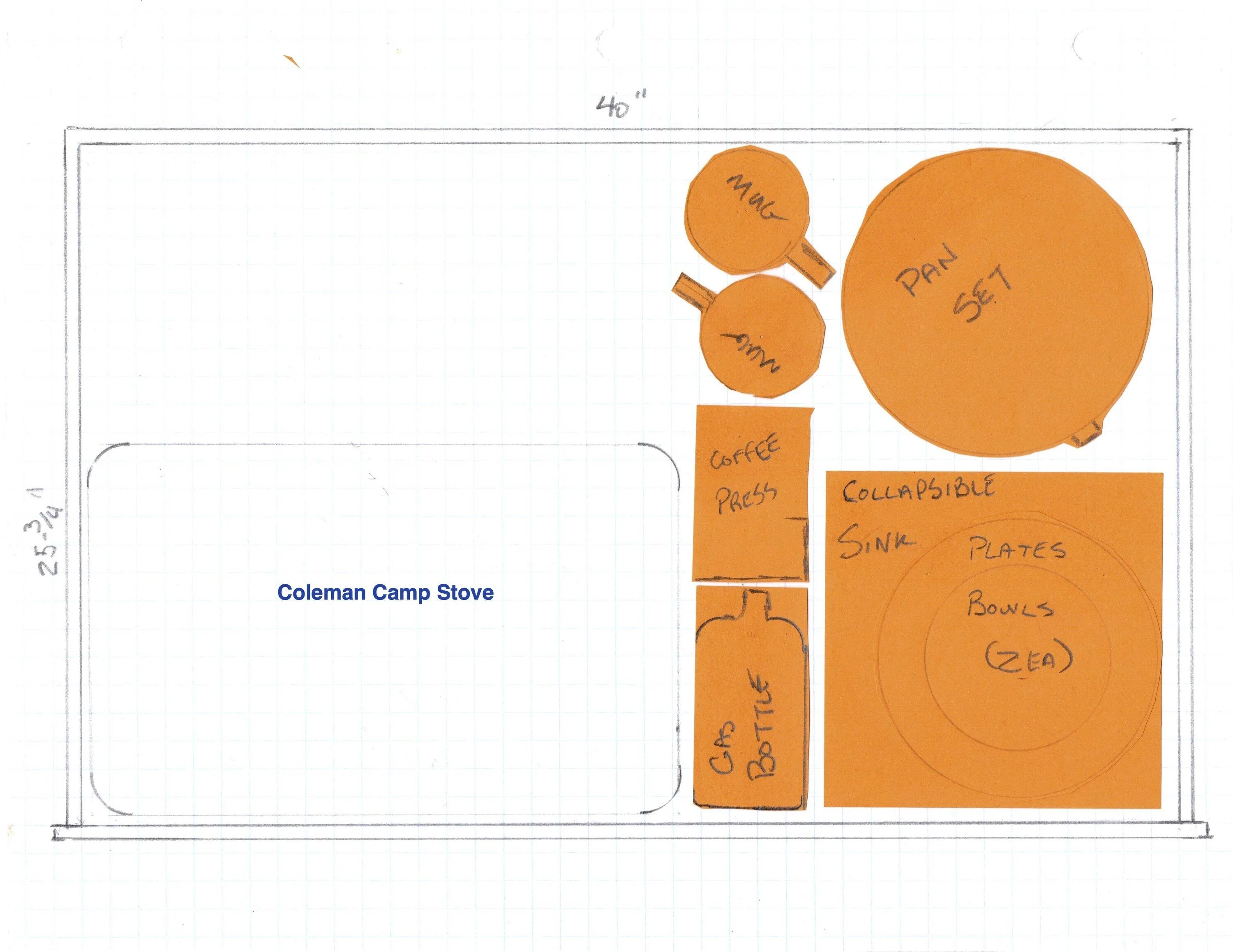

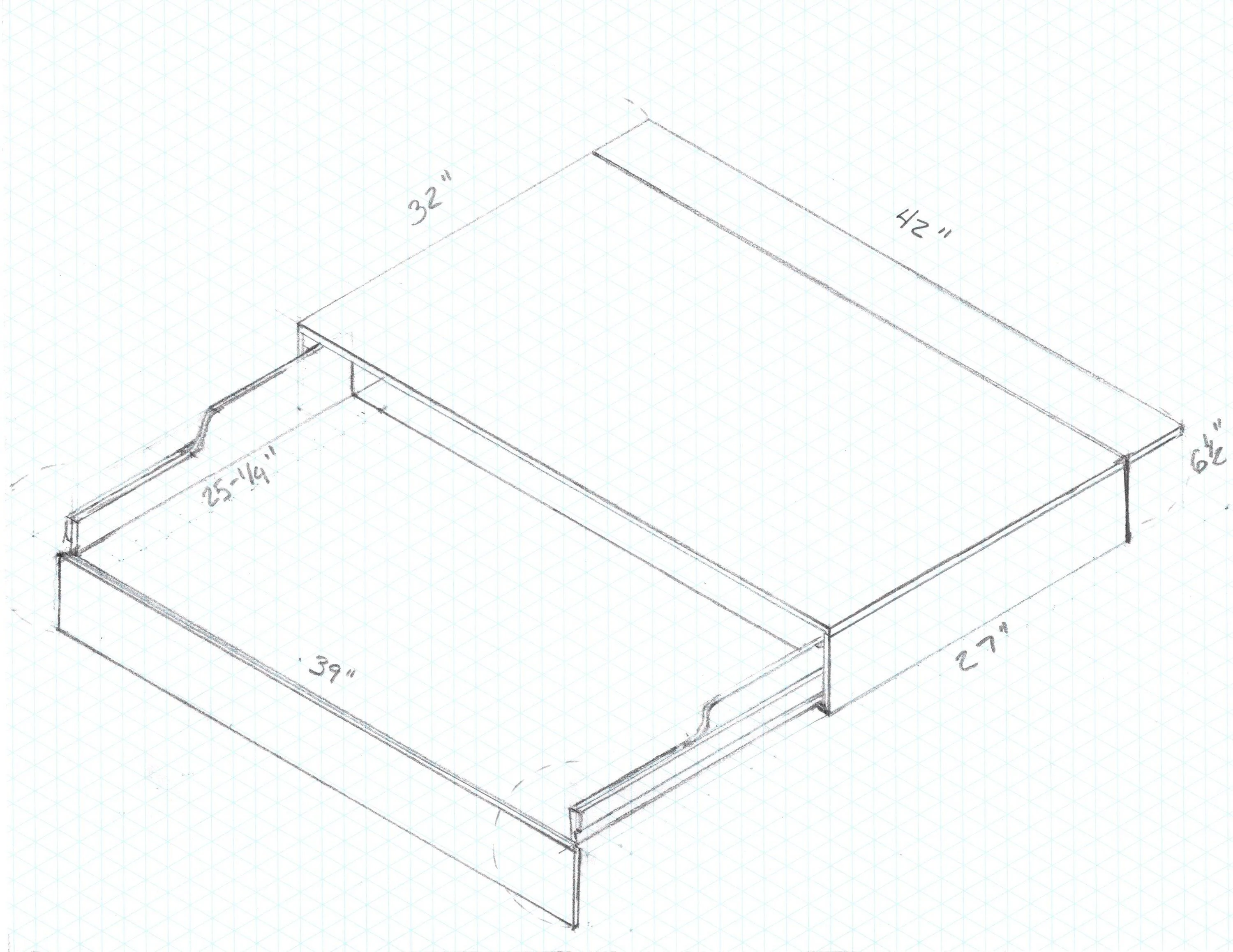

So as I build this, I can upload it as a community asset?
Ford Bronco Open-Source: Trunk Storage System (Open TSS) Bronco Drawer Camp Kitchen Sketch
Ford Bronco Open-Source: Trunk Storage System (Open TSS) Bronco Drawer Camp Kitchen Sketch 2
Of course! The best thing to do would be design in around the OEM Delete base so that it was a standardized platform.

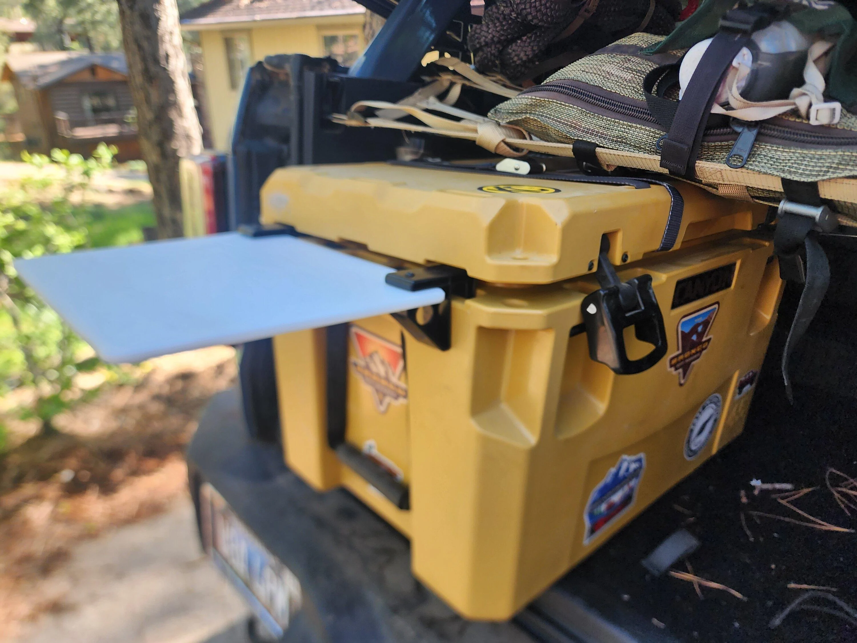

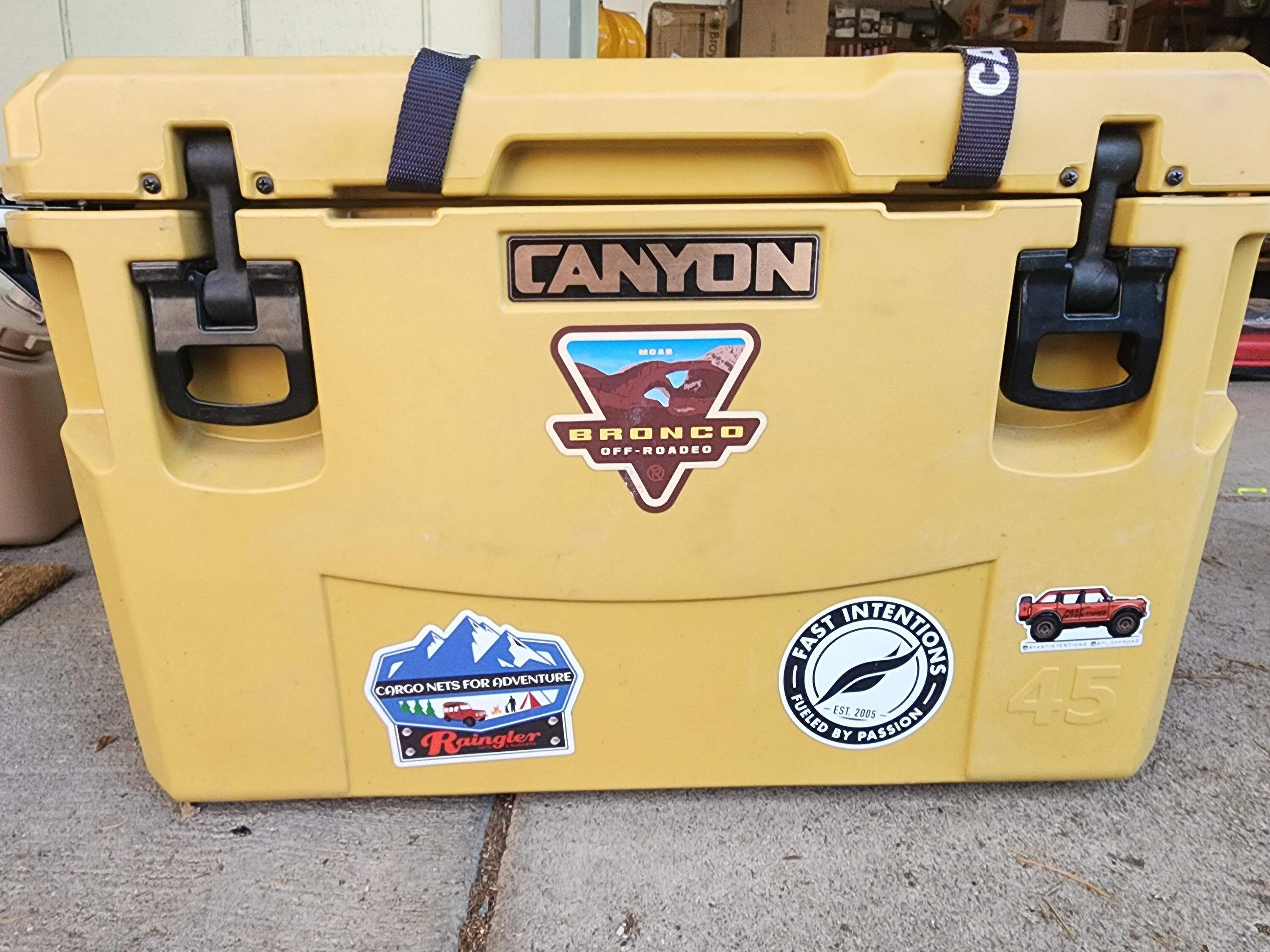

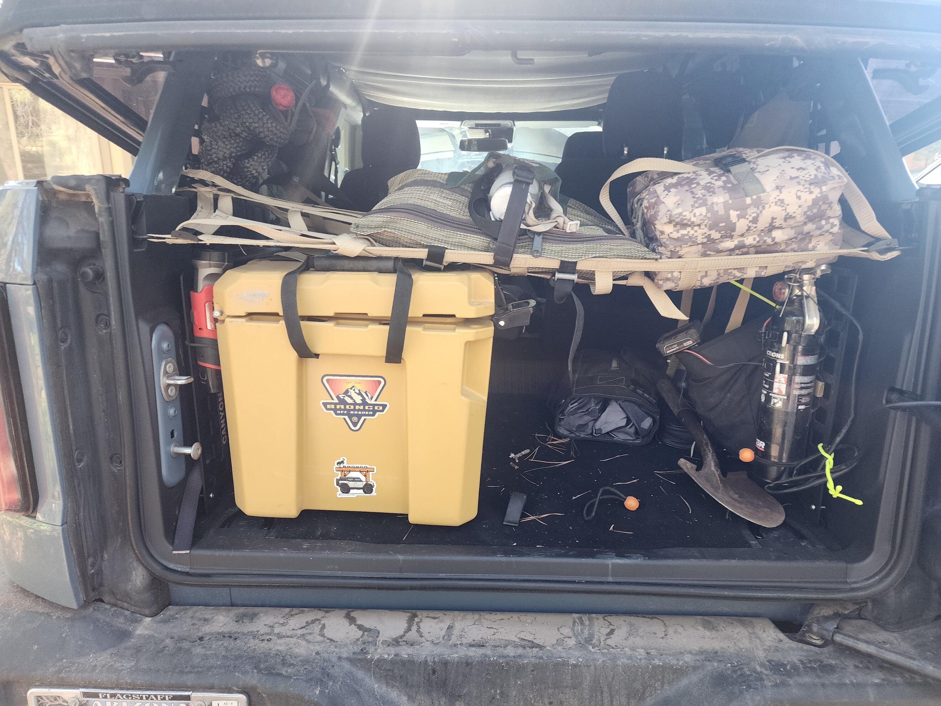

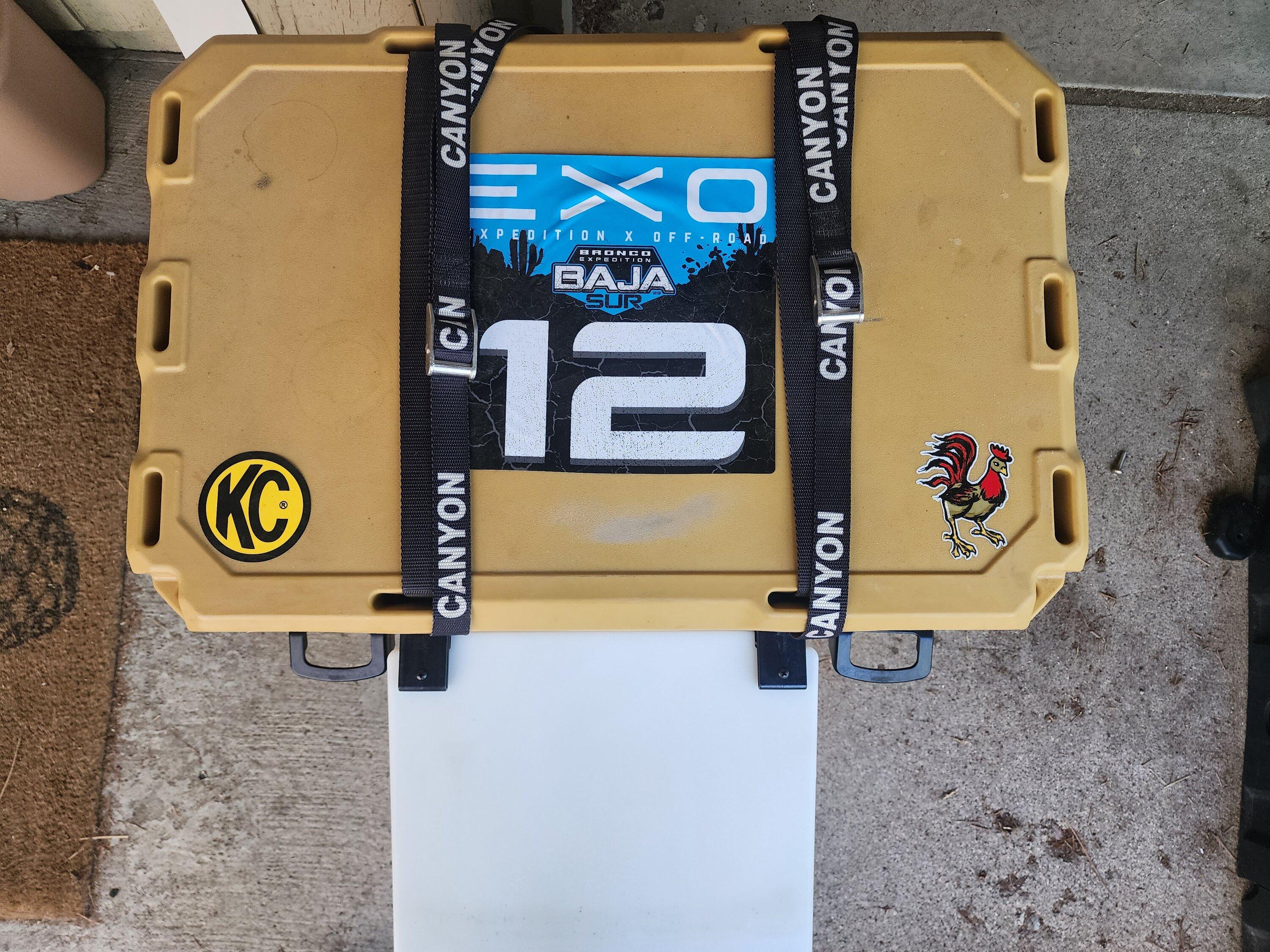

Now its getting interesting. The PRO45 is the largest that makes any sense. It has a prep table / divider that can be used anywhere on the cooler. The lid and body has lots of attachment points, and it accepts standard catering pans for internal racks. Maybe we can make a sink holder for the cooler too.
The base is 16.6" x 25"

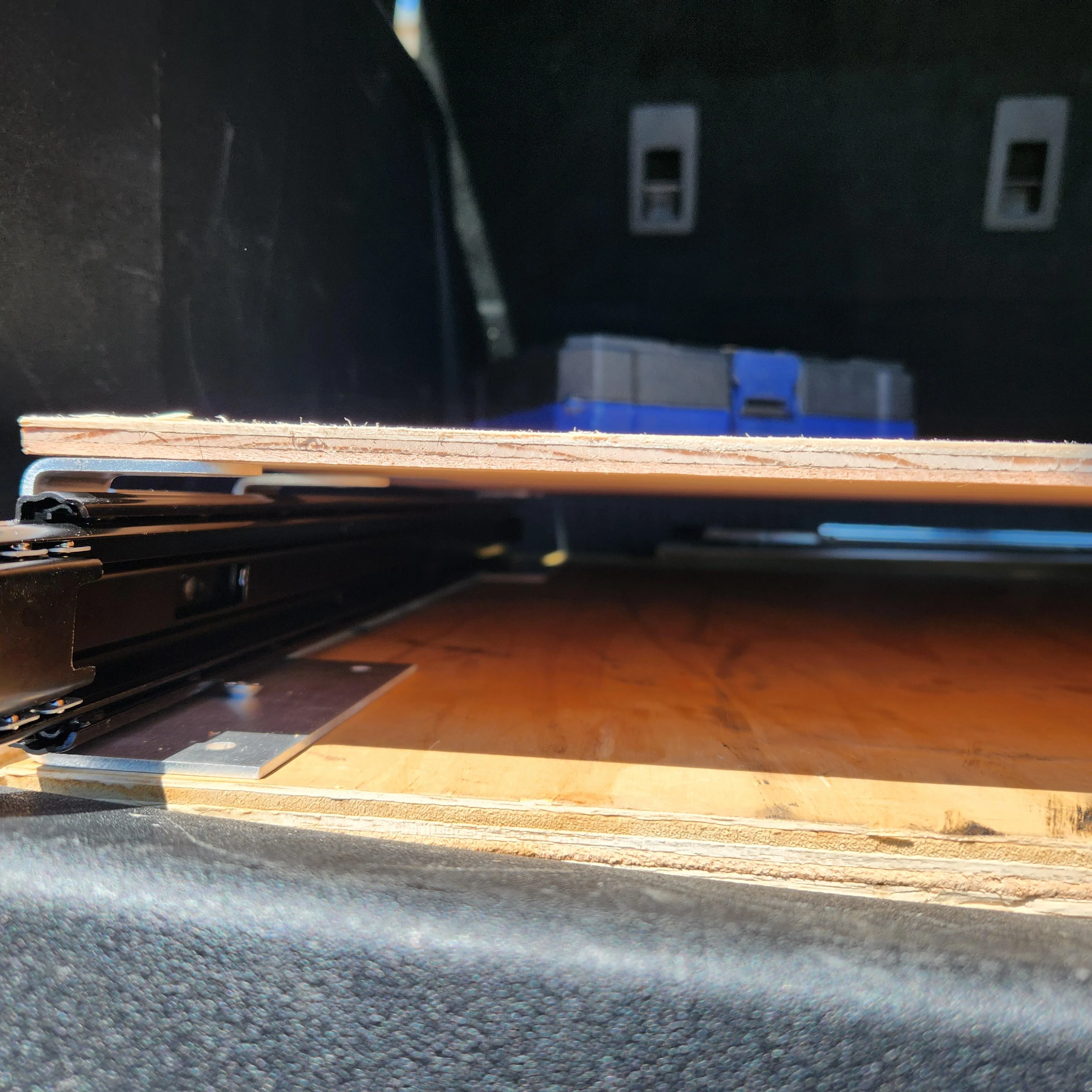

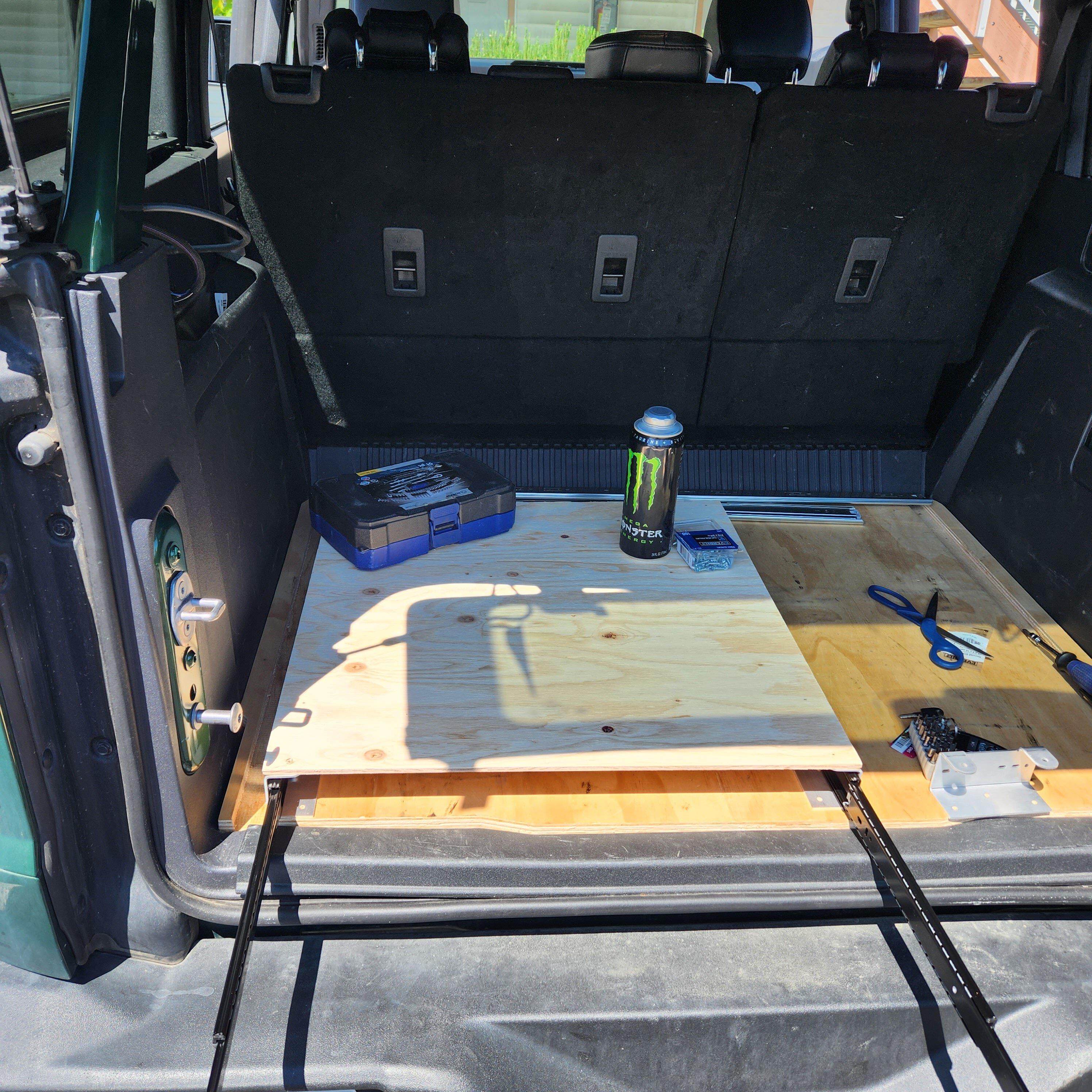

A sink holder would be awesome for the coolers. Maybe a dual slide out system so the cooler slides like 20" and then a set of smaller slides nested below so a sink can slide out? That would give someone a more comfortable space to work.
I am installing brackets and slides today to test fitment.

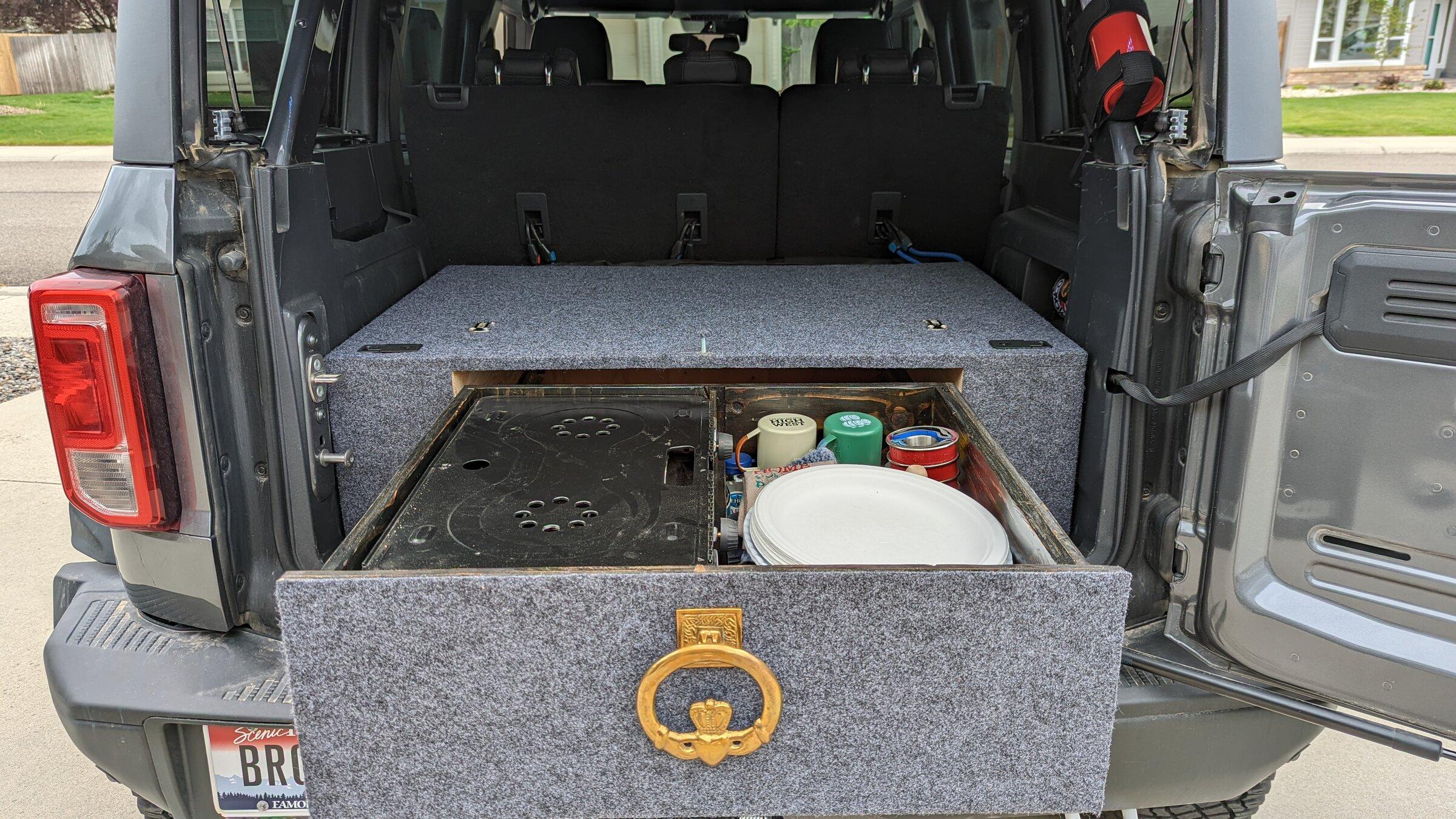

Why is the drawer on the driver side? The 60% seat split is on the driver side, those of us who want to sleep in the back of the vehicle would prefer to see the drawer on the passenger side.

You can assemble it that way if you'd like. I just threw it there to model a quick mock up.
