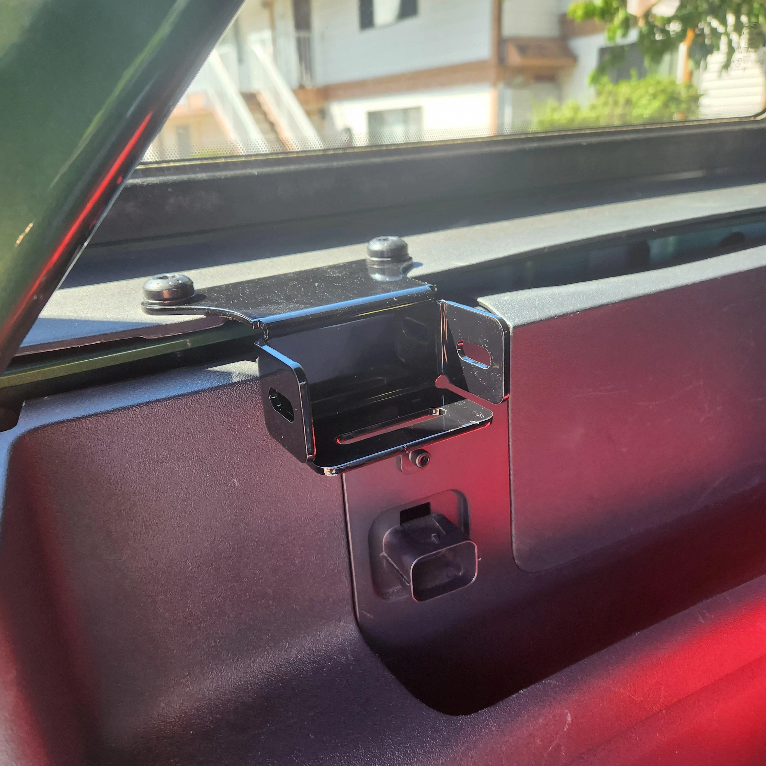

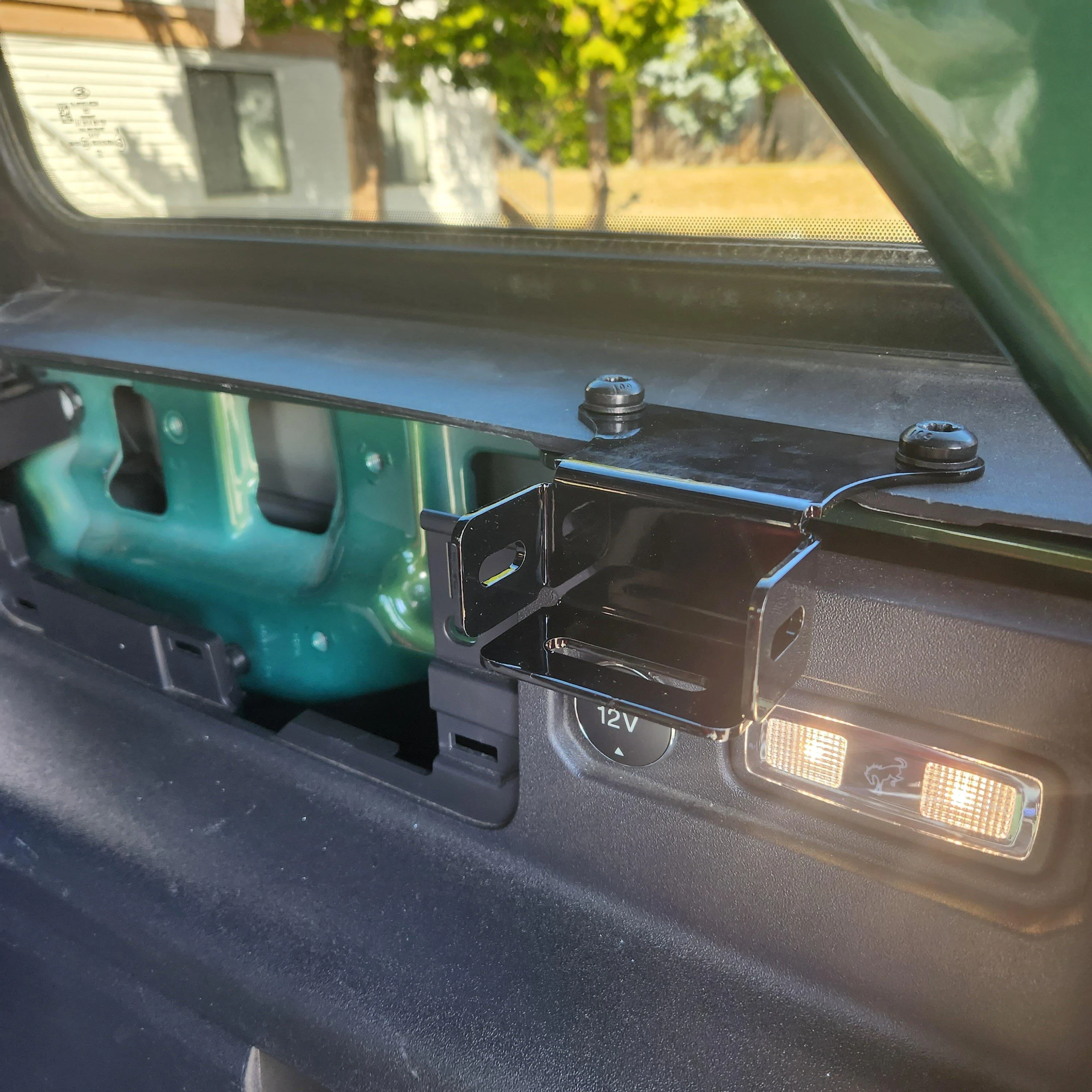

Just a quick update while I wait for additional parts. I made this brackets that can be used to mount 80/20 rail 15 series to the bottom of the roof cap. I'll post addition pictures when I rig up the shelf.

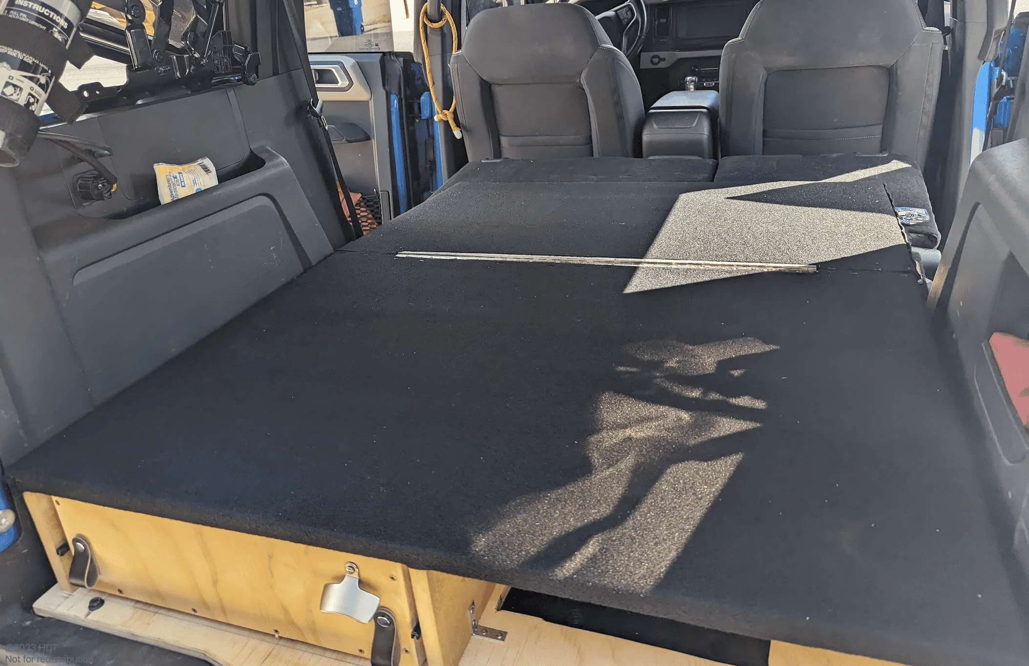

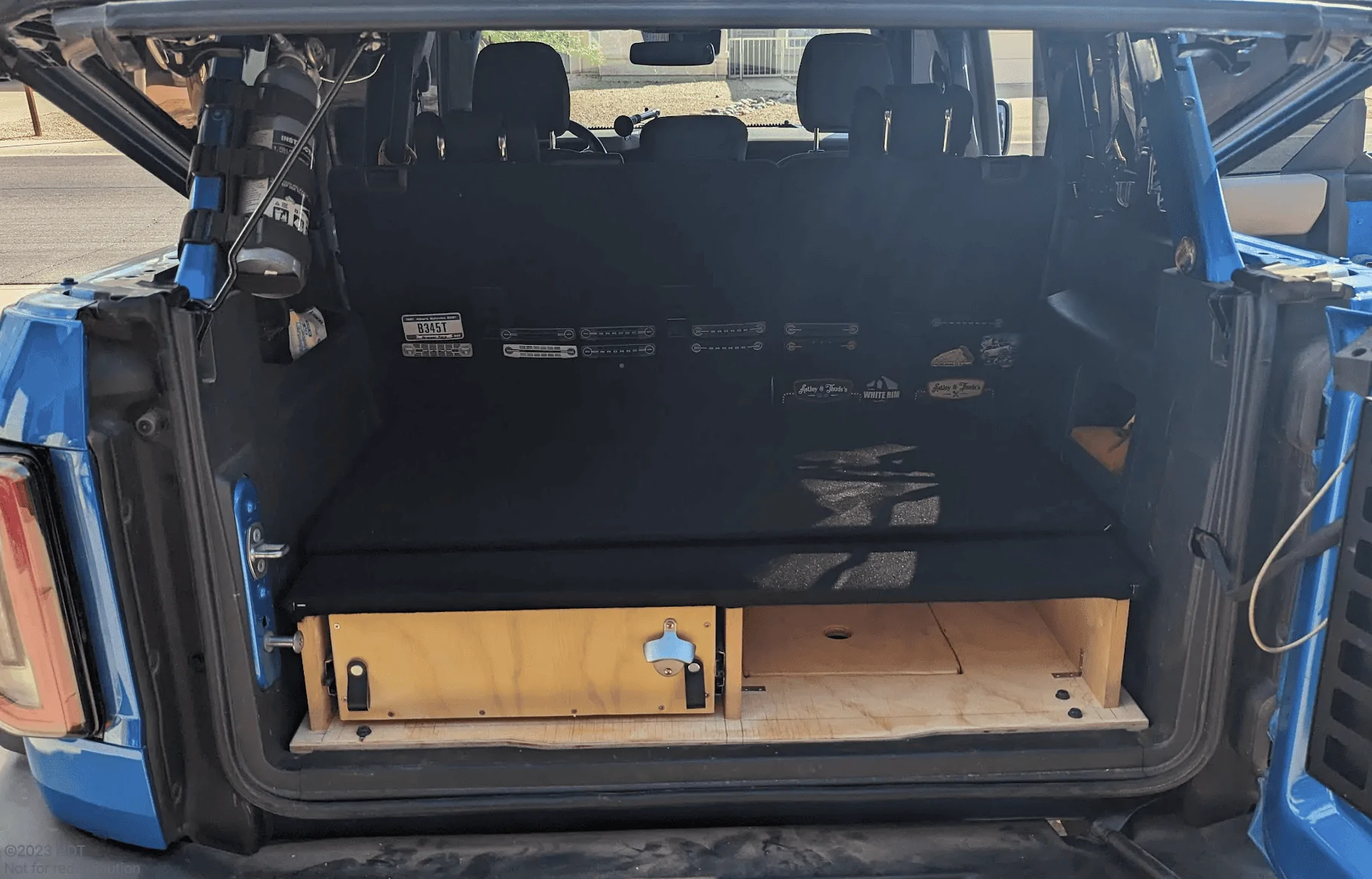

For the curious, this is what can be done with it. This is still a work in progress, but I had a fair bit of progress this weekend, figured I'd share for those wanting ideas.

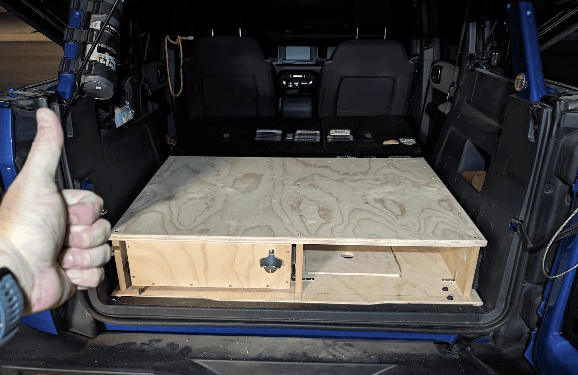

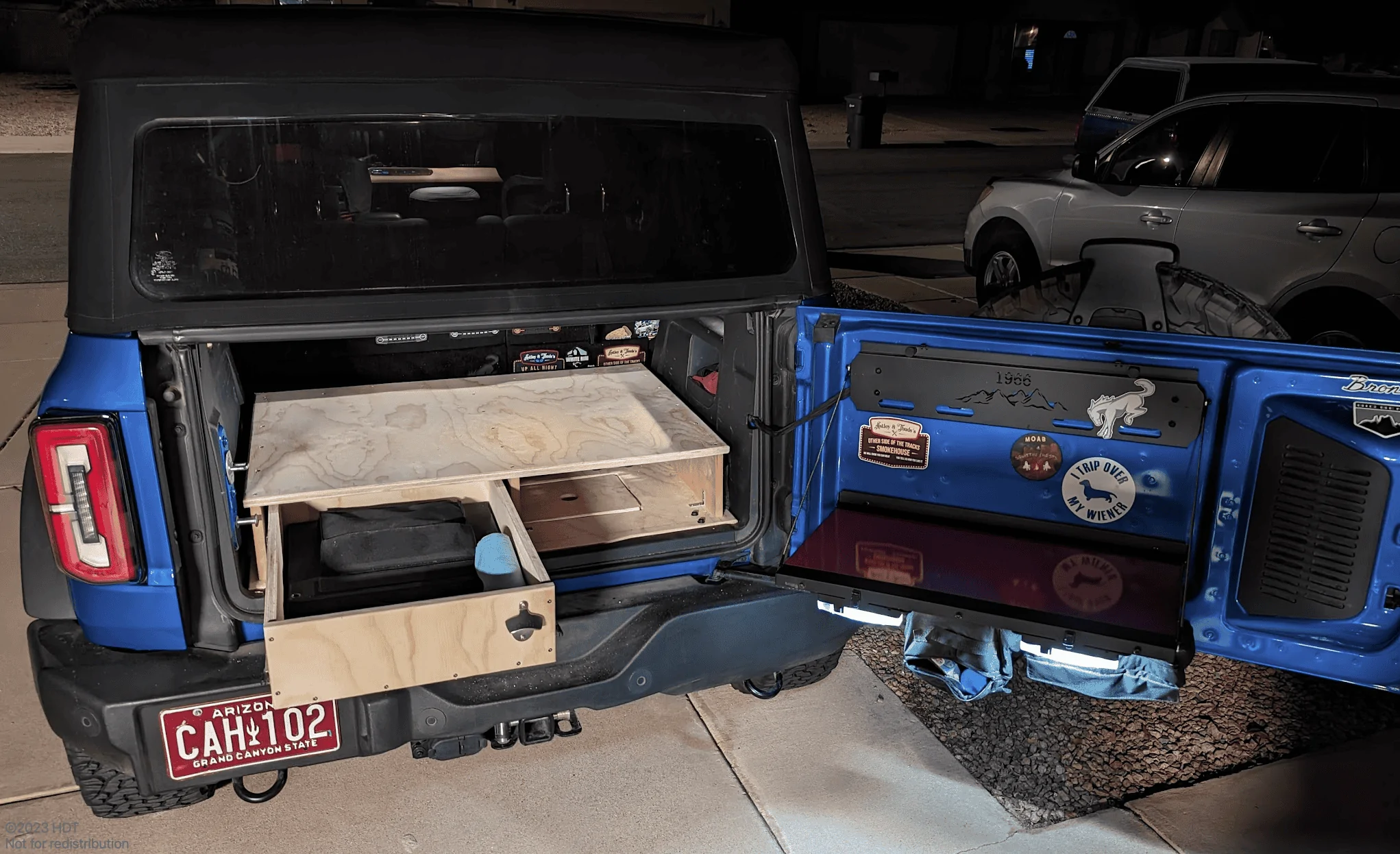

replying to my own post as a follow-up for what the final product looks like.
Ford Bronco Open-Source: Trunk Storage System (Open TSS) 1692380797847

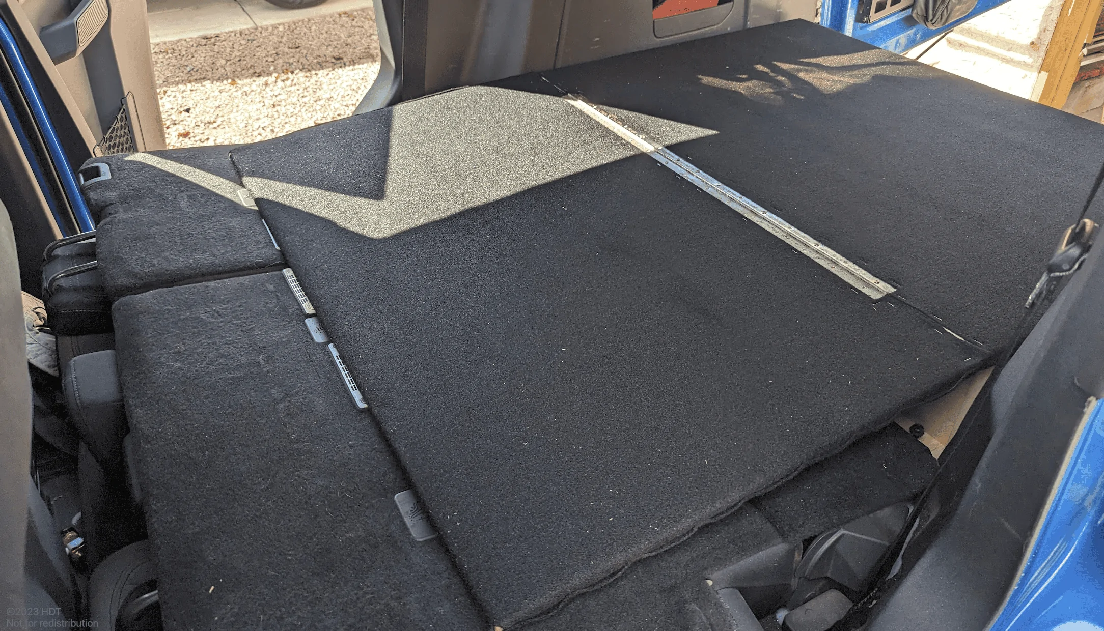

Got around to installing some polymat on the top, and installing the flip panel
Ford Bronco Open-Source: Trunk Storage System (Open TSS) 1692380913186
Ford Bronco Open-Source: Trunk Storage System (Open TSS) 1692381014912
Ford Bronco Open-Source: Trunk Storage System (Open TSS) 1692381230708
Some caveats to save other people the headaches.
The left side near the door has to be at least 1 1/8-1 1/4 back from the front end of the floorboard, or the door bulge will not clear. The left side riser has to be about the same distance away from the wall, or a drawer on slides will not clear.
Angling the platform to the front of the truck was also necessary to help the drawer clear the plastic outer on the fascia of the trunk. I got some 1/8" rubber washers and stuffed 1 under each of the rear mounts, and 3 under the front mounts so that it angles up, and doesn't squeak and rattle going down the road.
You will lose the factory jack location, but the factory jack is kinda flimsy, and a 4ton bottle jack fits in the black bin just fine. a 10"x12" access panel was cut into the floor to get at it, and then just router'd out a hole to be able to remove it.
The area in front of the drawers was intentionally left empty for some storage of random soft crap for camping, (sleeping pads, ponchos, etc)
All in all, super happy with the aesthetics and functionality, even if gorilla me built it. I kinda almost want to build another just to not make the same mistakes I did the first time.
Thanks again to @Russ.Cere for the knowledge sharing.
