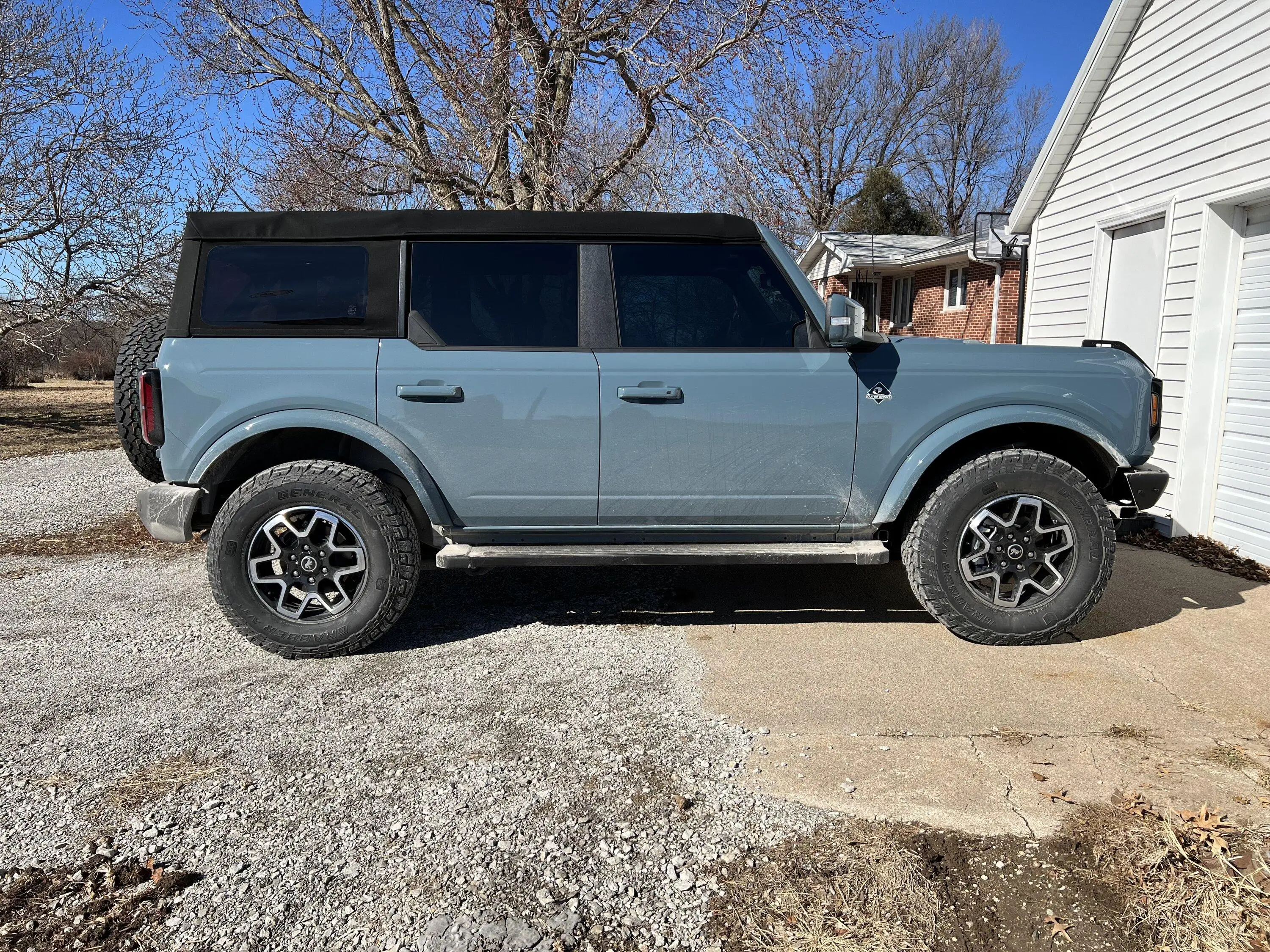

I'm pretty sure Rudy already has OBX wheels and tires and is looking to step up.
I also have a nonsquatch OBX and just installed a set of 35" sas takeoffs that I purchased from another forum member.
Crash bars needed to be removed, and I had a 1" leveling kit installed. Aside from those things and a little surgery to remove a little bit of the inside portion of the mudflaps, they fit like a glove and look awesome.
I'll post some pictures if you want to see them

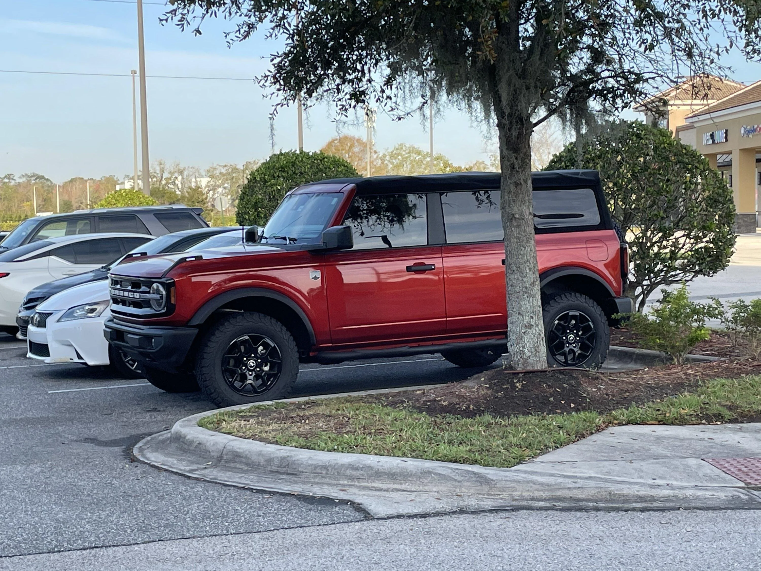

Ford Bronco Outer Banks wheel help 3F09E36B-D904-47CE-BBED-2008D6D65653
this is not mine, but I like the factory rim when it’s blacked out, only issue is it would have to have a narrower 35” to work. Priced out powder coating and it runs $125-150 a wheel in my area.
I powder coated my OutBanks rims. What a difference. Worth the cost.
Amazing and much improved look to the standard OB wheel. I did find wheels for mine and have been trying to sell my old ones. I may powder coat and keep as a spare set. Thanks

There are plenty of options out there for an 18" wheel. I stuck with the stock OBX wheels because I plan to powder coat them black in the future after seeing it done in a few posts here, and narrowed it down to three solid options for my use case. I went with 275/70r18 tires which are 33", and the three top performers I found were BFG K02, Falken Wildpeak AT3W, and Goodyear Ultraterrain (Discount tire/America's tire exclusive)
I went with the Ultraterrains, which felt like a pretty rough ride until I did a chalk test and found that the tire shop overinflated the tires. Once I aired down to the proper PSI it was much smoother, and when compared to my friend's OBX with stock tires, I barely notice a difference.
As others have said, 35"s do fit a stock OBX non SAS, the only change you need to do is remove the crash bars. A level kit will make it look better, but you shouldn't have rubbing unless it's over 35" true diameter (Mine are a 33" tire, but the true diameter is 33.2". Tires can be slightly larger than the listed size depending on the tire).
If you decide to stick with the stock OBX wheels, I hope this helps! If you're set on new wheels too, I can't help you as I haven't changed mine or looked into it.
