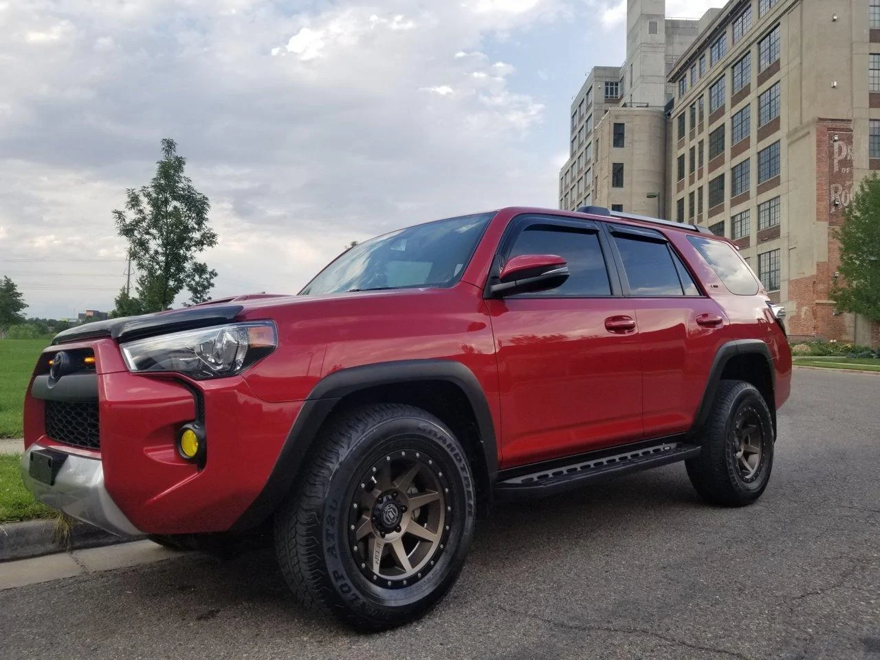

Paint, powder coat, or something else altogether?
My thought was to take the ring off the stock squatch wheel and change the color to gold. I would leave the bead lock ring black.
Pic for reference:
Ford Bronco Paint or powder coating on wheels 20180722_184850
I'll be going with Rapid Red, so the effect would be very similar.
Thanks in advance for your thoughts.

I like your vision. Gold may not be the choice for me, but with the picture you have provided I can visualize it.
My thoughts were the opposite. Leave the wheel black but powder coat/paint the ring maybe body color.

I think tjat is more of a bronze but yes. If I go diamondmansquatch I have been thinking about stripping and clear coating or some color. I have American Racing Torq Thrust II's on the mustang that are polished alum...i hate it as the maintenance is horrible and want to clear or coat them badly. The 17 escape ww have has black rims and not sure i want both newer cars with black rims.

Painting may allow for easier touch-up repair when needed. I've read where that's the reason for painting rock rails/sliders rather than powder coat.
Yeah, bronze more than gold. Definitely a muted color. Polished aluminum looks great on the right car, but I've fought with that upkeep in the past too...
Think it depends on it's purpose, will it stay on road or off?
I will definitely be taking off road, but better than 80% will be to work and back.
That's a really good point. Paint would be easier to touch up. I wonder about the hardness difference between the two coatings.

Two sets of wheels and tires. Steel wheels with sloppy tires for offroad, whatever it comes with for daily driving. Them offroad tires are going to be expensive, and bad enough they are going to risk getting blown out, but why wear them down with daily driving?
Paint won't matter, they gonna be dirty.

Paint is easier to scratch but PC will chip and scratch, I'm not an off-roader but if you're going to be in the rocks and woods I'd go with something you could just touch up with a rattle can if it gets too unpresentable. The idea about 2 sets of wheels is probably a good one, look at what others are doing on the trails to help make your decision as well.

If you are considering powdercoat, also consider the pc needs to be baked and cured at 400*F..... you may need to strip existing finishes and certainly must remove the tires!
Either paint or powdercoat will require proper prep, which could range from scuffing the existing to fully stripping it.
Plasti Dip is a different animal, it's not considered a permanent finish.

There is a shop around the corner from my house that does p.c., if I went that route, I would take the fires off and have them do the work. Paint is sounding a lot like easier route, but I'm worried about the final product coming out of a rattle can.
Neither am I... Yet? I like the idea of having 2 sets of wheels, but the space to store them, and frankly the expense of maintaining two sets may be two steep to be viable. A can of Krylon is a lot easier to carry around for sure...

You could paint using a spray gun and use a modern paint such as a urethane. It's durable stuff. Wheel could be easily prepped by degreasing and thoroughly scrubbing with a Scotch Brite pad to ensure adhesion.
