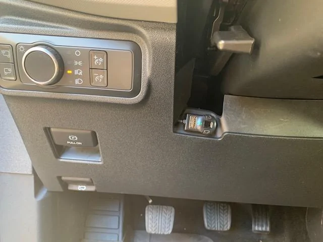

Received the Pedal Commander kit a couple of days ago and installed it last night. After ensuring the ecu was powered down and (both) key fobs were distanced I hooked it up and connected it to the my phone via bluetooth. Worked great. Then I needed to decide where to mount the controller. It could be tucked up under the steering column out of sight. But, I was concerned that, should I not have my phone on me, it would be challenging to reach, easily.
I briefly considered mounting it on the panel below the steering column, but was concerned about having it visible when I run the Bronco without a top, and possibly doors. So, I decided to try to thread it under the dash to the passenger side and into the glove box.

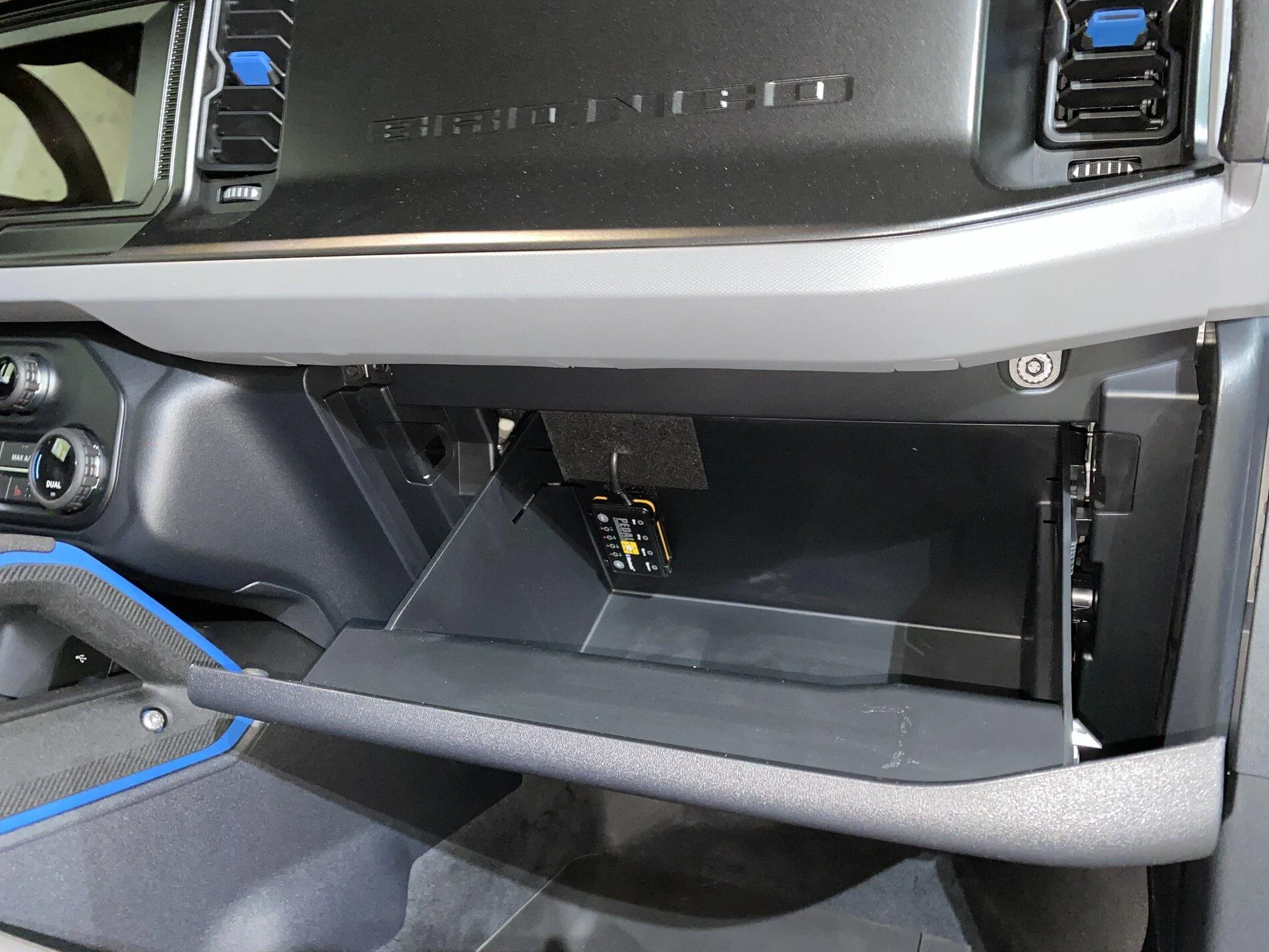

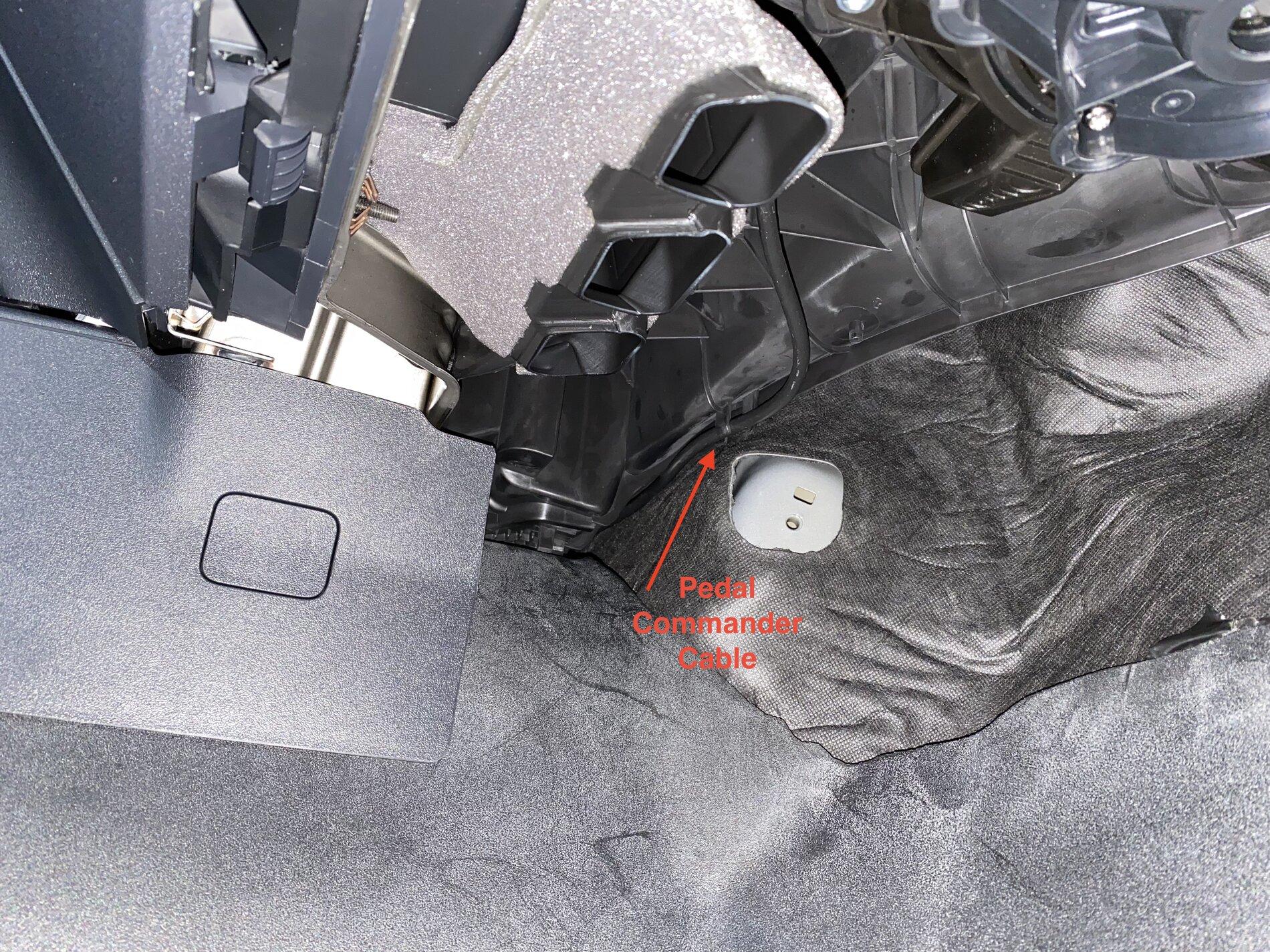

Snaking it between the firewall and lower dash (climate control unit, presumably) was a little taxing - would be much easier with two people. After some coaxing, a lot of taking observations from both ends, and some expletives, I finally got it pushed through. The gap on my rig is just enough to fit the controller, but it has to be precisely oriented to slide through.
Next, I dropped the glove box and released the hinge arm, then removed the box to my shop. I cut a slot (1-3/4" x 5/8") just large enough to pass the controller through, then sized a section of adhesive-backed felt to cover the hole. Reinstalled the box, ran the controller inside, secured it, then applied the felt to obscure the slot.
Altogether pretty happy with the relatively clean install. Also discovered that the glove box can be locked - with the Mid package I sort of assumed it couldn't.
