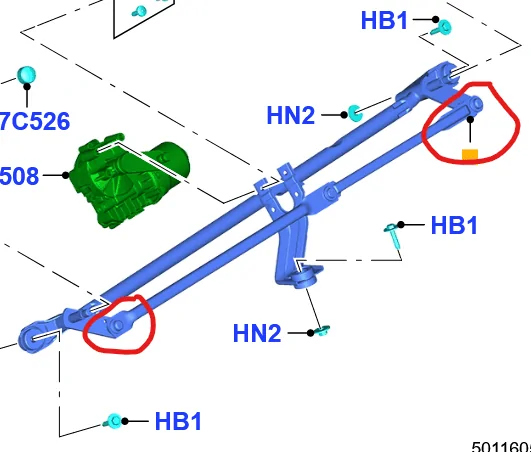

Lastly, @E. J asked if checking the linkage for binding and adjusting might help, this might also be an area to look into.

Has anyone checked (or know if dealer techs are) the linkage joints for proper movement? Like being overly tightened. Could be a contributor to the problem.
drawing source
