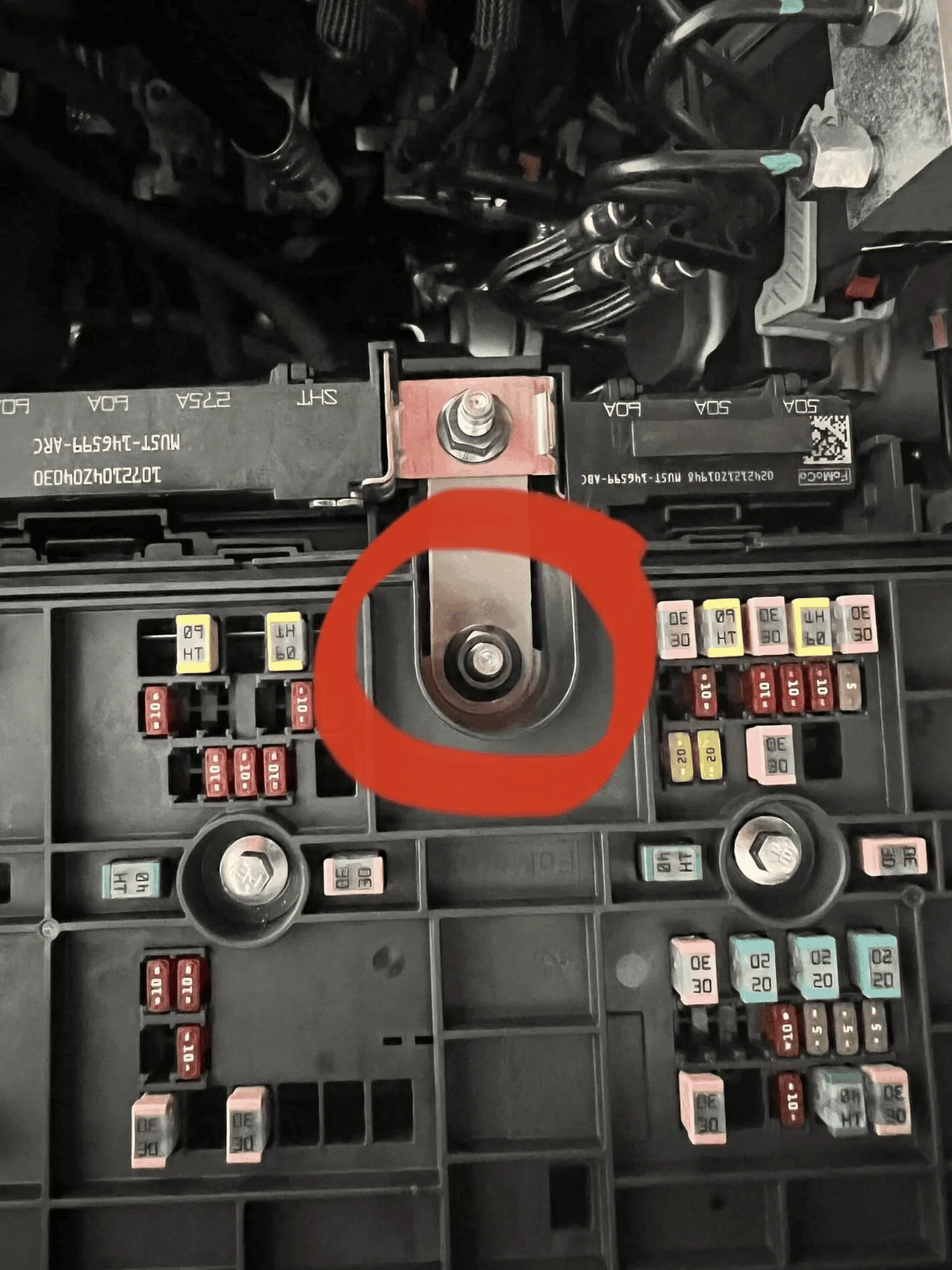

Have you checked the electrical connections in the fuse box? I've read about it causing weird electrical issues when the factory doesn't tighten the connections properly. šŸ¤·ā€ā™‚ļø

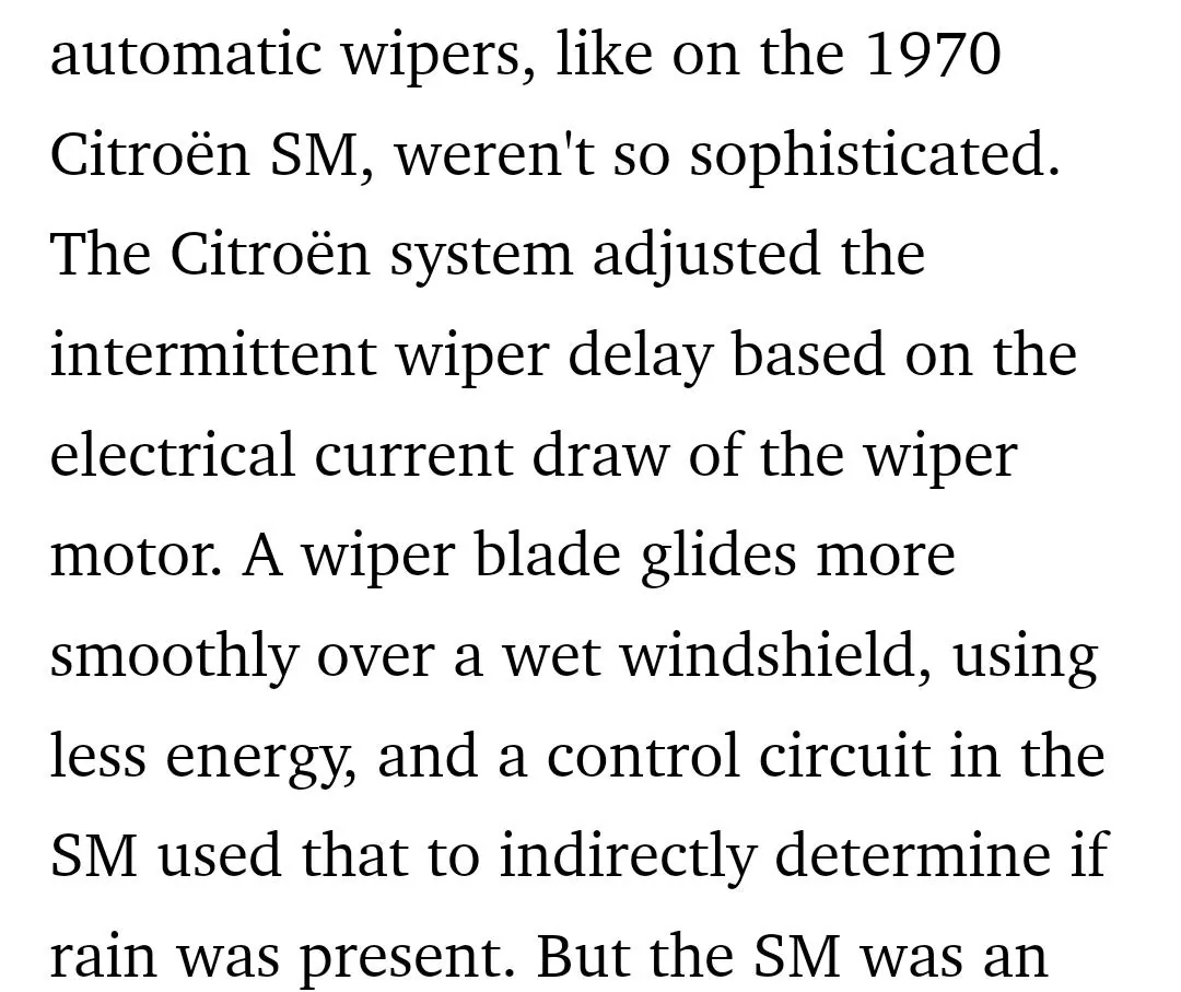

I wonder if Ford is employing something like this....
They no longer just use simple motors for the wipers.
My Escape with the push-out wipers weren't even mechanically connected to one another. Likely AC frequency drives, like the window motors.
