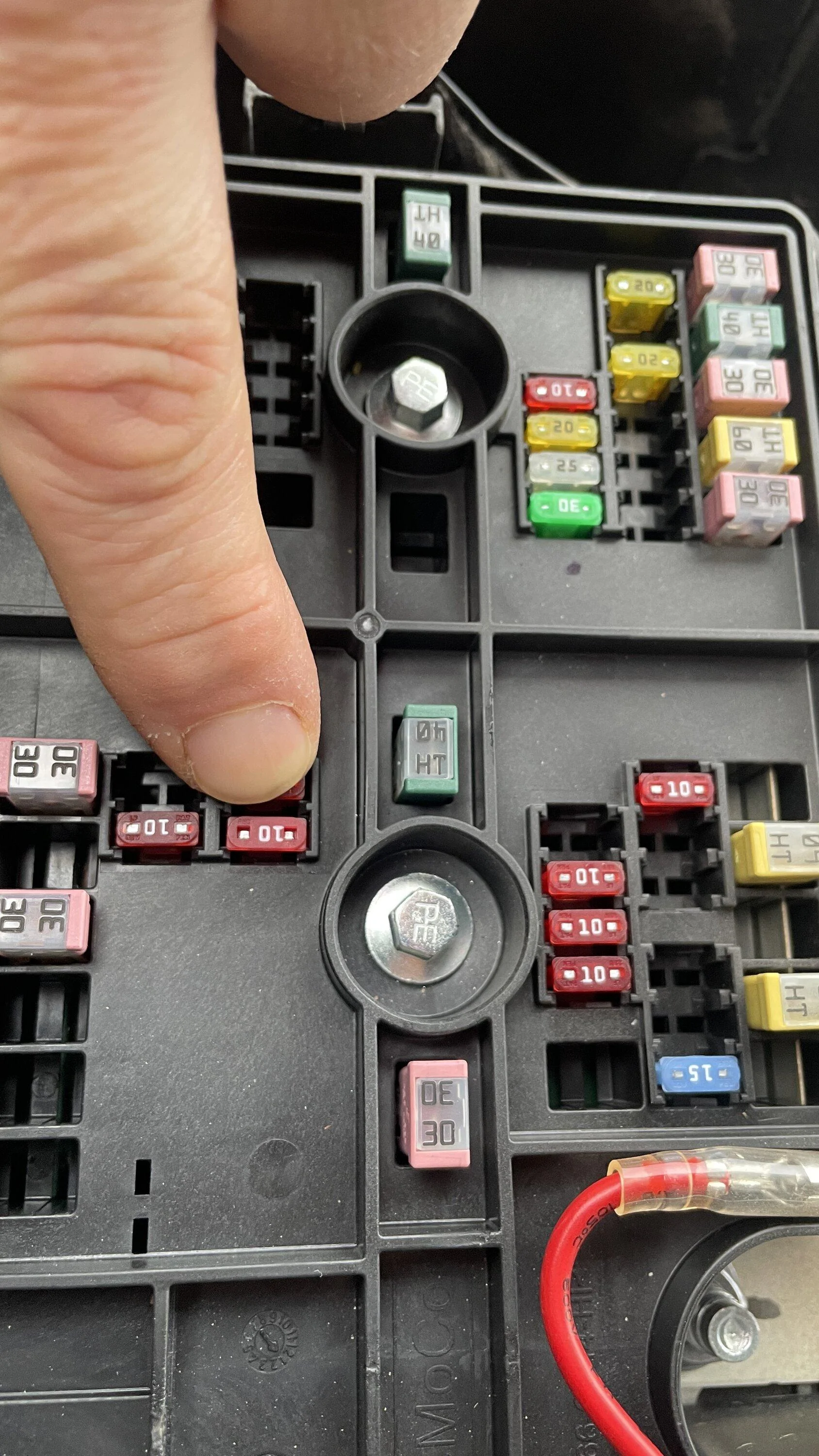

For anyone else check fuse #16 in the under hood fuse box. Ours quit when it was in the neg temps. I even tho I always buy quality -25/-30F fluid. I thought oh well it froze. Well we got back into the upper thirties. And it still didn’t work I went looking around and found the fuse was blown.
