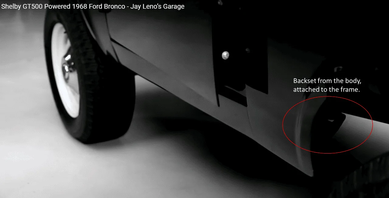

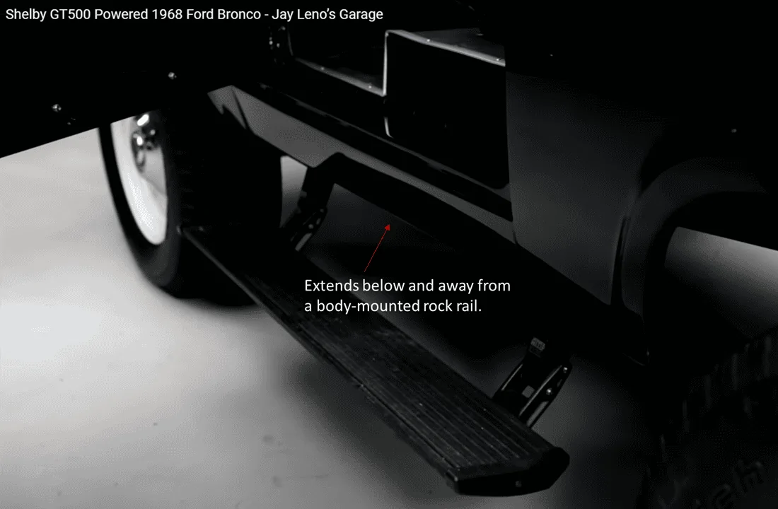

I'm hoping for the best of both worlds. I want rock rail and a separate power step. Similar to the Jay Leno rebuild. It's possible, but it might need to be custom.
The step on Jays are from AMP base on the build sheet that I saw. Probably custom. Wheels are custom from Detroit steel wheels. I thought about building a copy cat in Anti Matter Blue.
Lab00Rat
1,586
4,392
MS
2022 BL 2-Door, 2021 Ford Ranger
I figured it was custom based on the retracted position. Similar to what I'd like.
