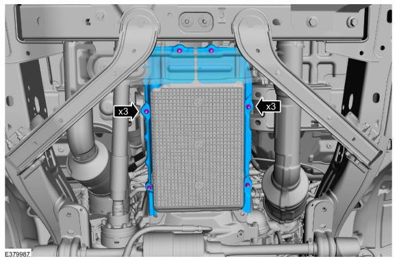

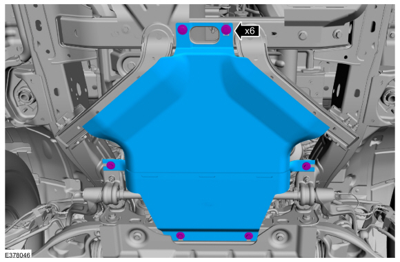

  1. If equipped, remove the bolts and the rear skid plate.

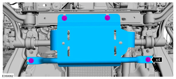

  1. If equipped, remove the bolts and the skid plate.

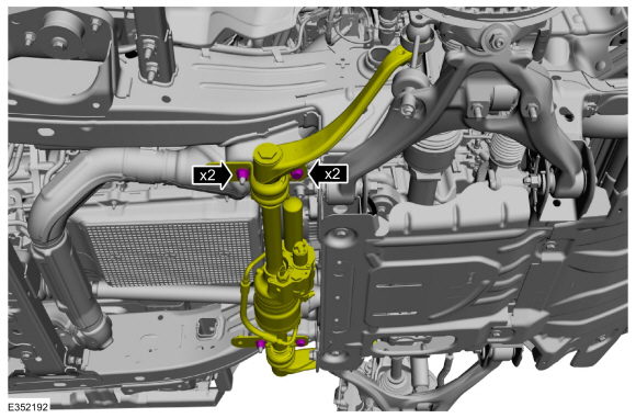

Vehicles with Sway Bar Disconnect

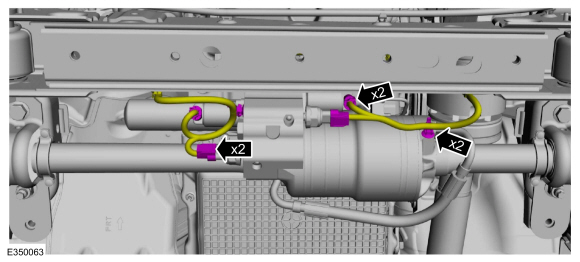

  1. Disconnect the electrical connectors and the wiring harness retainers from the sway bar disconnect.
Ford Bronco {thread} {filename}

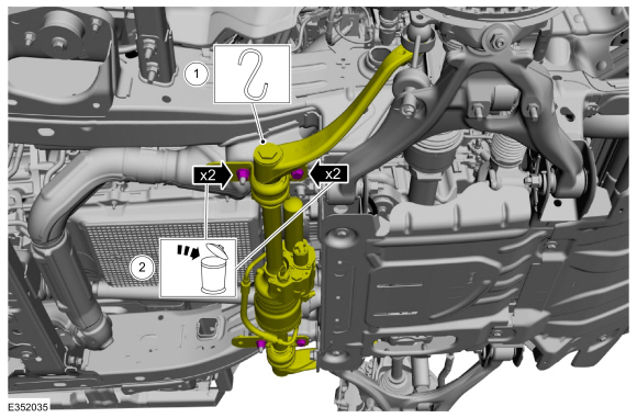

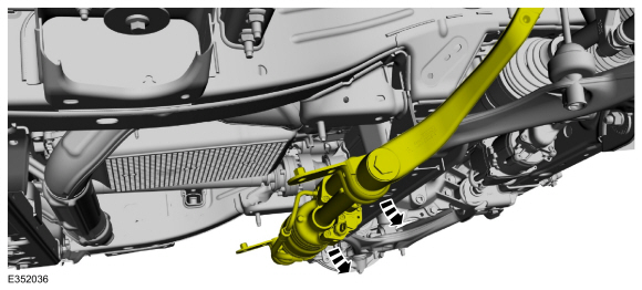

    1. Support the sway bar disconnect.
    1. Remove and discard the nuts and bolts.
  1. Allow the sway bar disconnect to lower.

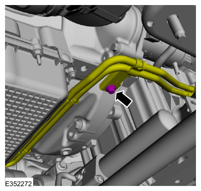

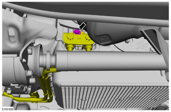

  1. Remove the transmission fluid heat exchanger tube bracket bolt.

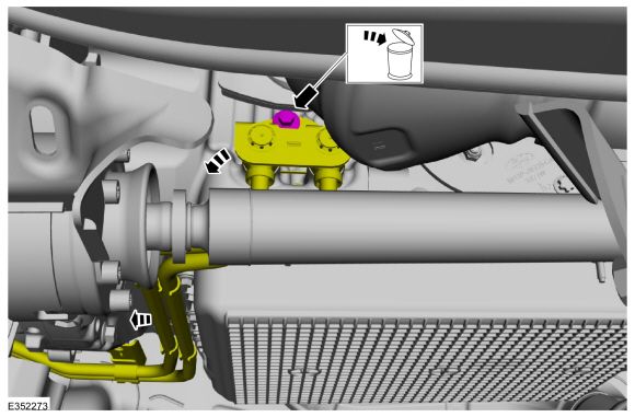

  1. Remove and discard the bolt and position aside the transmission fluid heat exchanger tubes.

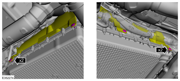

  1. If equipped, remove the retainers and the LH and RH heatshields.

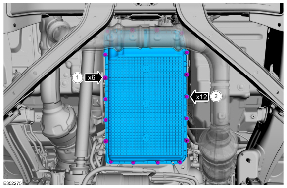

  1. NOTE: Note the location of the bolts and studbolts for assembly.
    NOTE: Be prepared to collect escaping fluid.
    Remove the transmission fluid pan bolts and allow the transmission fluid to drain.
  1. NOTE: The transmission fluid pan gasket can be reused if not damaged.
    NOTE: Note the location of the alignment tabs.
    Remove the transmission fluid pan gasket.

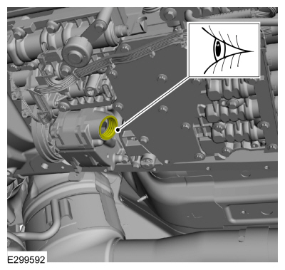

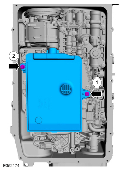

  1. NOTE: The transmission fluid filter may be reused if no excessive contamination is indicated.
    NOTE: Note the location of the bolts for assembly.
    Remove the bolts and the transmission fluid filter.
    1. Short bolt 20 mm
    1. Long bolt 71 mm

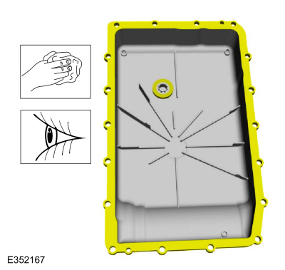

  1. Clean and inspect the transmission fluid pan and magnets.

Installation
  1. NOTE: If the transmission is being repaired for a contamination-related failure, install a new transmission fluid filter and seal assembly. The transmission fluid filter may be reused if no excessive contamination is indicated.
    Inspect the transmission fluid filter seal. If necessary, replace the transmission fluid filter seal.

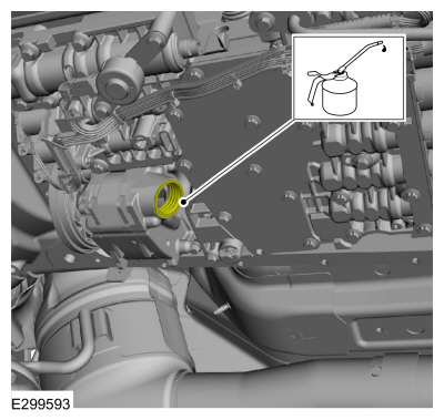

  1. Lubricate the transmission fluid filter seal with automatic transmission fluid.
    Material: Motorcraft® MERCON® ULV Automatic Transmission Fluid / XT-12-QULV (WSS-M2C949-A, )
  1. NOTICE: If the bolts are installed in the wrong locations, transmission damage will occur.
    NOTE:
    Install the filter and the bolts in the correct locations.
    1. Short bolt 20 mm
    1. Long bolt 71 mm
    • Torque: 93 lb.in (10.5 Nm)

  1. NOTE: Install the bolts and studbolts in the correct locations noted during removal.
    Loosely install the remaining bolts and studbolts.
    1. Tighten the studbolts in a crisscross pattern.
      Torque: 106 lb.in (12 Nm)
    1. Tighten the bolts in a crisscross pattern.
      Torque: 89 lb.in (10 Nm)

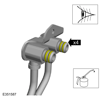

  1. Inspect the transmission fluid heat exchanger O-ring seals and install new O-ring seals if necessary. Lubricate the O-ring seals.
  1. Install the sway bar disconnect and the new nuts and bolts.
    Torque: 66 lb.ft (90 Nm)
  1. Connect the electrical connectors and the wiring harness retainers to the sway bar disconnect.
    NOTE:
    1. Short bolt 20 mm
    1. Long bolt 71 mm
    Align the tabs in the noted location and install the transmission fluid pan gasket.

  1. If equipped, install the RH and LH NVH cover retainers.
  1. If equipped, install the LH and RH heatshields and the retainers.
    Torque: 80 lb.in (9 Nm)
  1. Connect the transmission fluid heat exchanger tubes and install the new bolt.
    Torque: 177 lb.in (20 Nm)
  1. Install the transmission fluid heat exchanger tube bracket bolt.

  1. If equipped, install the skid plate and the bolts.
    Torque: 22 lb.ft (30 Nm)

All vehicles
  1. Fill and check the transmission fluid.
    Refer to: Transmission Fluid Drain and Refill(307-01 Automatic Transmission - 10-Speed Automatic Transmission – 10R60, General Procedures).
  2. If equipped, install the rear skid plate and bolts.
    Torque: 35 lb.ft (48 Nm)
