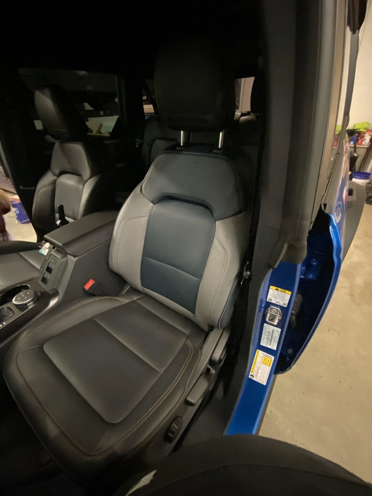

Fantastic list!! I took delivery Saturday AM and wish I had this to go over the truck. I'm going to print this and go over the truck as soon as the Mrs. gets back home. One item I can sadly say is remarkably valid on this list is:
Check seat stitching and ensure seats match
During our pre-purchase test drive, I noticed the driver's seat back did not match the rest of our interior. We have a good relationship with our dealer, so we went ahead and signed the paperwork, laughed at how pathetic the error, and proceeded to enjoy driving it. I'm sure we'll have a list for the dealer to address by the time they get the replacement seat back. Hey, anyone out there with Navy Pier interior rocking a Black Vinyl seat back???
This kind of QC has me rethinking my plan to try a F-150 for the next truck. I had told our dealer I wanted to spec their next Raptor allocation.

This is almost unbelievable. Just when I thought I might be going a little overboard on this checklist....nope. Not at all.
Nope. Not. At. All.
Mistakes happen, I get it. But this one really shocked me, and I don't quite understand how it could make it through. A lot of people had to have seen this and just ignored it along the way.

I visited my dealer GM today and mentioned you and the other OP who had a different back seat. Shook his head in disbelief.
