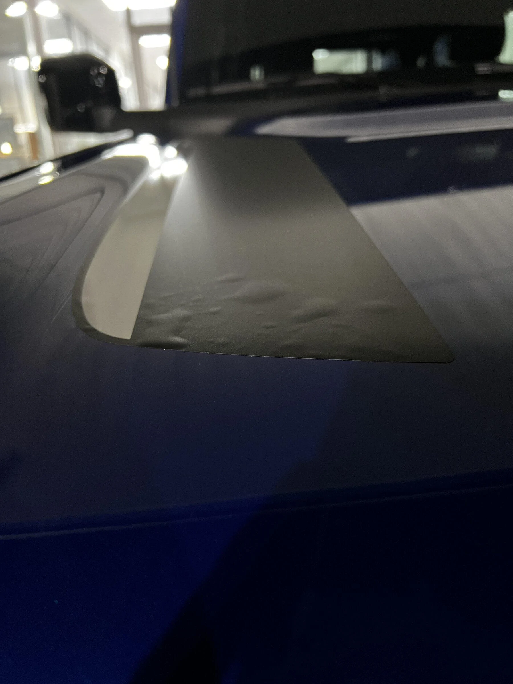

I don't mind at all. I was just dumbfounded that it could escape the plant like that. The picture is a point of record, and I haven't been nasty about this, just factual and honest.

@2ndGenBroncoOwner...well? How did it go today accepting YOUR NEW BRONCO??!! How effective was the OCD (Owners Checklist for Delivery)?
incredibly useful. I am friends with the owner of the dealership, so that helped. I knew about a door ding in the rear passenger side, but everything else went fine. they are ordering a replacement hood graphic from ford for the FE.
