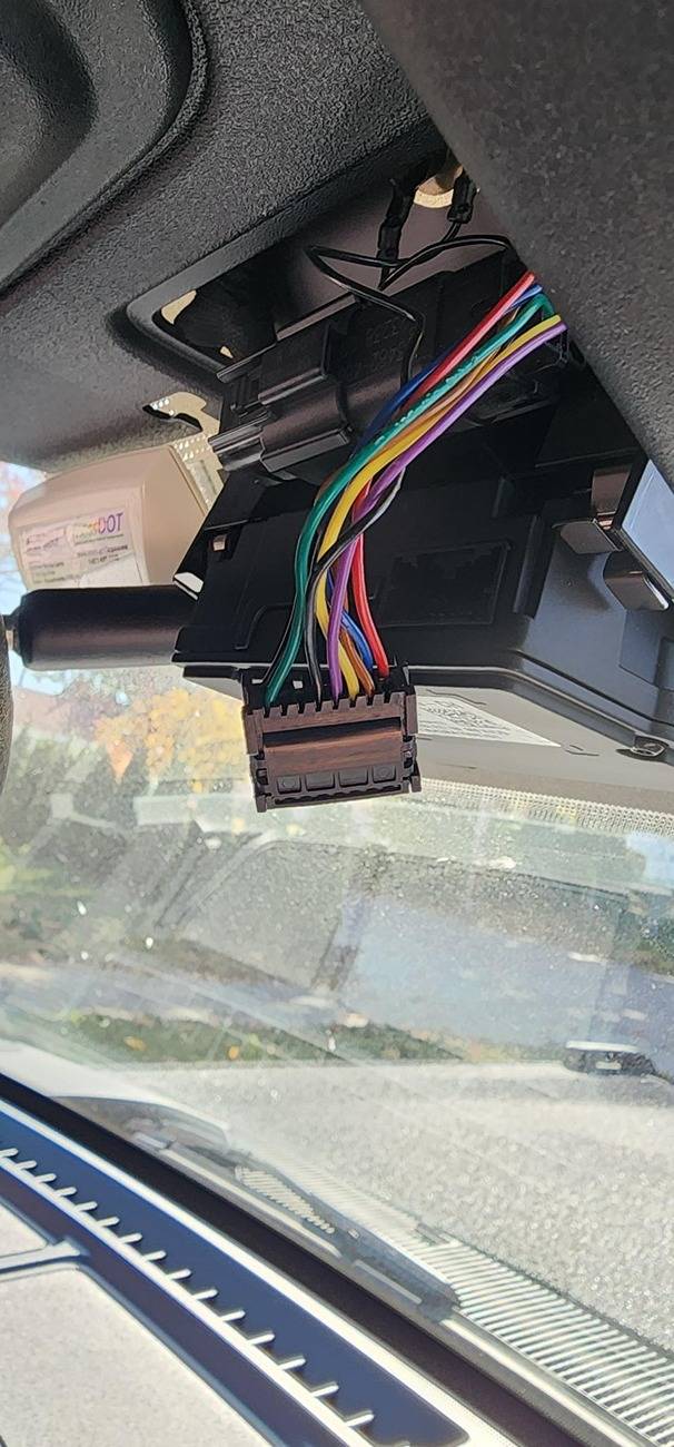

upon opening the black box, there is this wire harness that goes into the pre-collision camera. Is there any kind soul that has a wiring diagram for this harness? it's a 2024 big bend. i have come across 2 manuals now with no diagram for this harness. if nobody has the wiring diagram, can you point me to to a place to buy a service manual that contains this information? thanksss

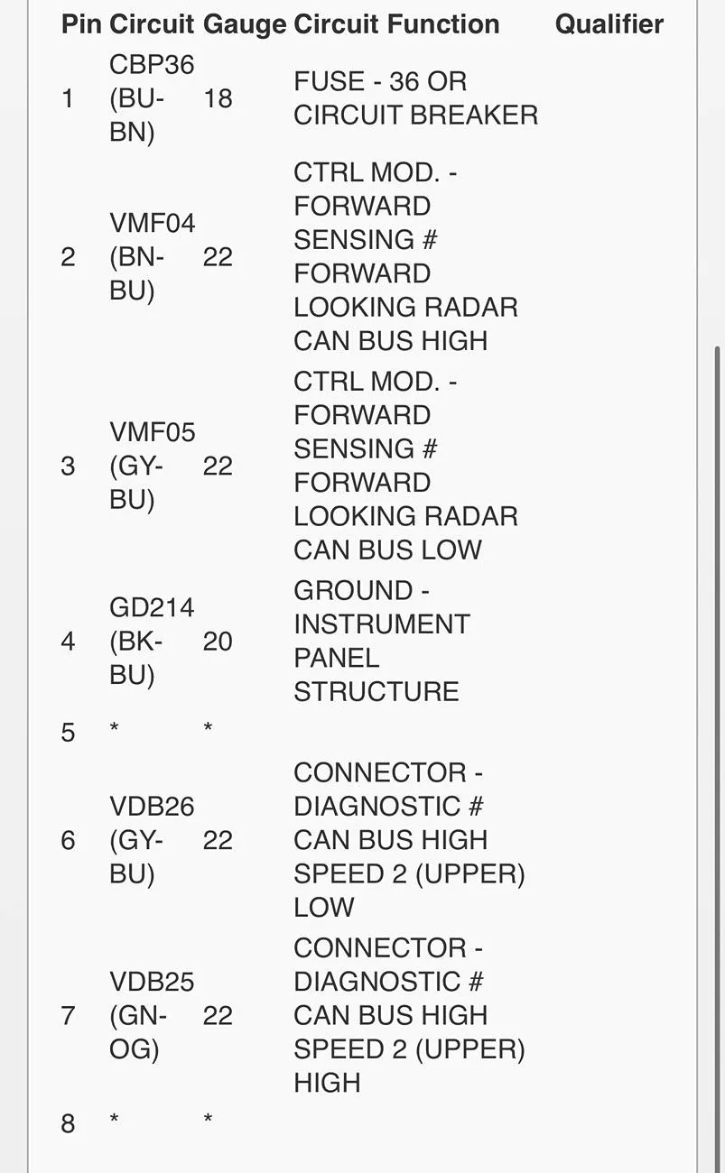

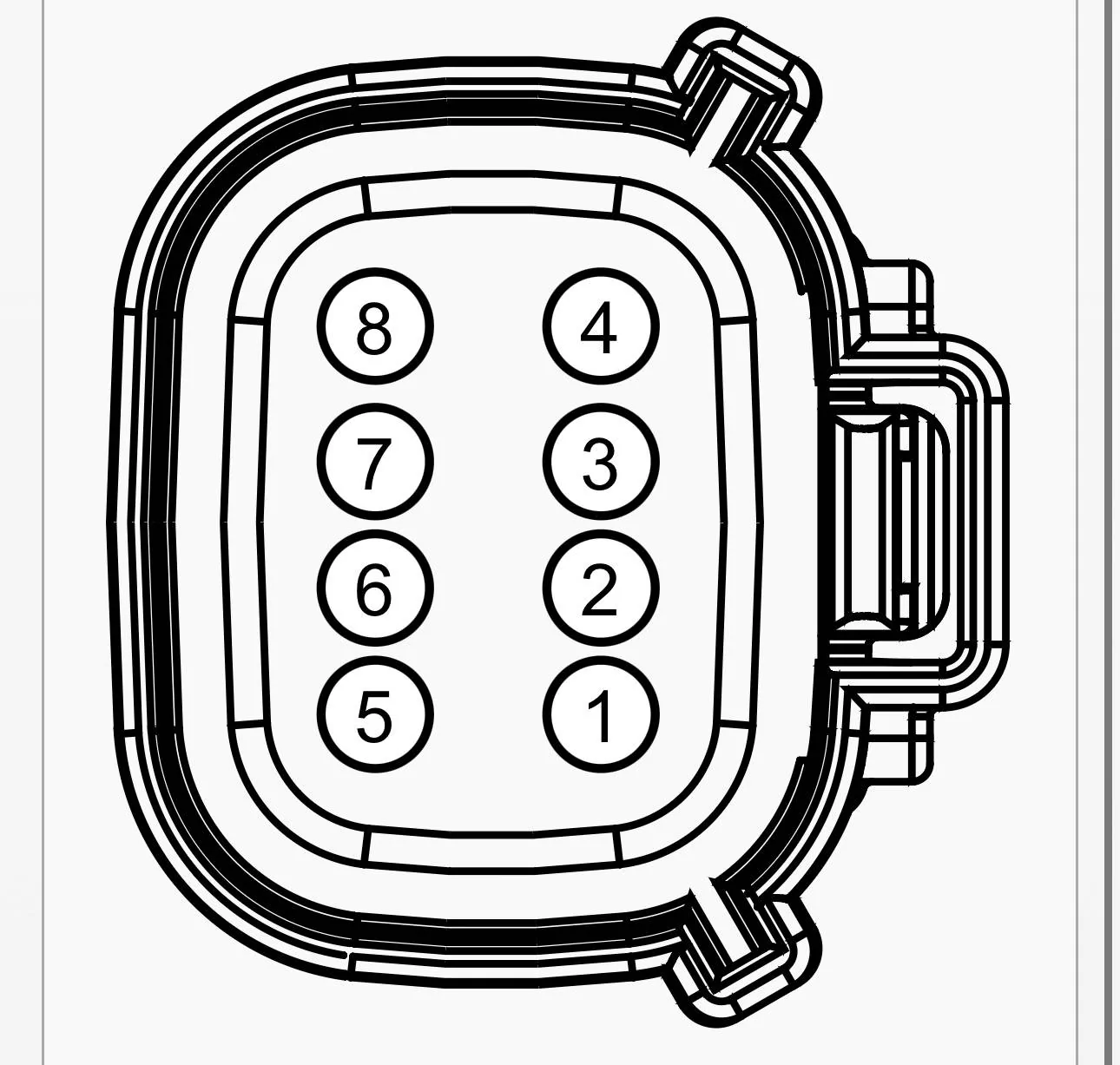

so to clarify, i already bought the fitcamx camera, which you can see below. It looks completely built in, which I enjoy. However, it comes with a harness to plug into the auto-dimming mirror. i have no auto-dimming mirror but there is a bunch of wiring inside the black box for the front collision camera.
That connector won’t be in any wiring diagram, because it comes with the camera.
This should be the diagram for the other inline connector right above it.
