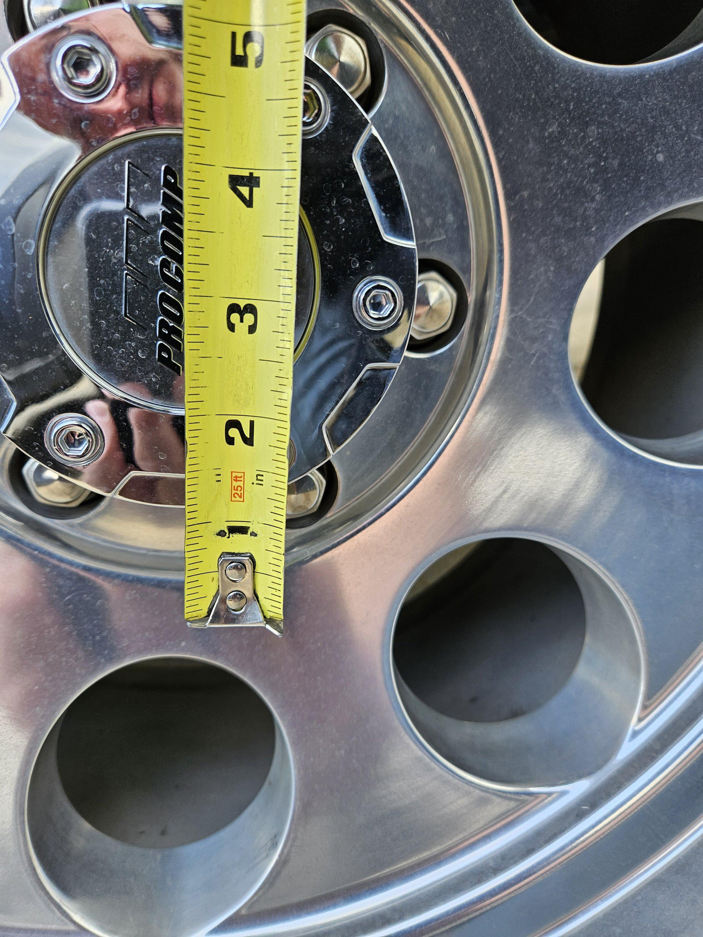

Hello everyone I am new to the Bronco6G. I'm glad to be a part of it. My wife and I have a 2022 Ford Bronco Big Bend 2dr. We are wanting to purchase Pro Comp 1069 17x9 wheels. Does anyone know the diameter of the inner circle that contains the Pro Comp logo? We are eventually wanting to purchase Ford Bronco overlays..... Any help would be greatly appreciated.

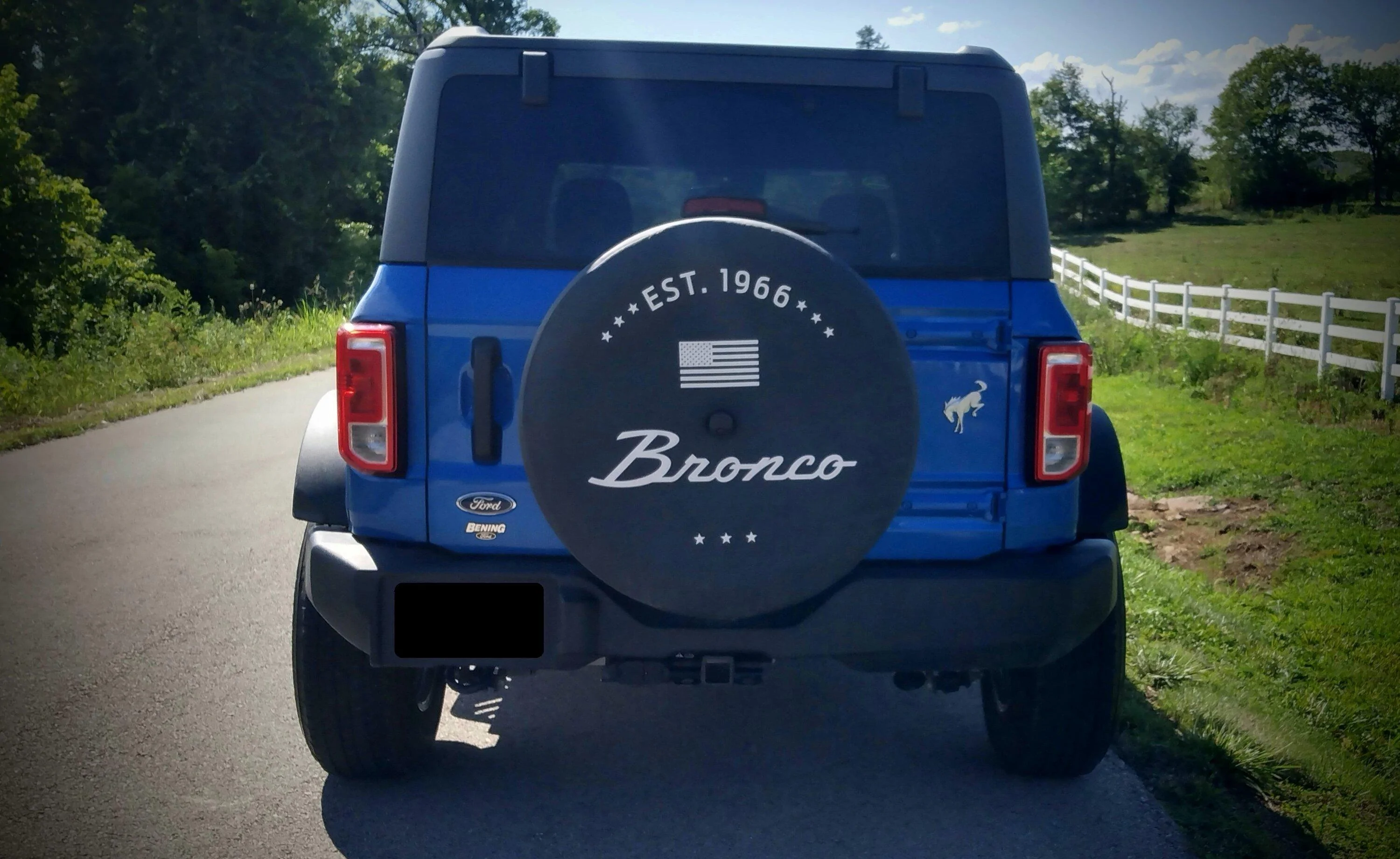

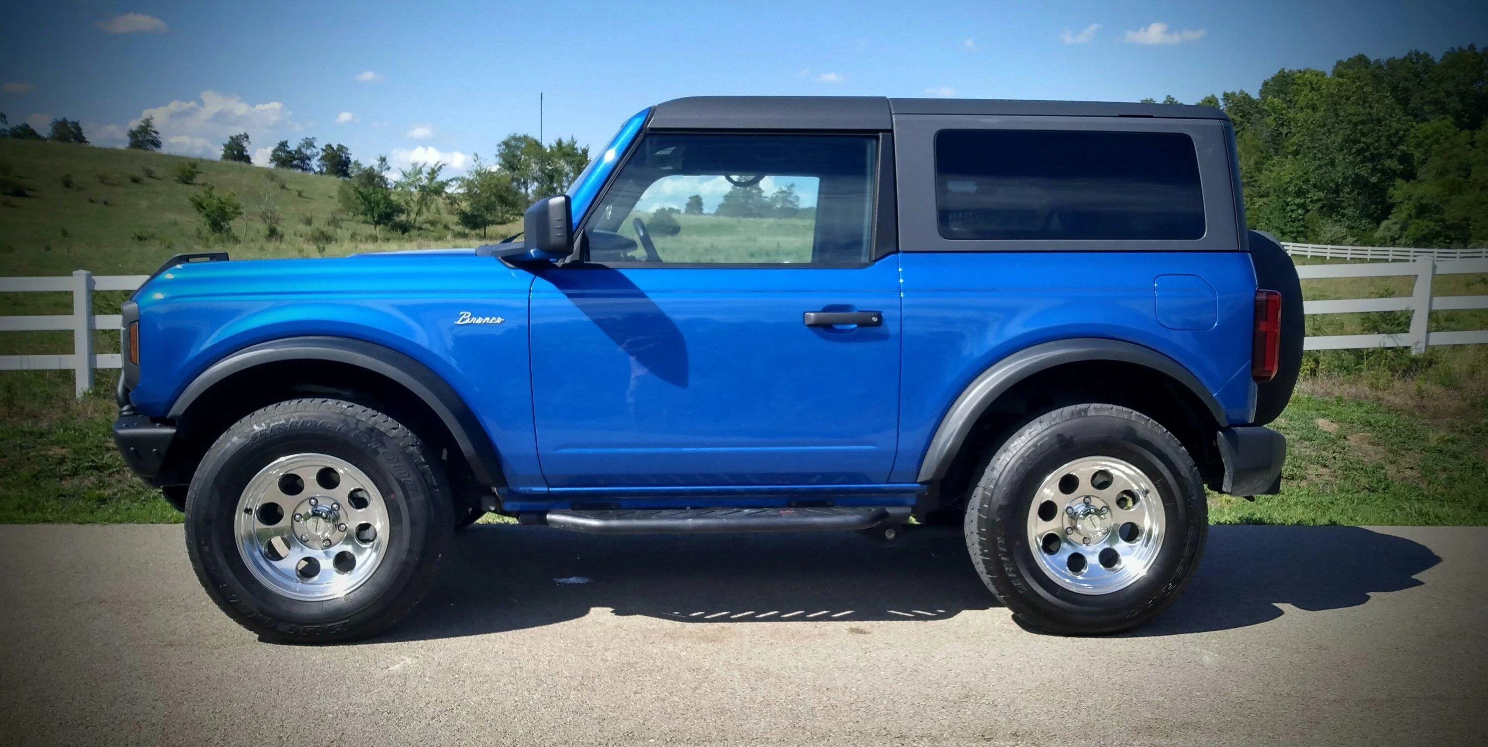

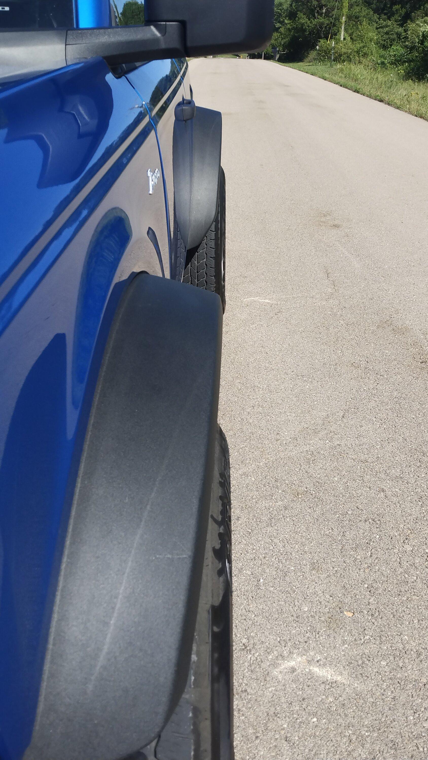

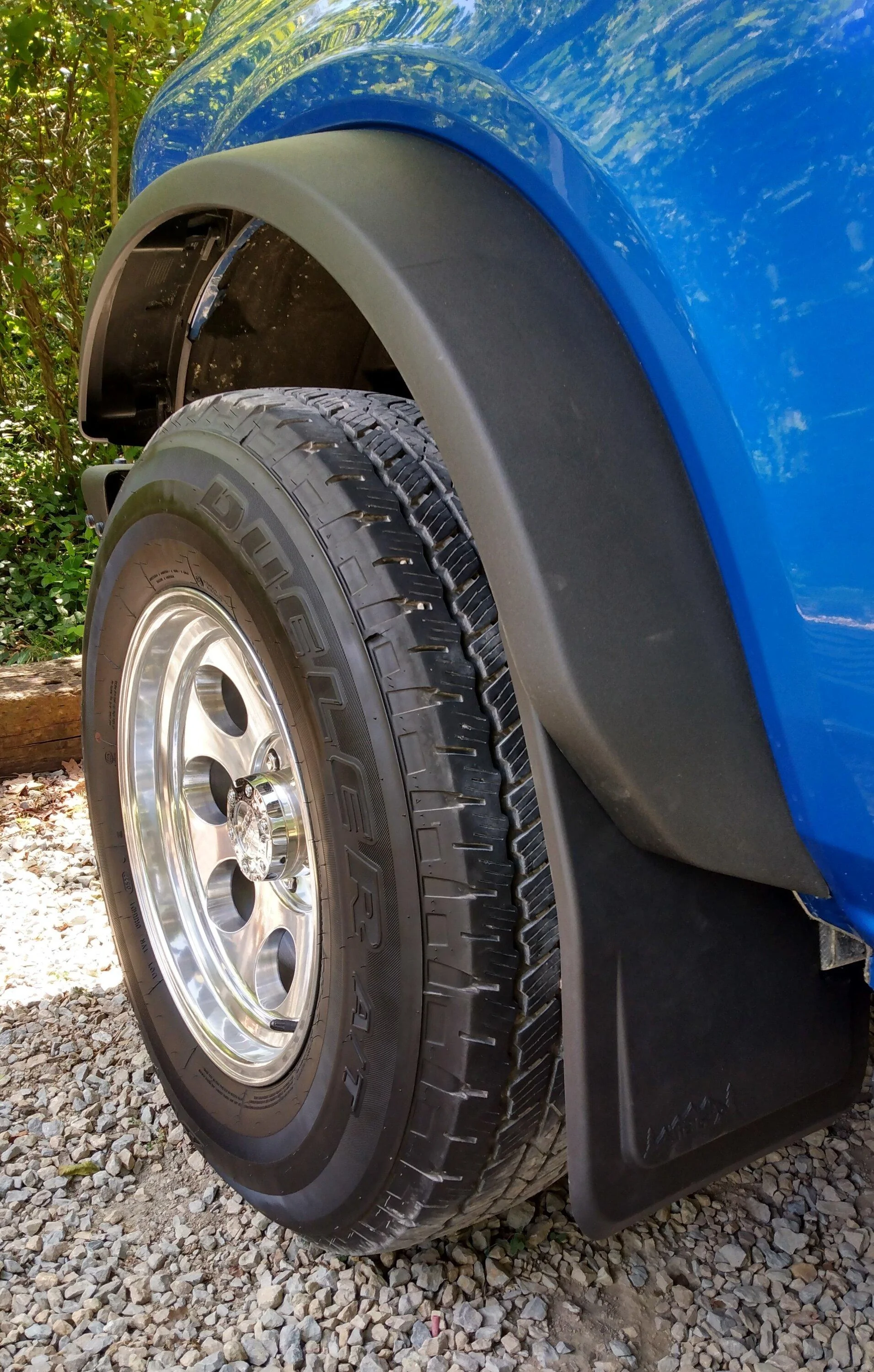

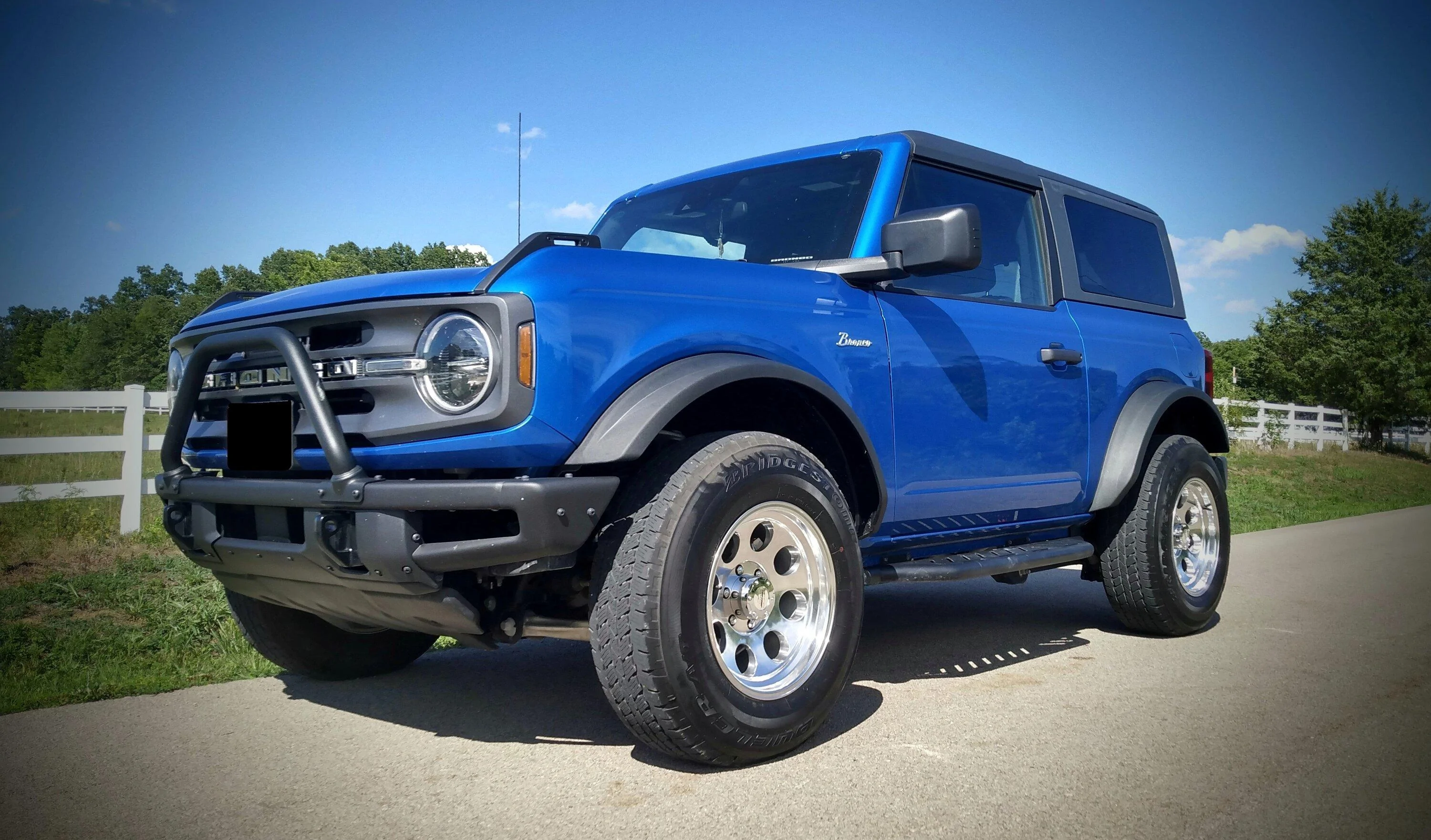

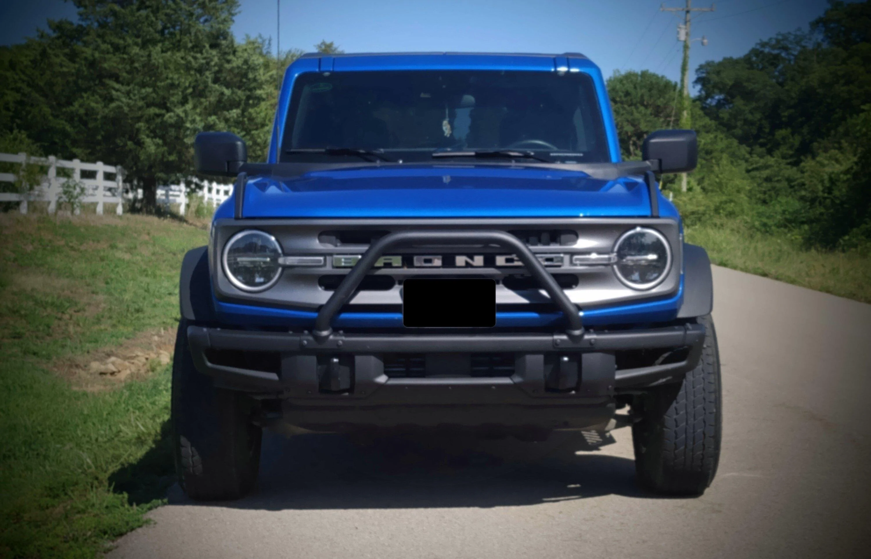

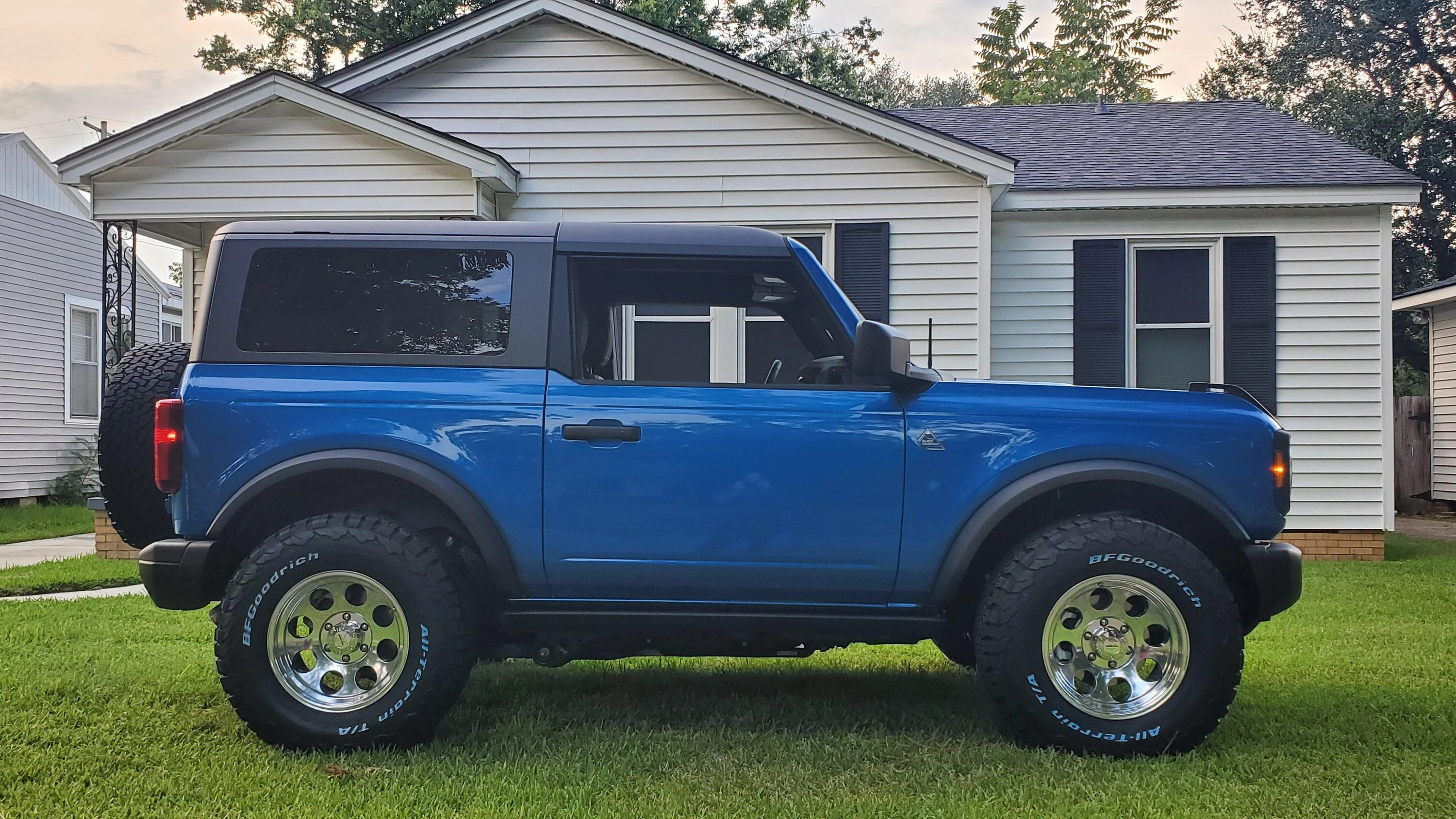

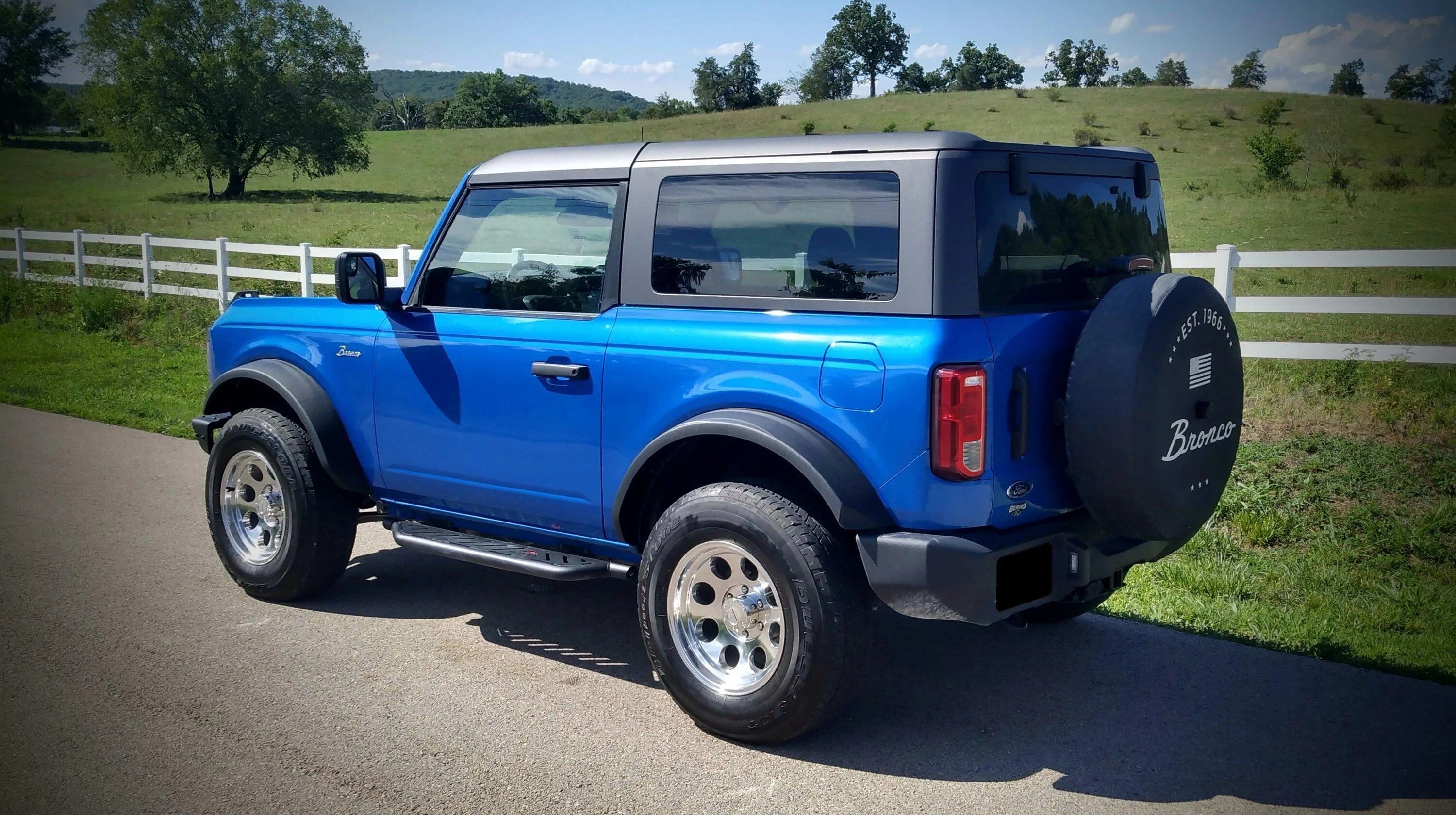

Well my wife and I have been wanting to purchase new wheels for our 2022 Big Bend for a while. Before that happened, we replaced our fender flares with Sasquatch flares. We pulled the trigger last Friday and purchased a set of Pro Comp 1069, 17 x 9, with -6 mm offset. They were mounted on the original 255/75/17 Bridgestone Dueler A/Ts. I did do my research and the 9" wheel with is right at the limit on these tires. Even with Sasquatch flares, we have around 7/16" of sidewall poke (originally figured 3/16", but the backspacing is 4.75" not 4.5"); we could live with it as the tread is still roughly 1-1/2" inside. Also, we installed IAG Sasquatch specific mud guards as well; they were installed as shown in the last picture. I must say it looks much better and the 5" overall track width greatly improved the stability, handling, and ride! If you like the old school classic look, I'd highly recommend it! We looove it!

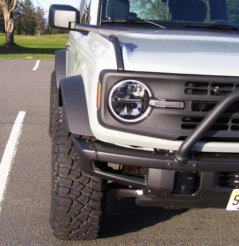

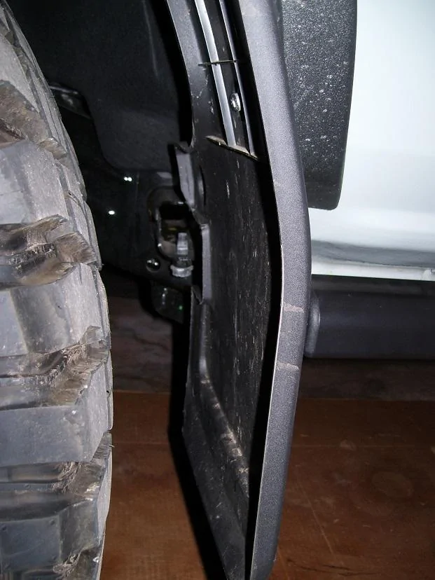

If you go with wider/taller tires in the future, you will most likely need to trim the mud flaps. I had to take a bit off the inside edge with the 35x12.5x17 tires but mine is a base Sas so it already has some lift. I ended up taking even more off the flap than what shows in the 2nd pic.
