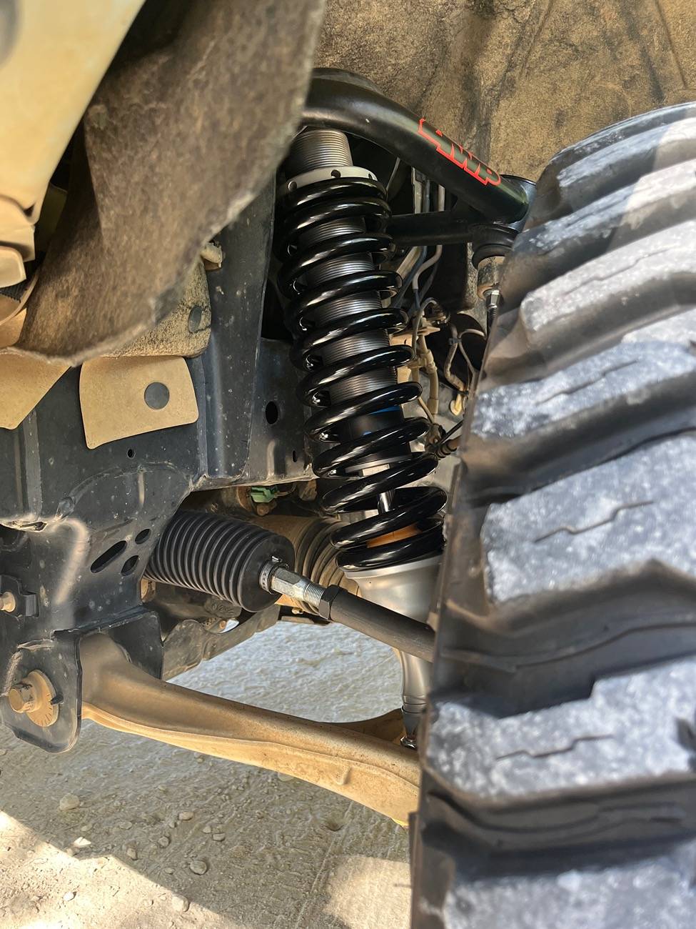

Just installed both front and back with the Broken Innovations diff drop ( couldn’t have done it without @GI_Jo_Nathan ). I haven’t been on a trail yet but around town it is better than OEM.
I think people are sleeping on this shock package. They are 2.5 diameter and adjustable without having to take the shock off the truck .

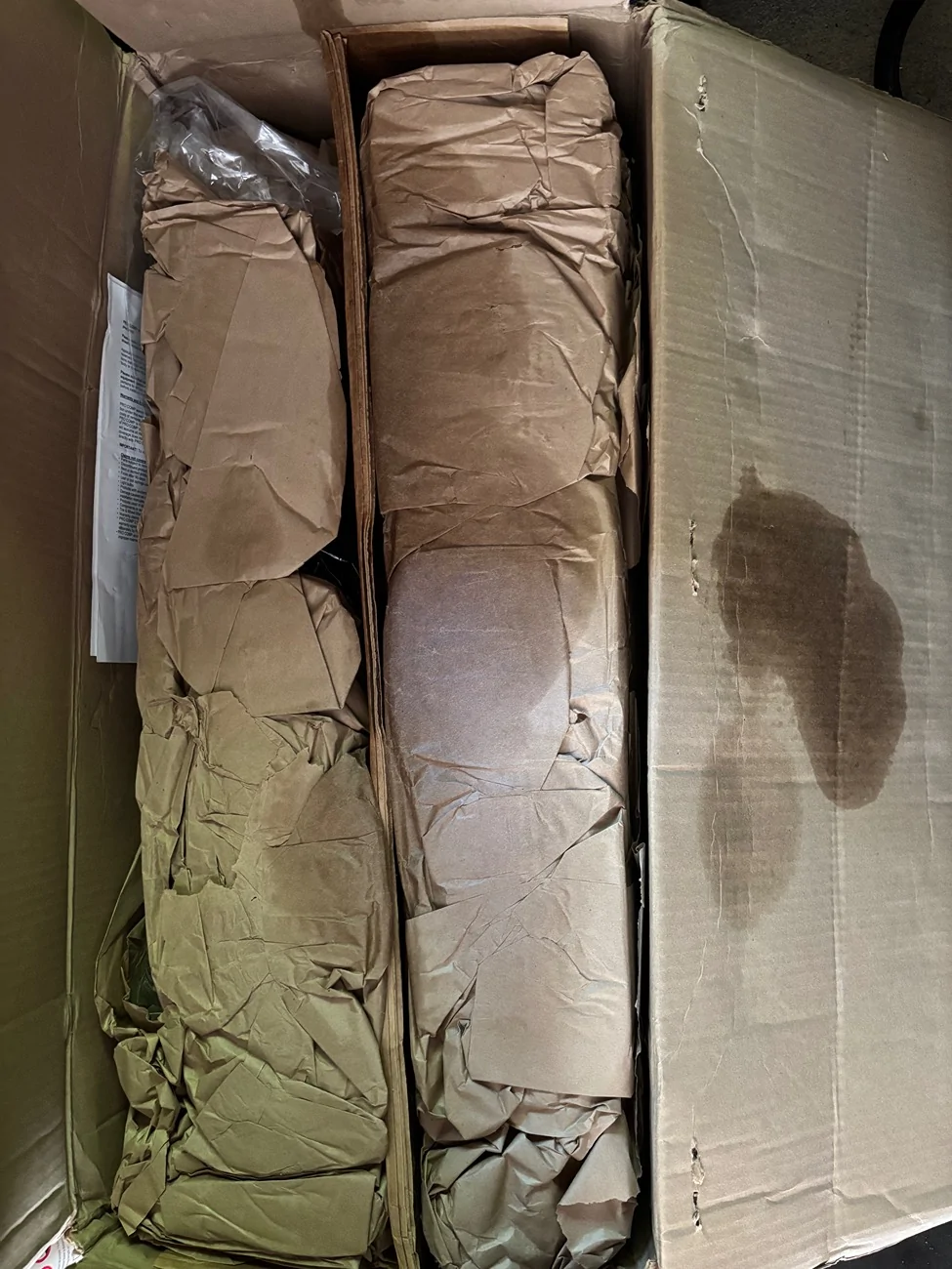

Alright, I pulled the trigger on a set before parts become unavailable again. FedEx did me dirty and destroyed the fronts. Luckily they sent a replacement pair within days instead of a month backorder as they claim.
Covered in oil and top hat is all jacked up. I didn’t take that close of a look to see the extent of the damage - but, the damper itself is shot I assume? Seems like they just want me to discard them. I’ll be sure to salvage what I can for backup parts.
I would think the entire unit could be repaired. It's probably just some of the seals that gave out. These are rebuildable shocks after all.
Iirc the top hat is not installed to be a flat surface.
There are photos in one of my threads.

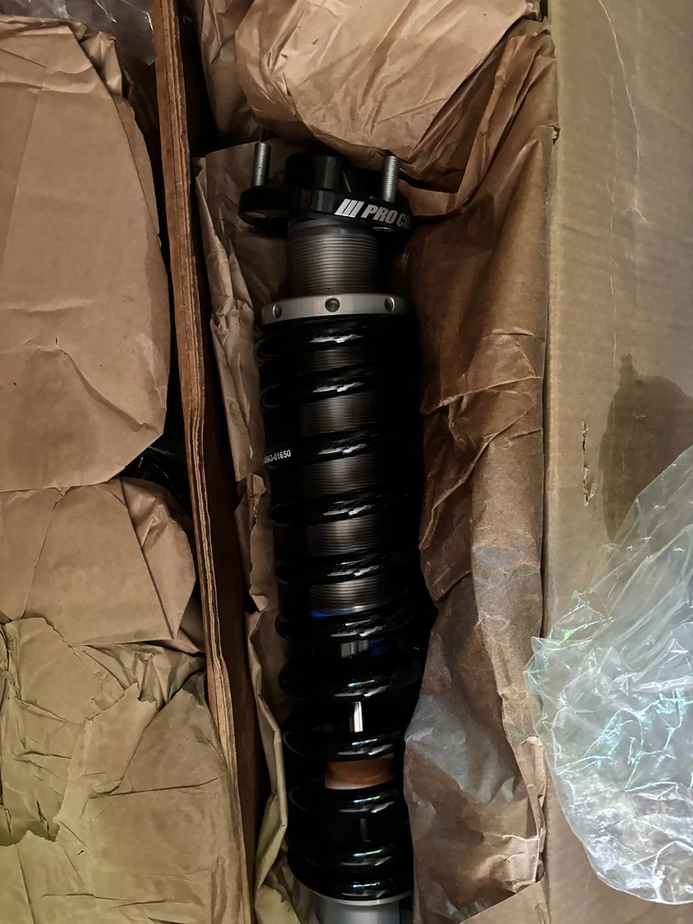

That makes sense. I have to hold onto them for 30 days to see if they want them back. I figured the top hat was the least of my concerns.

Ah, yes. Upon closer inspection - the top hat is on a pivot/shaft. That’s a nice feature. I don’t remember seeing that on other brands.
I can’t wait to get these things mounted.
