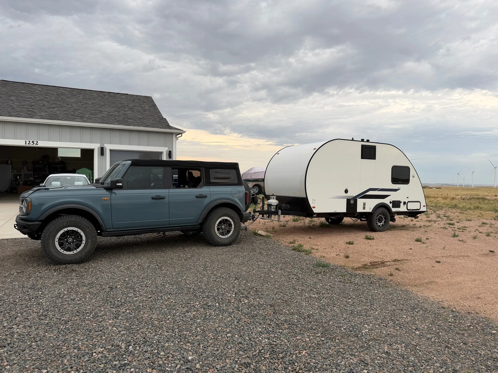

Absolutely would do it again. Bone stock 2.3, I will ad an upgraded intercooler with up and down/ charge pipes. I think it heat soaks quick when pulling large hills in Wyoming. Boost will hold at 20-21 psi for 5-15 seconds with 91-93 octane but then de-rates to 14-15 for the rest of the hill. It never got hotter than 235° and that was 70 mph and 100° outside temp. If I could just get it to breath better and dissipate heat faster, it may hold boost better. I averaged right at 10 mpg at 65-70 mph.

Towing with that much boost is a bad plan if you want to keep the engine around long term. Slow down! It's not a race. Towing is much safer under 60mph and better mpg. Hills at 45-50mph won't extend your drive as you'll bypass gas stations and much less strain on the motor. I like to keep sustained boost well under 10psi. I don't like being over 5psi for any length of time.
Intercooler won't fix your problem. We have an upgraded intercooler on our Raptor. Huge waste of money. It heat soaks no different that stock with a slight delay but then takes much longer to cool back off. Maybe this is a good solution for 10 second drag race but worthless for towing or sustained loads.
This is a tiny motor that is high strung. The max power / torque is not designed to be utilized 100% of the time (if you want longevity).

I will get an intercooler. And water injection at some point. The intercooler with better charge pipes will definitely reduce charge air temps. It doesn’t even need a tune really. Nothing wrong with 65-70 other than fuel mileage.

Towing isn't about raw horsepower or torque. Gearing, brakes and chassis play an even more important role and when you crawl under the Bronco, you'll see it's not meant to be a tow at it's limits.
I tow a 5x10 utility trailer pretty regularly over a few mountain passes with my measly 2.3/7MT. Keep speeds reasonable and stay out of the way of the swingin-dick one-ton diesel bros hauling 40' fifth wheels at 85mph up the mountains and you'll do fine.
@Original Bender does your trailer have brakes? Most under 3500lbs don't come with trailer brakes. I decided to add some to my utility trailer and it helps offload a lot of the braking from the Bronco. I'd recommend it, even if your state doesn't legally require it.
Frontal area of the trailer is important to keep in mind as well. It seems that teardrop probably moves some decent air over it, even though it's taller than the Bronco.
