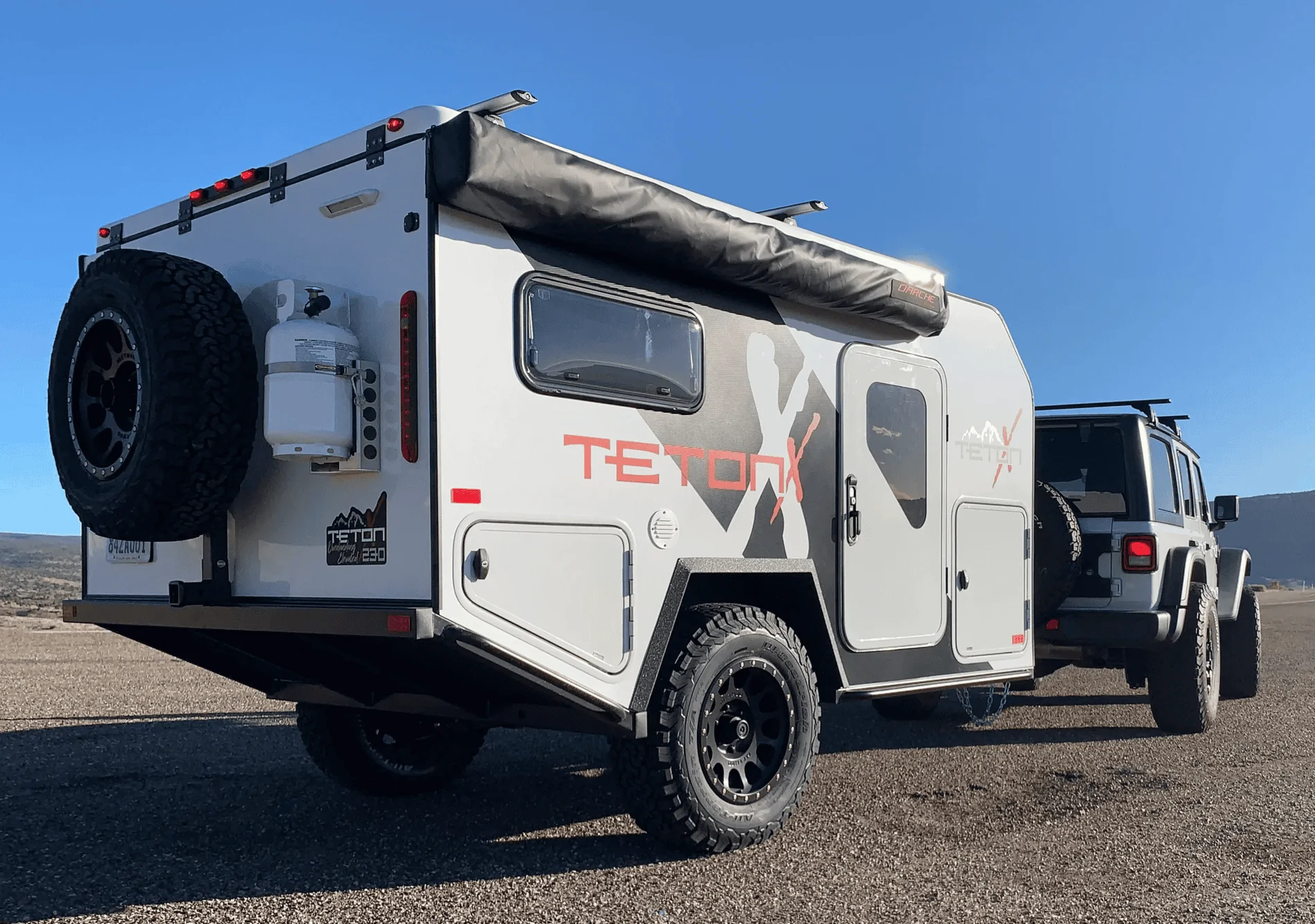

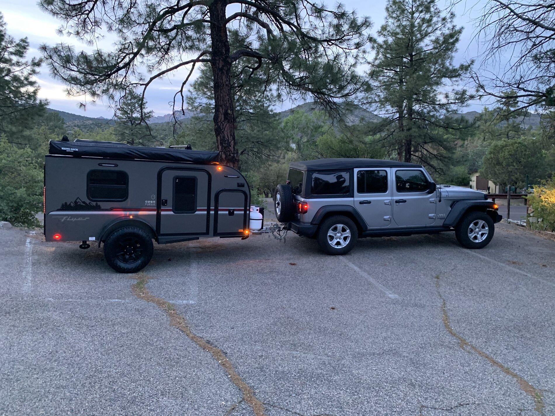

Mine doesn't pop-up like the Teton X hybrid, but is about the same (unpopped) dimensions and a bit lighter. I've towed it and an Aliner behind my Jeep and both are easy except in high wind (Jeeps and I assume Bronco due to shared boxlike shape are painful in wind regardless of whether they are pulling something).
My JLU is an auto, but I used to tow with a manual (Xterra and Chevy 1500 back when a manual was a choice in those) and the extra control is good and you don't need a fancy 'tow mode' to prevent it from shifting around too much at high speeds or hills. Major downside is the shifting dynamics if you need to do stop-n-go driving on a steep incline with a few thousand pounds behind you is not fun for you or the health of your clutch.
