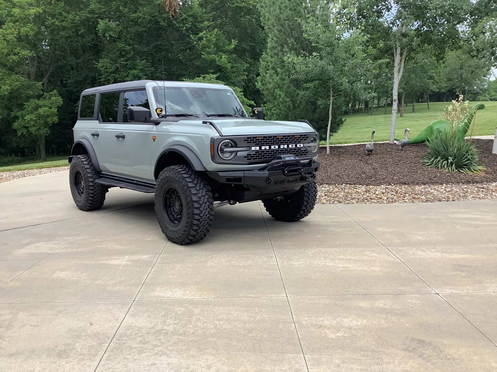

3" body lift, modified the bumpers, the 37 skinnies fit fine the 37 wides rub at lock.

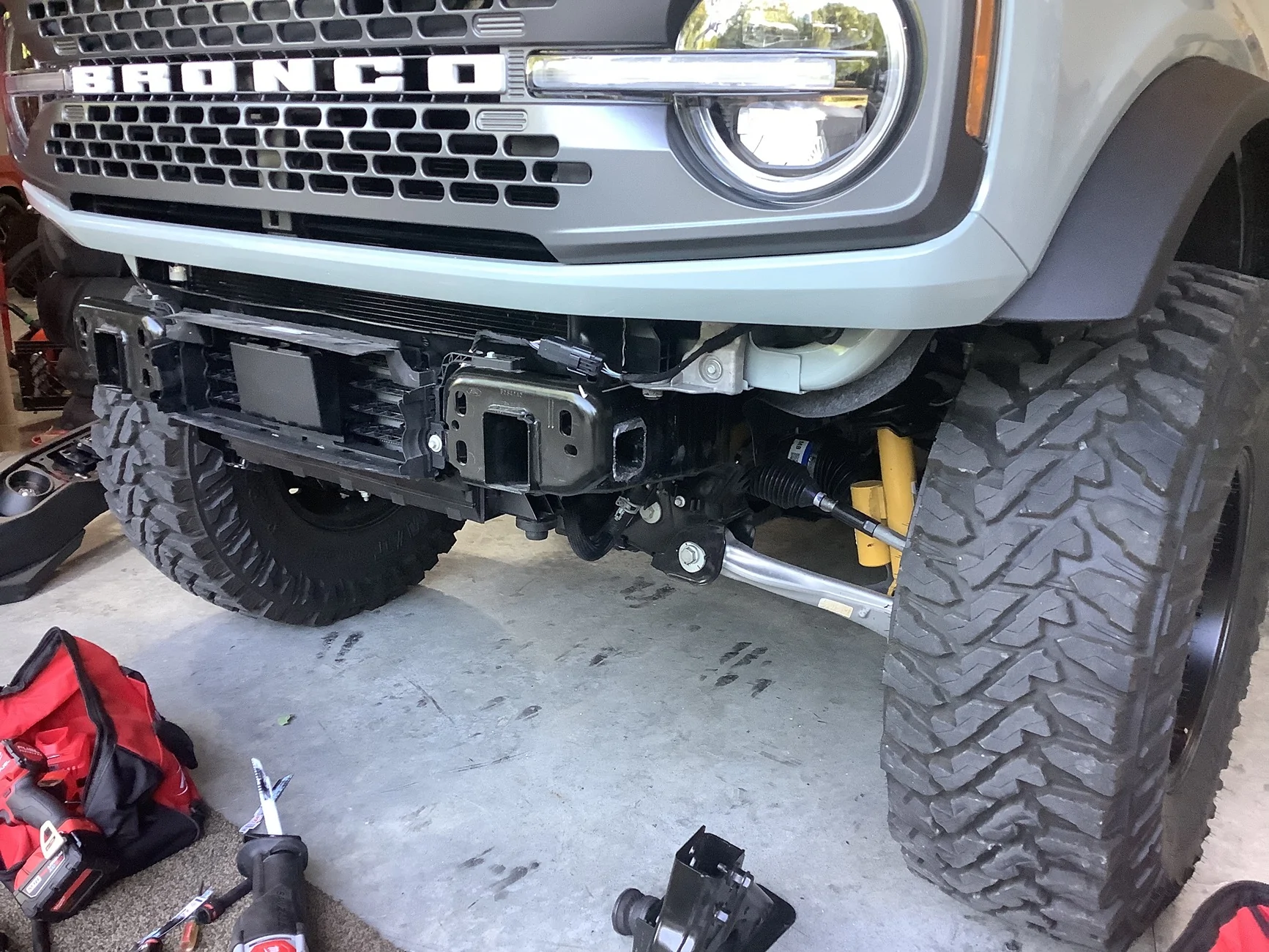

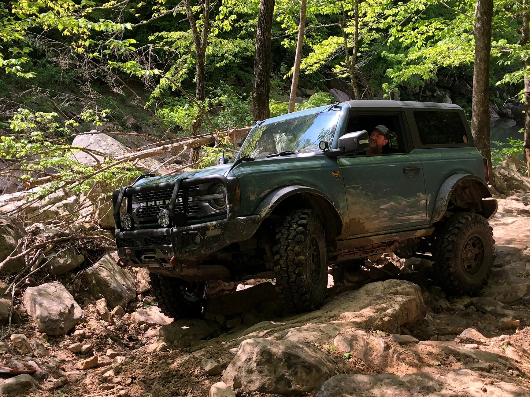

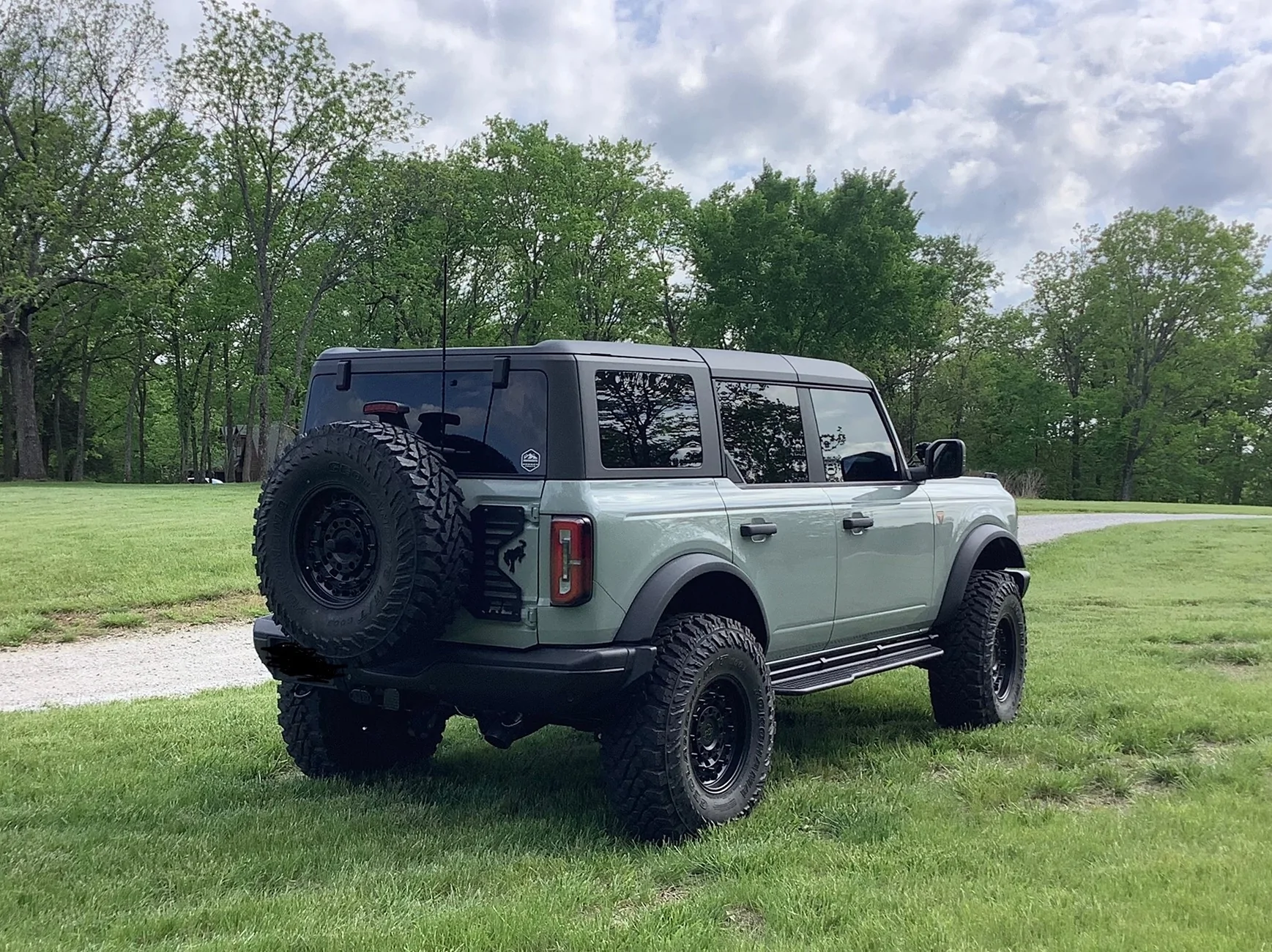

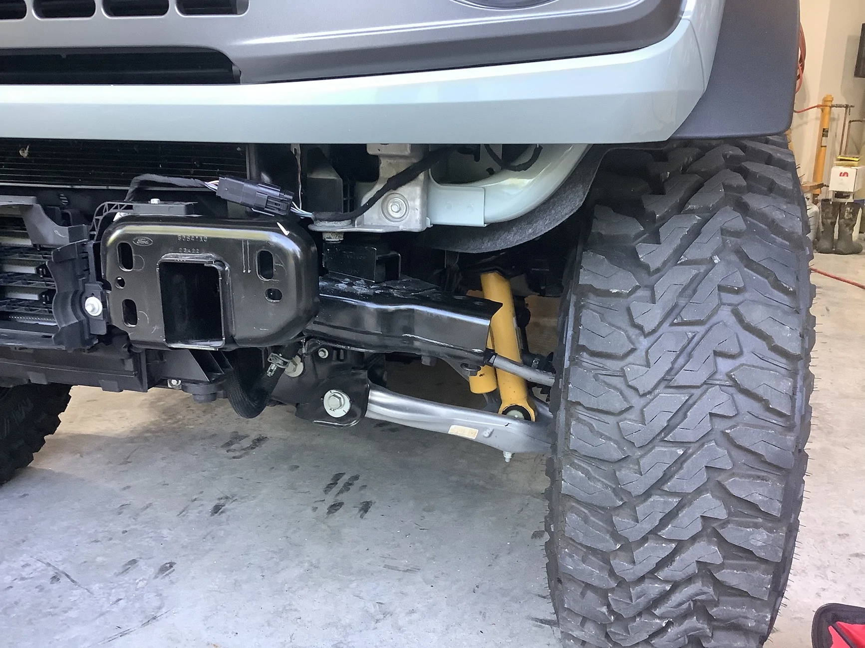

Are used Ready lift, 3 inch lift and JKS crash bar delete. Black rhino wheels 37 inch M/T Yokohama tires.

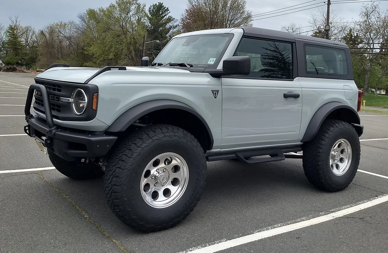

I went with the ProComp adjustable coilovers so around 2" over Sas up front and 1" over Sas in the rear. Stock UCA's and I already had the ProComp 17x9 -6 offset wheels. You'll want the rear trackbar relocation bracket but your biggest issue will be keeping the stock Sas wheels. If you go with a 0 to -6 offset you won't rub and the aftermarket wheels will be around 10 lbs lighter than stock so that will help offset the extra weight of the 37's.
