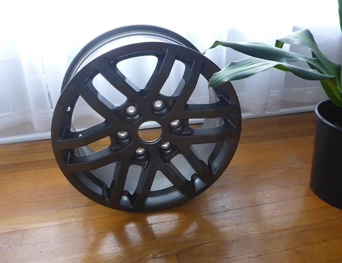

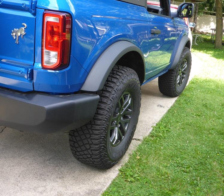

I am doing the Ranger Raptor wheels with 33” KO2 tires on my base. I am adding black Gorilla locking lugs.

Do you have a picture we can see full size of the bronco on the ranger raptor wheels?

Looks outstanding, absolutely loving those wheels. (y)

Looking for one more of the 17X8 +42 offset version for my spare
installed and love them

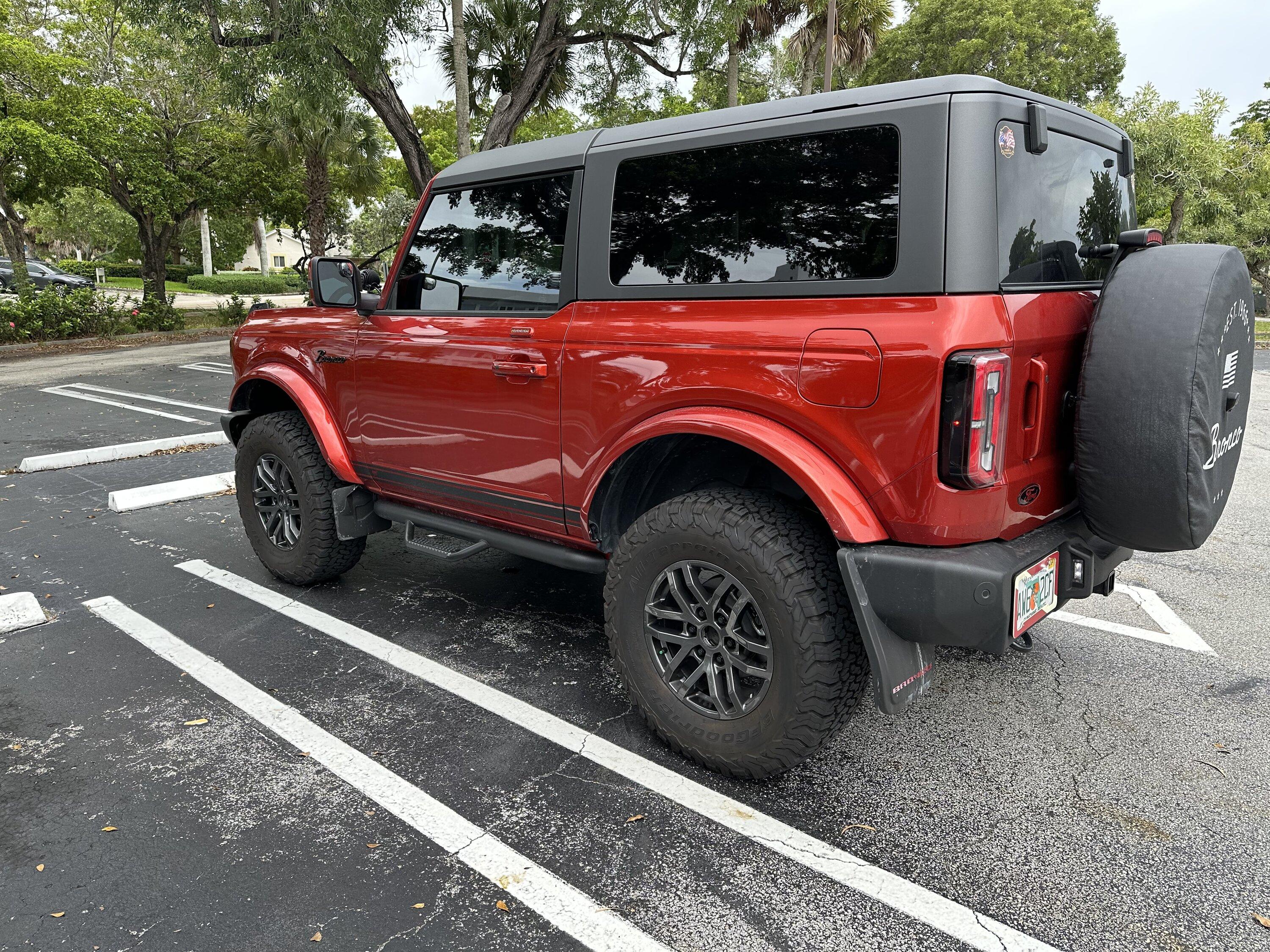

Also loving these wheels. Got a deal on used nice shape along with some 35" Bronco take-offs hardly ran. The somewhat unique +42 offset I think gives them a good fit with stock flares.

And managed to snag a mythical single 5th wheel recently as a spare, currently sitting in our living room, lol.
The offset is great. Nice snag on the wheel. I’m looking.
