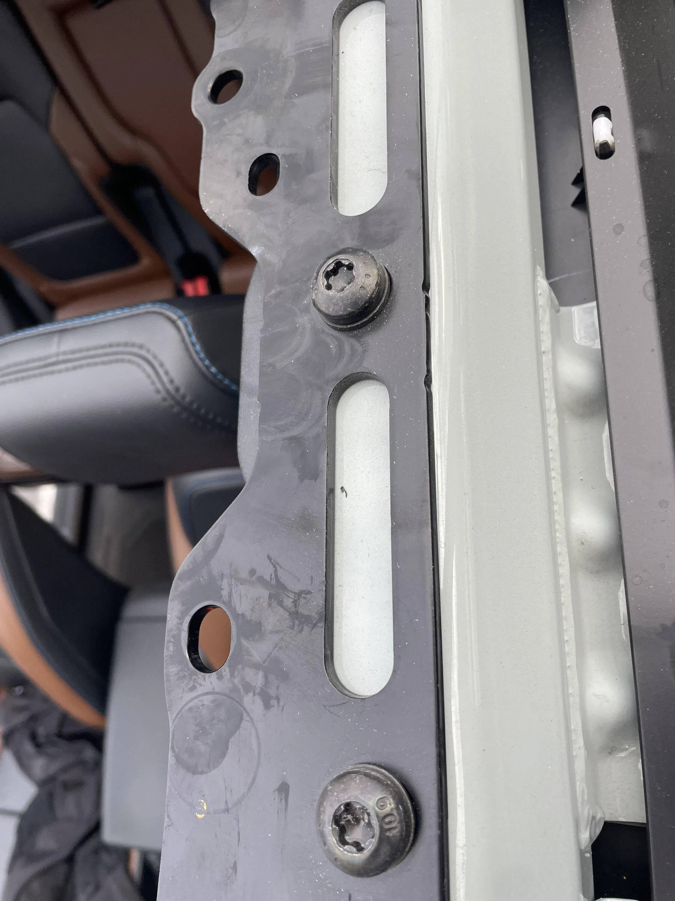

Hello I have been dealing with this extremely annoying sound and I think I found a solution after SO many things that I tried.
I am actually glad that Ford has replied to this thread so maybe this post could help to develop a solution or TSB
Mine was on the drivers side and at the beginning I thought it was the airbag because I read this other thread
https://www.bronco6g.com/forum/thre...s-on-the-a-pillar-and-a-few-other-bugs.29039/
And that is why in the video the airbag covers were off, but it is not, the culprit is the metal plates where the hard top connects to.
Somehow if they are too tight the noise eventually develops, maybe because of the flexing of the body etc.
As I said I hunted this sound for literally weeks and and the solution was to loosen up the torx screws that hold the metal plates, and literally just tighten them BY HAND and then just add just a tiny bit of extra tightness with the ratchet, but no more than an inch of movement of the ratchet. That will secure the metal plates without that extra tightness that would make the rattling noise come back.
I will repost this same explanation as a brand new thread because it is not the dash but the top.
I hope this info helps and Ford eventually install some sound deadening tape or something to make a permanent solution.
Here is the video and a picture of the plates that make the sound of they are too tight.
