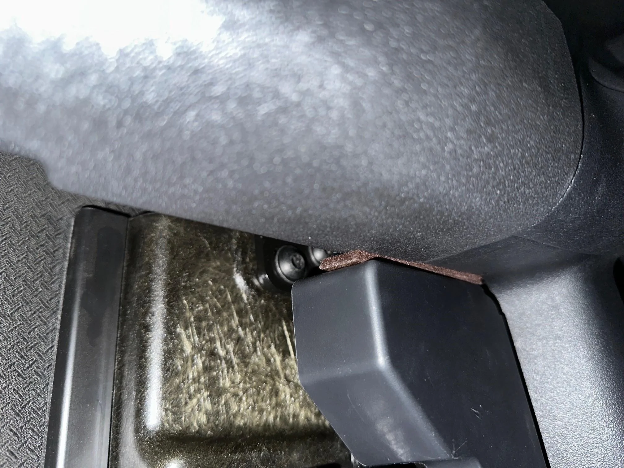

I believe I found the issue at least for me, I put a piece of Velcro tape on outside of plastic piece covering the lock in henge, see pic
Ford Bronco Rattle-clicking passenger side soft top pic

I found this on mine, it may be your problem as well.
I noticed this in mine too. Only on the right side. The left doesn’t do it. I’ve been trying to find the cause of that clicking noise and it’s been driving me crazy! Where you able to fix it? If so, how?
