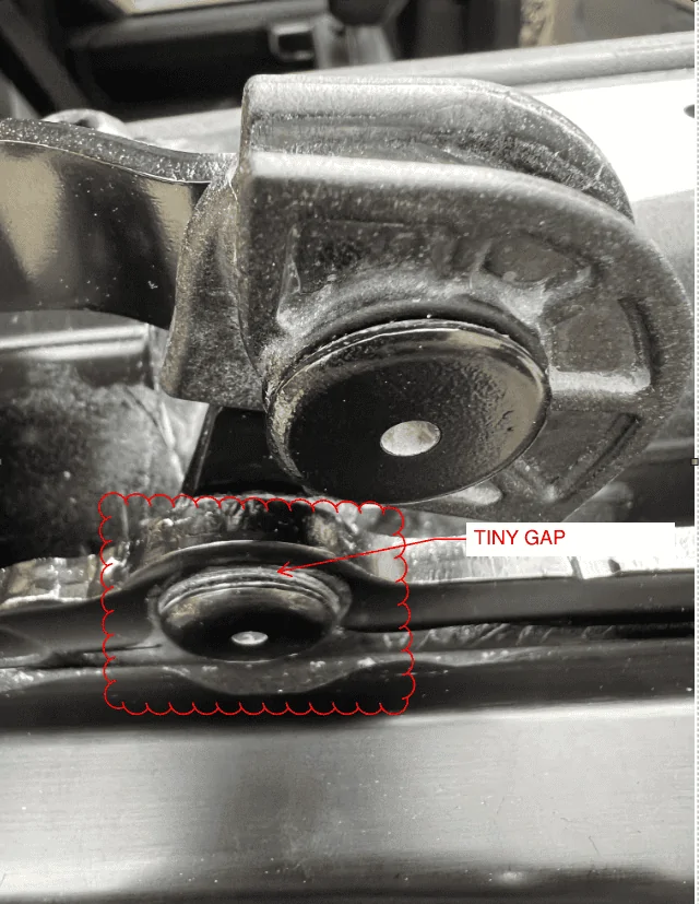

I have a soft top that has been rattling for a long time. I finally tracked down the culprit. One of the hinges is loose. See photo below. There is a tiny gap in the hinge and the metal rattles like crazy when driving. What can I put in that gap? Is there a tool that can tighten the rivet connection (without breaking it)? Felt tape is way to thick fit in the gap. I tried some white teflon spray that didn't do anything to help. Any words of wisdom are greatly appreciated!

Lube usually helps but you already tried that- maybe try more lube? Is it a fold point where it pivots? If not you could try to squeeze some silicone in there. Or get some very thin steel shim stock and cut a "U" in it instead of a hole and place it in it and try some loctite or super glue to hold it in place. If it is a pivoting joint you could just drill out the rivet and replace it with a bolt and locking nut. Some ideas anyway.....

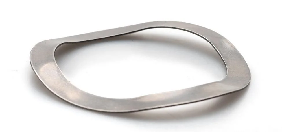

I'd probably get a wave washer of the appropriate size and make a single cut in one side so I could slip it over the rivet.

Or, using a C-Clamp as a crimping device, close the gap.

I should clarify that it is a pivoting joint. i could shim it with something like paper or plastic, but will have to redo after folding the top. I may try some thicker grease or see if I can clamp it harder without breaking it.
Thanks for all of the suggestions!

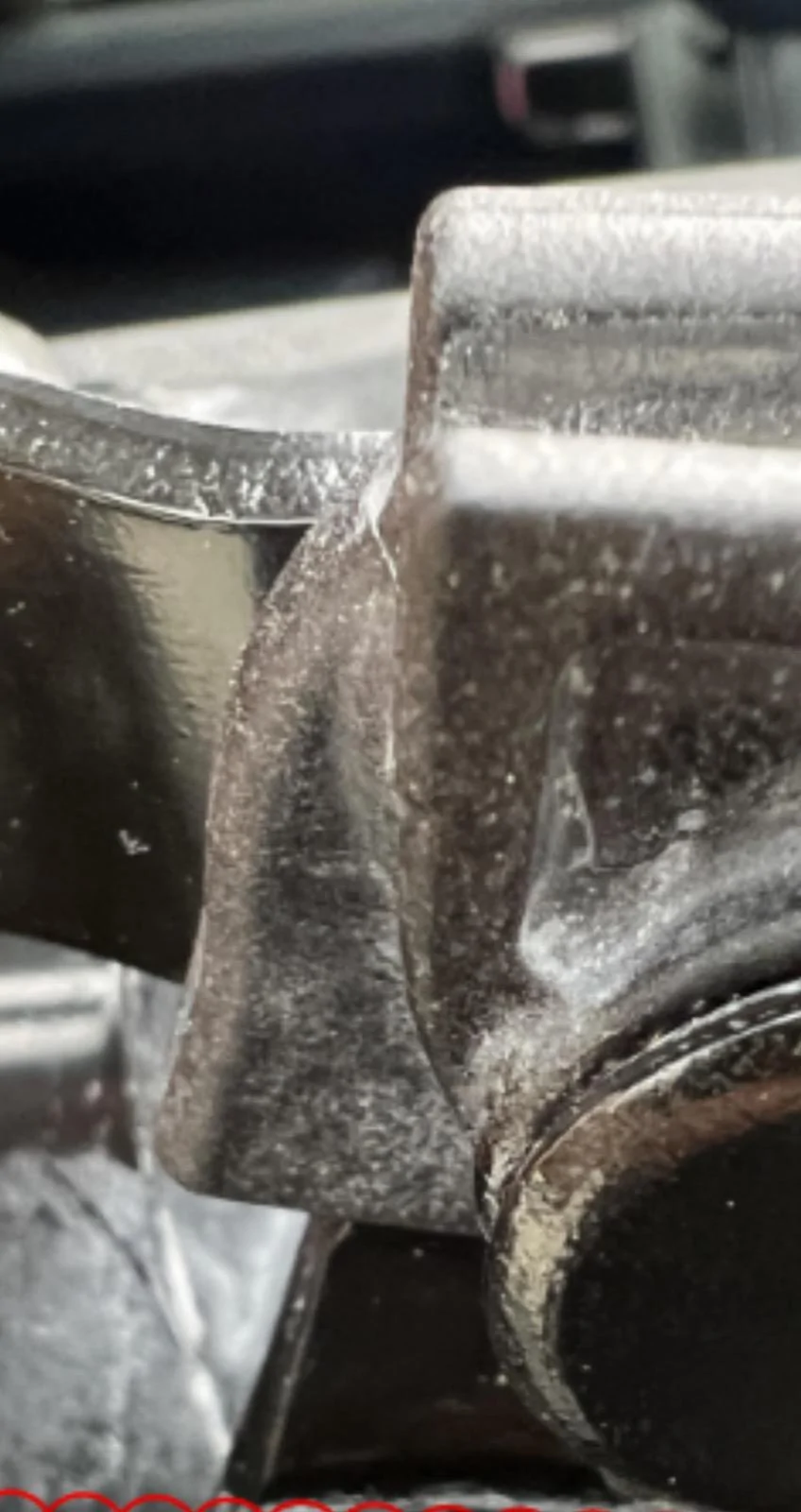

Is this not a crack?

As far as closing up that gap at the hinge. Can you use a hammer with a dolly behind it and tighten that joint?
Ford Bronco Rattle Found! Need Help with a fix. IMG_0208
No it's part of that plastic saddle. It looks like a crack in the picture, but it's a solid piece. It's inset right there so it looks like a crack. The gap and rattle is in the joint below it.

Maybe a teflon washer, if not a wave washer like MFP2241 suggested? Slice open an end so you can slip it in.
This is what I would try - hammer the rivet tighter. Can also try packing it with some grease, that may be more of a temporary thing though.
The washer ideas are good too if you can find one thing enough to get in there (before you start hammering on it), or a snap-ring.

Wrap dental floss around it and call it a day
Well that sounds like a smart place to start. I'll give that a shot before hitting with hammer.
