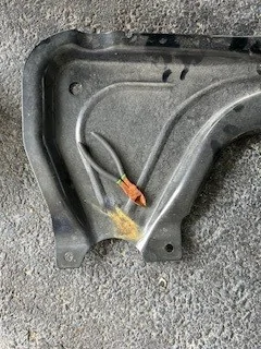

I found this when changing driveline fluids for the first time:
You can see the stain where it came to rest and rusted/rattled...
Hmmm, Ill check that out too
Do you think that was a gift from the factory or something that happened later? In aerospace mechanics are supposed to shadow in their tool boxes and do inventory daily to make sure that doesn't happen. Those little buggers could cause some problems in various spaces on an A/C.
