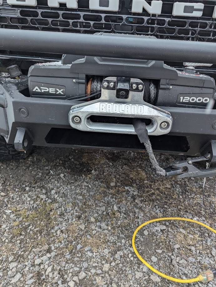

I'll weigh in with my $0.02 here.
I'm running an aftermarket bumper, with the winch mid or high mounted.
I also have the Lux package on a Wildtrak, so camera, sensors, ACC, everthing.
I had to drill holes for my sensors & used the Lobo Offroad mounts for the sensors - $10/pc for 4 parts isn't bad, but they charged me $30 in shipping. Yikes.

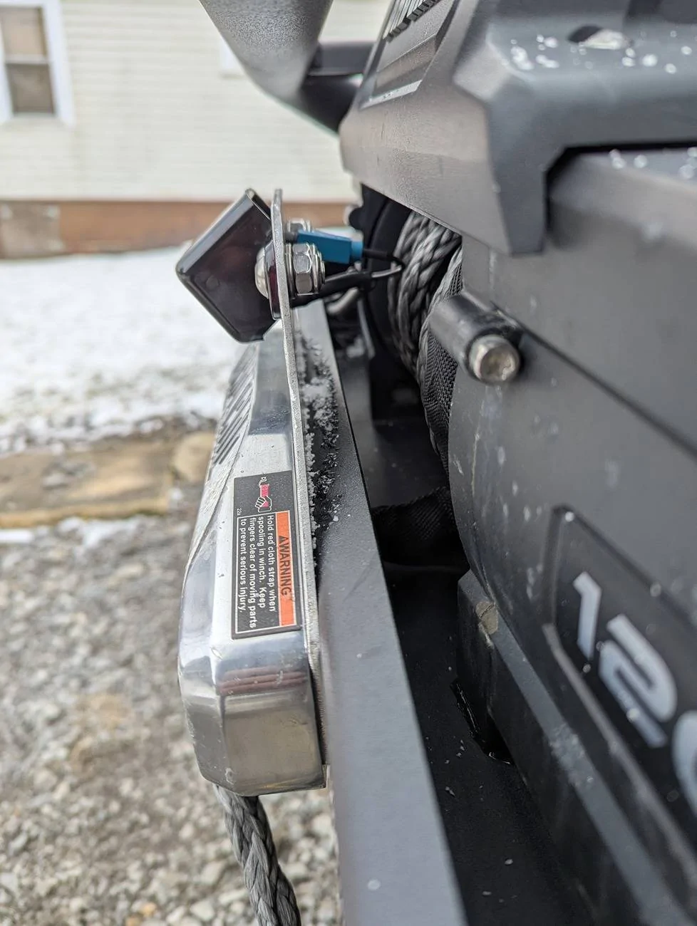

I also made my own camera relocation bracket after reading a forum here.
I can easily make you the same bracket for like $25 & give you a link to the amazon page for the camera cable extension (I think it was $8). Then just a run of washer fluid hose & some hardware.
I reused the existing camera housing & bought some stainless hardware & used a gummy kind of glue that holds the camera in the housing, but will allow it to be removed without damage later if needed.
Ford Bronco Really looking for some advice on winch setup Front Camera Mount

This seems nice - Can you send me some pics as to how the camera appears when in 360 and crawl mode? I notice yours is a lot straighter than others and wanted to see what that does for visibility and 360 view
Yeah, I was going for simplicity. I work at a fab shop & couldn't justify spending the $ for what they're asking for these.
I used 6061 Aluminum, 1/8" thick & just made it fit a standard fairlead.
I might mess around with some kind of rear housing to hide the cable a bit better, but it's perfectly functional for now.

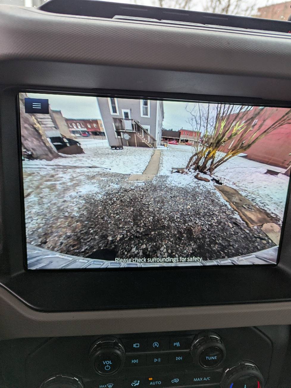

This is the regular camera view, so I imagine it's what Crawl mode would be ( I don't have crawl mode). This is what I get in 4L.
I'll take a picture of the 360 view when I'm on lunch. It's definitely distorted, but it's functional.
Conversely, you can just leave your camera in the stock location, it's just gonna have a winch for half the view.

Would you be willing to make another bracket and sell me one? I like how yours is set up
