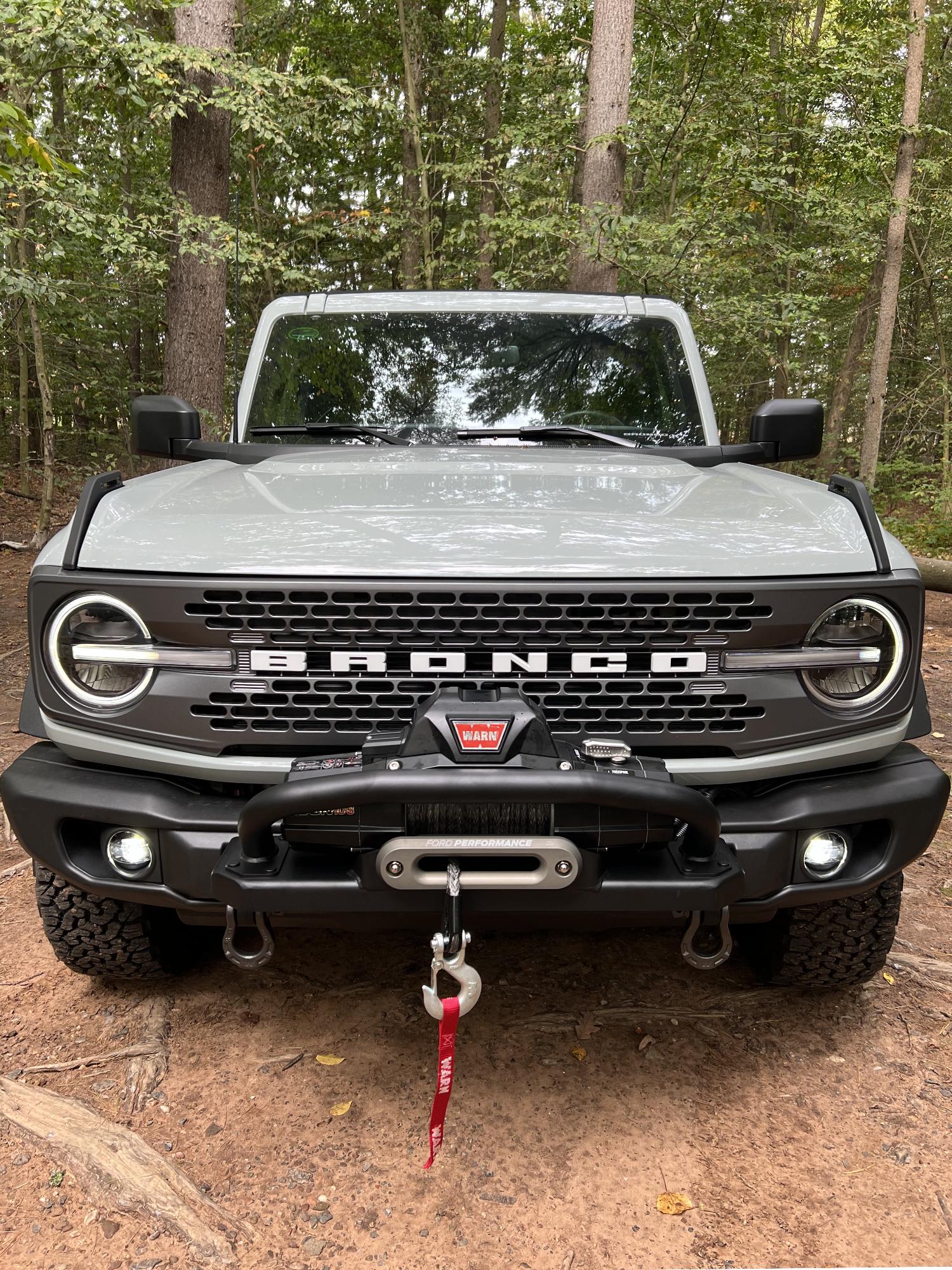

So against my better judgement I dropped several thousand dollars on a Ford Performance winch without knowing it would work. And guess what?? It works!! Some minor modifications, yes, but it works. Video below

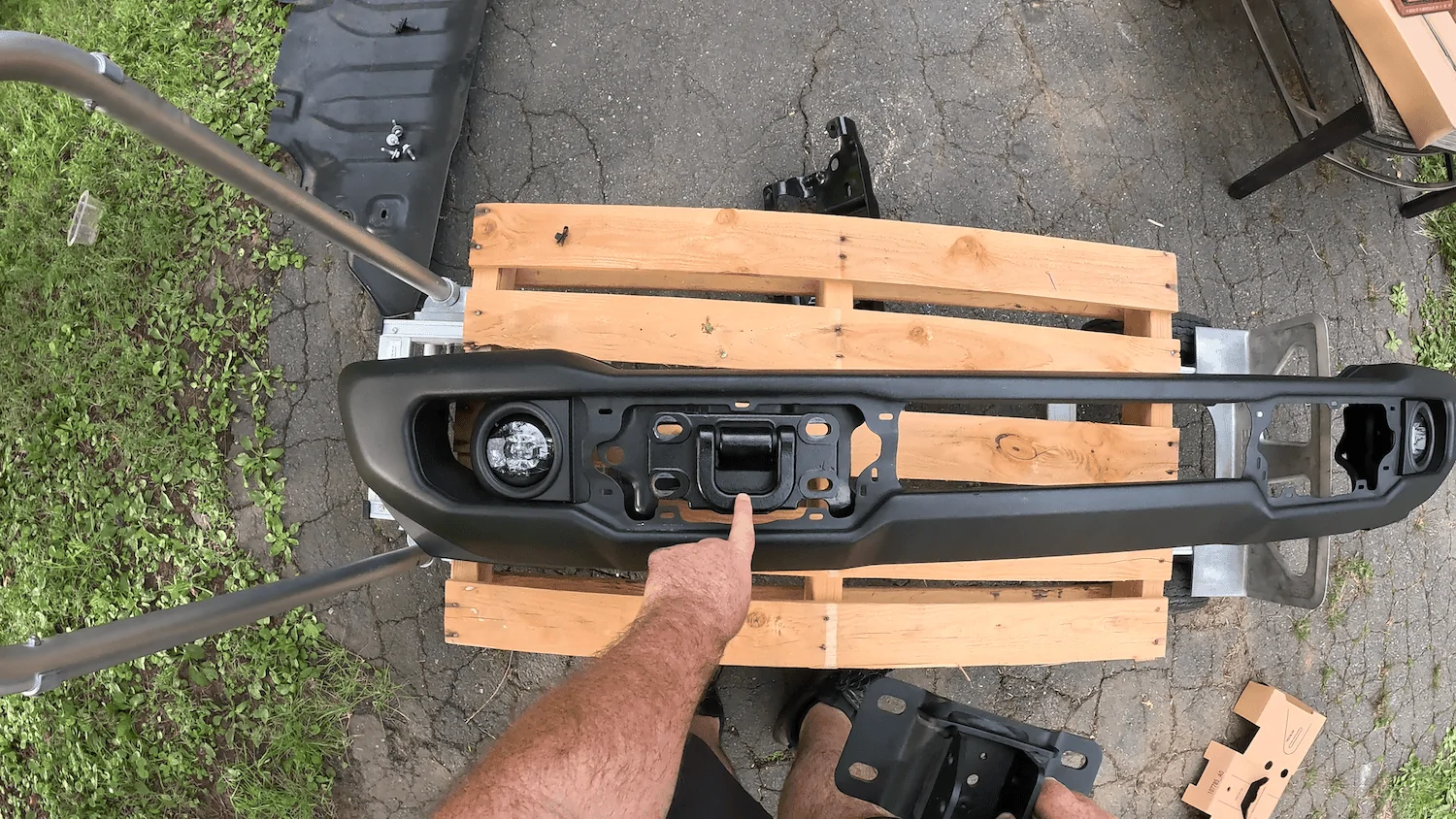

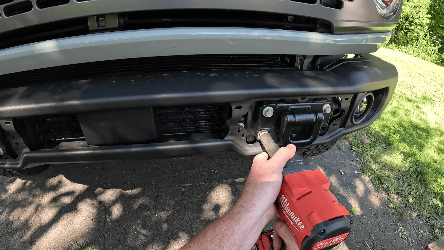

The bolts holding the bumper on. Three on each side.

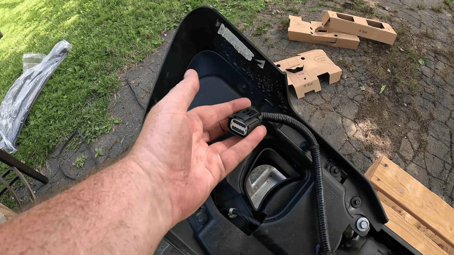

Wiring connector for the fog lights (and presumably the sensors, if you have those):
Ford Bronco Ford Performance WARN winch on capable bumper — Yes it's possible! 1697411885736

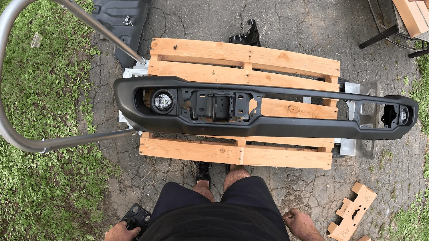

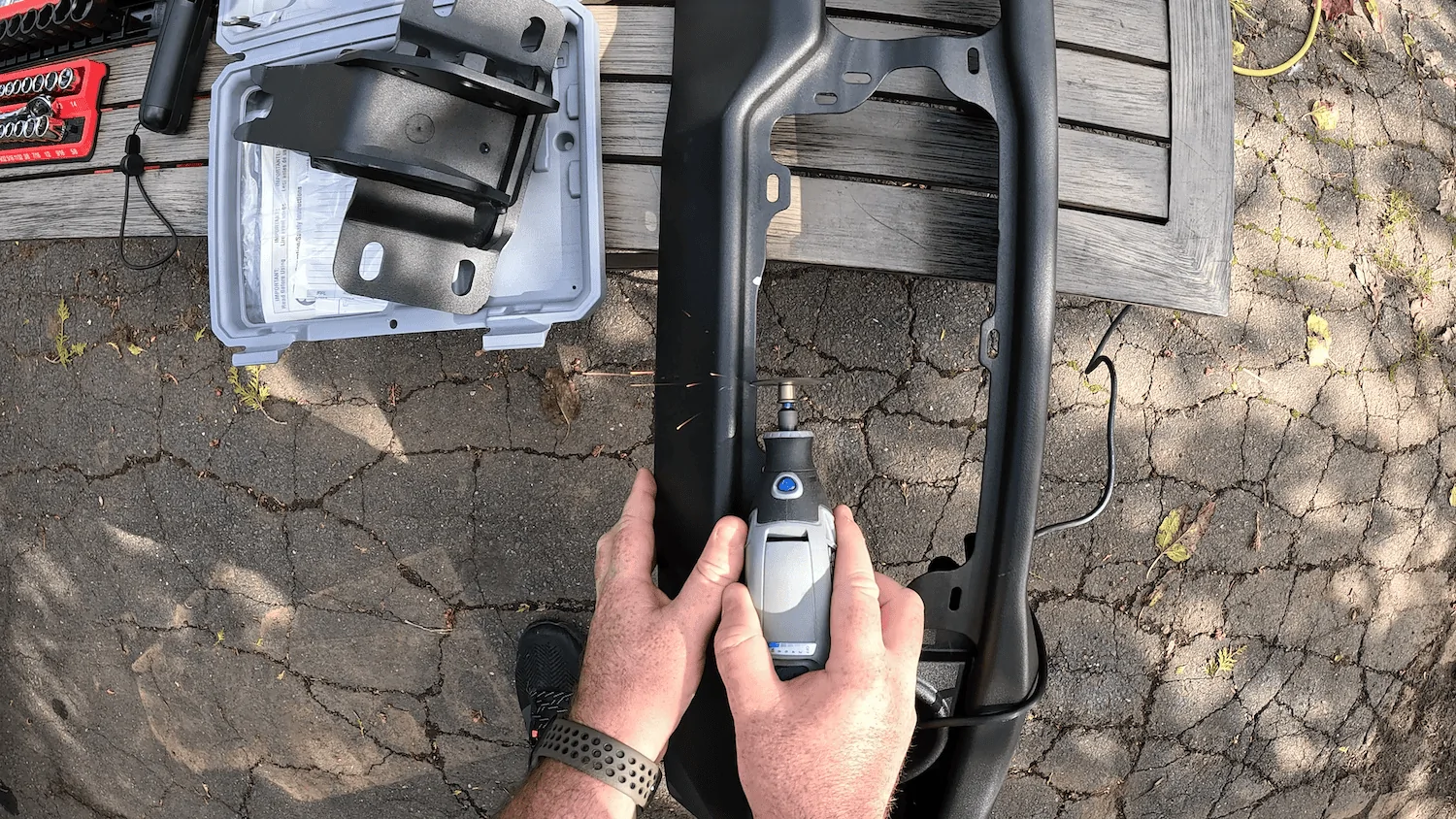

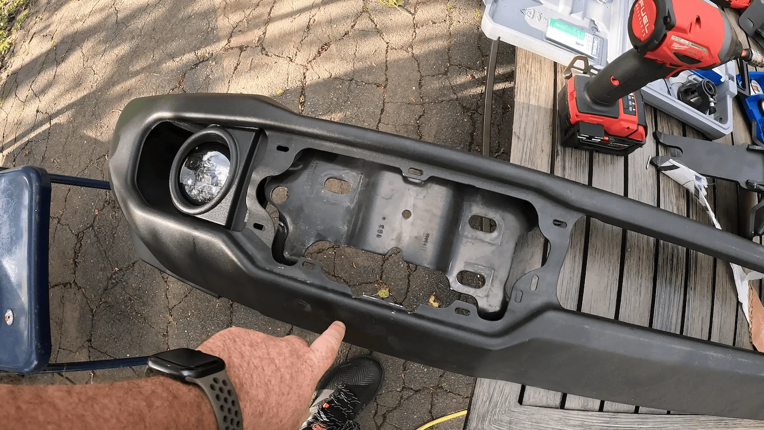

The new brackets. Notice the three holes don't line up due to clearance issues.
Ford Bronco Ford Performance WARN winch on capable bumper — Yes it's possible! 1697411995816
Fixing the clearance issues:
Ford Bronco Ford Performance WARN winch on capable bumper — Yes it's possible! 1697412047690

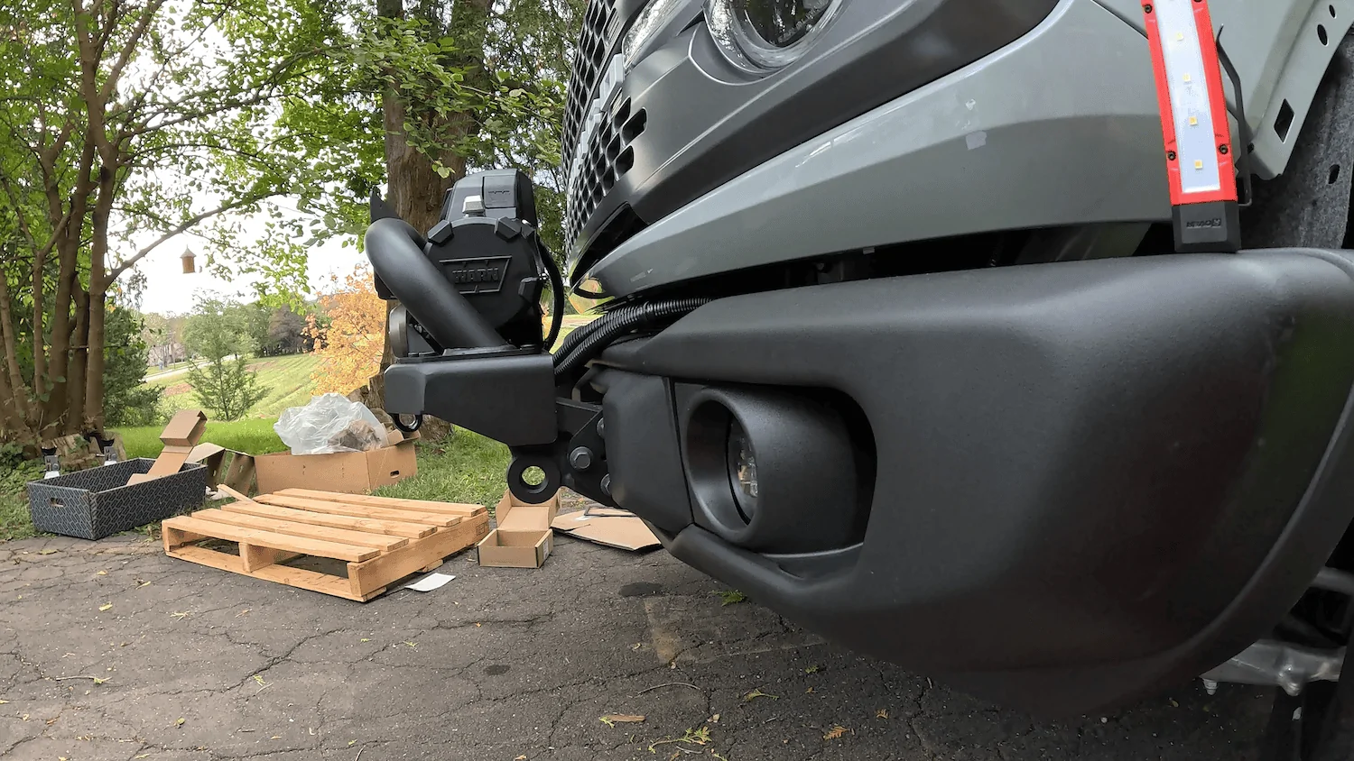

Final product (pre-paint):
Ford Bronco Ford Performance WARN winch on capable bumper — Yes it's possible! 1697412098774

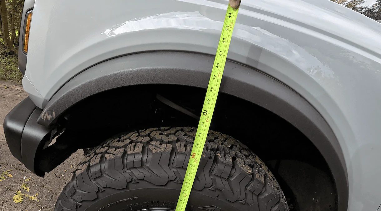

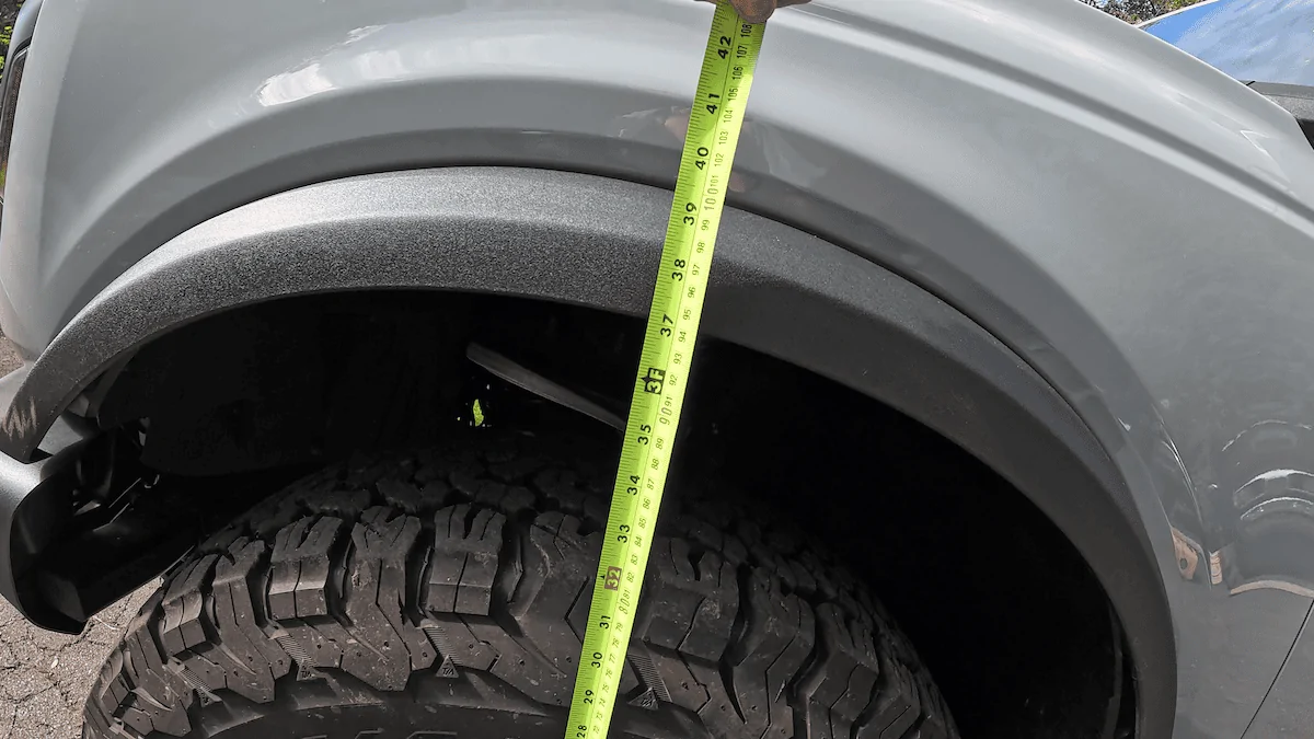

Suspension sag. Note I have a Badlands non-Sasquatch with the 2.3L.
BEFORE:
Ford Bronco Ford Performance WARN winch on capable bumper — Yes it's possible! 1697412429732
Ford Bronco Ford Performance WARN winch on capable bumper — Yes it's possible! 1697412460749

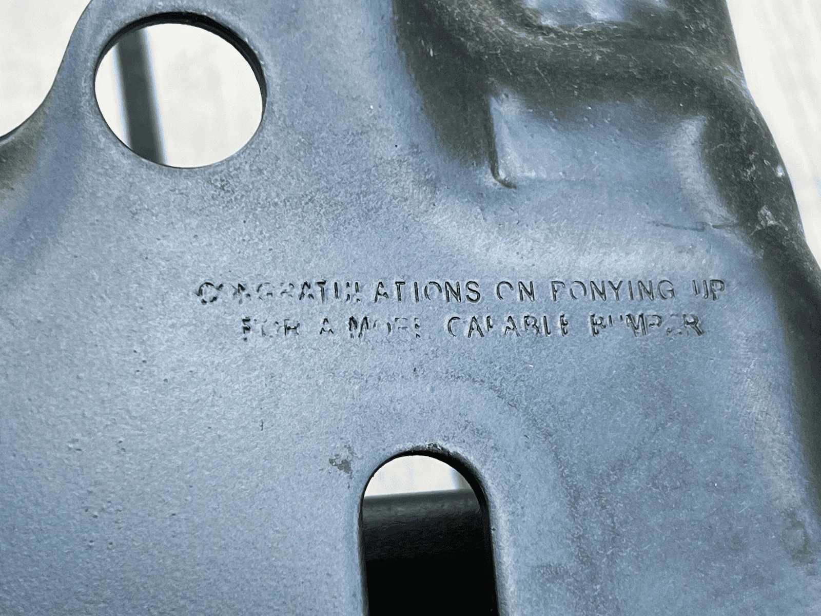

Easter Egg I found on the capable bumper. Reads "Congratulations on ponying up for a more capable bumper":
Ford Bronco Ford Performance WARN winch on capable bumper — Yes it's possible! 1697412552553
FINAL PRODUCT

If you too are like me and have the capable bumper, definitely consider this approach if you want a winch. It really wasn't that bad. Yes it did take me four days to complete the installation, but much of that admittedly was me dodging rain and fussing around with the cameras for the forums/YouTube. If you are organized and know ahead of time what you are getting into, this is easily a weekend project.

What’s the spec on torque weight on bolting the winch and the bumper back on?
The vast majority of the major structural class 10.9 bolts were 80 Nm (59 ft-lbs) or less.
The six bolts that hold on the forged bumper support pieces were the highest at 110 Nm (81 ft-lbs).

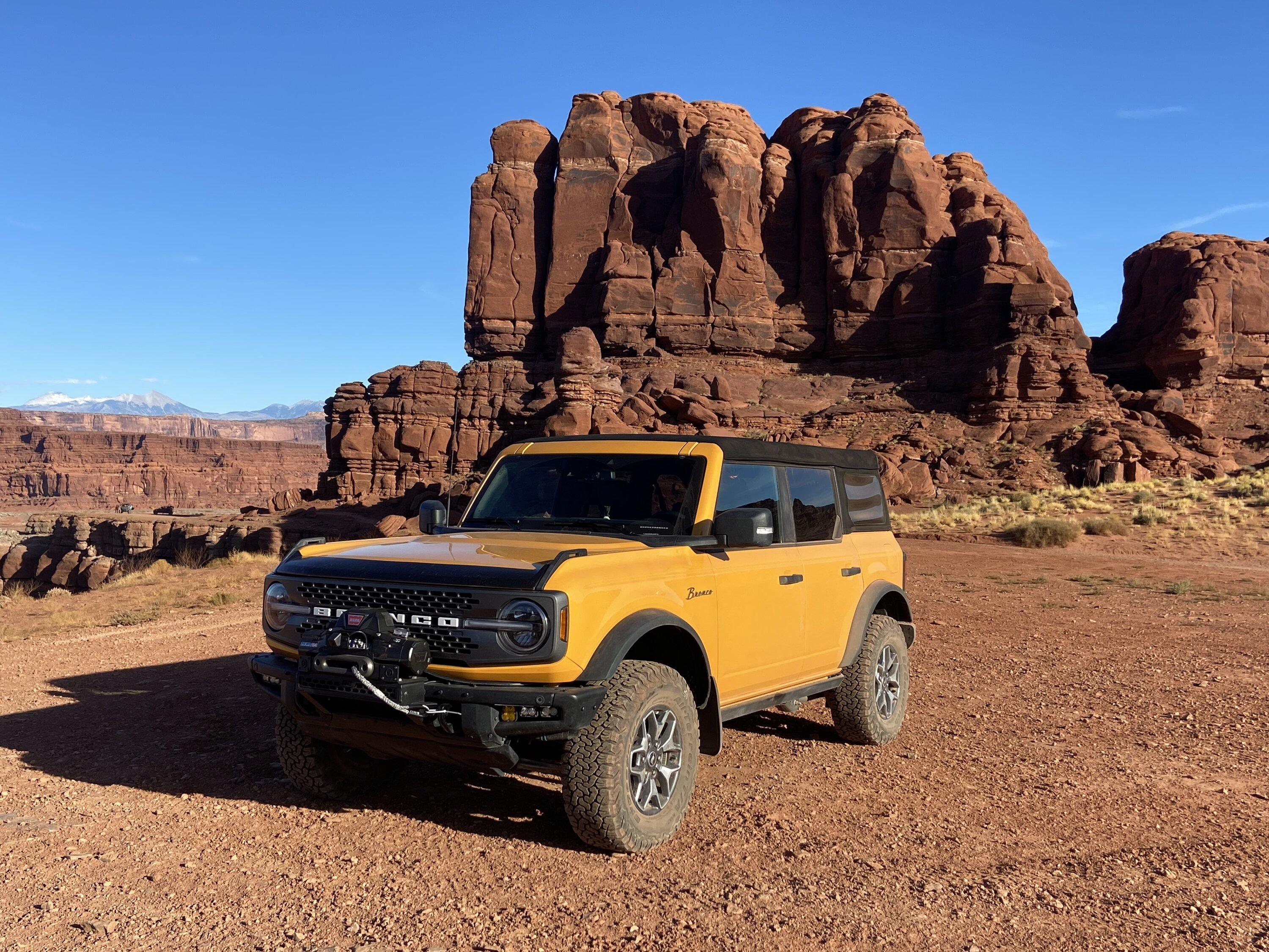

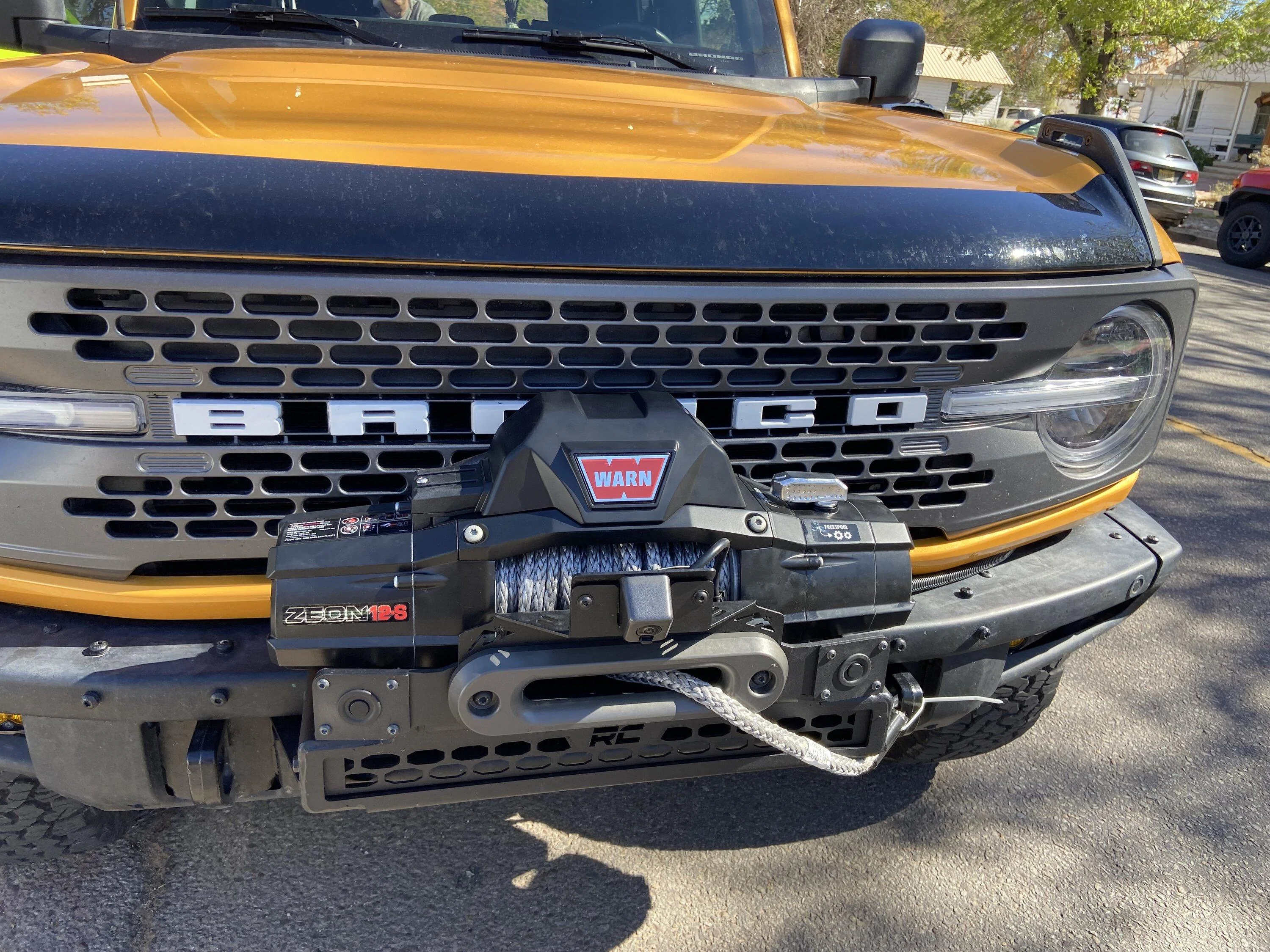

To add, I did mount a Zeon 12-S onto a RC plate with good results. Note the M2M camera relocate bracket as well. Well worth the investment in this item!
Ford Bronco Ford Performance WARN winch on capable bumper — Yes it's possible! IMG_6669
Ford Bronco Ford Performance WARN winch on capable bumper — Yes it's possible! IMG_6693

Oddly, it’s really hard to find a winch hook here in Moab…
