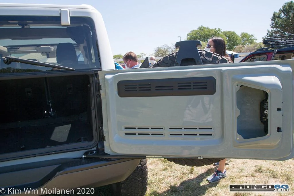

I wonder if you can access those clips from inside the tailgate by removing the vent cover?
Ford Bronco Rear Ford emblem 1641186009182
That is what I am wondering too. I have not taken that piece off but if anyone has and knows if you can see the clips?

I do not remember having access to see or reach the clips when I took my door apart. To release them, simply heat and/or use some floss or fishing line to loosen the adhesive. Use thin plastic flat trim removal tools and push in from above and below to depress clips. It will then ‘pop’ and you can work on other end (put something in place to keep first one out). They are aligned such that the clips depress vertically, not horizontally.
