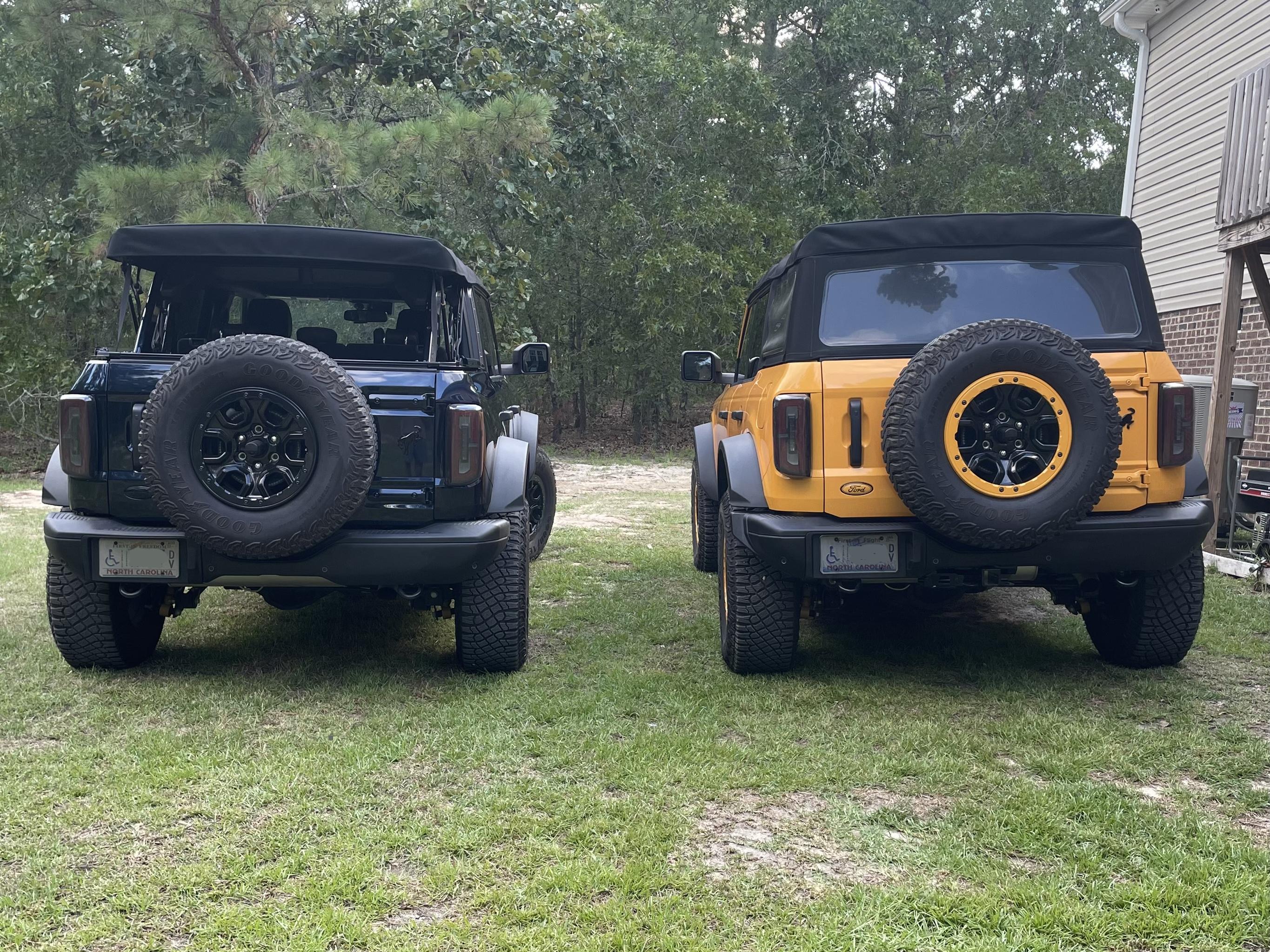

Worthy upgrade for sure. Did color matched emblems and black horses on both Bronco’s.
