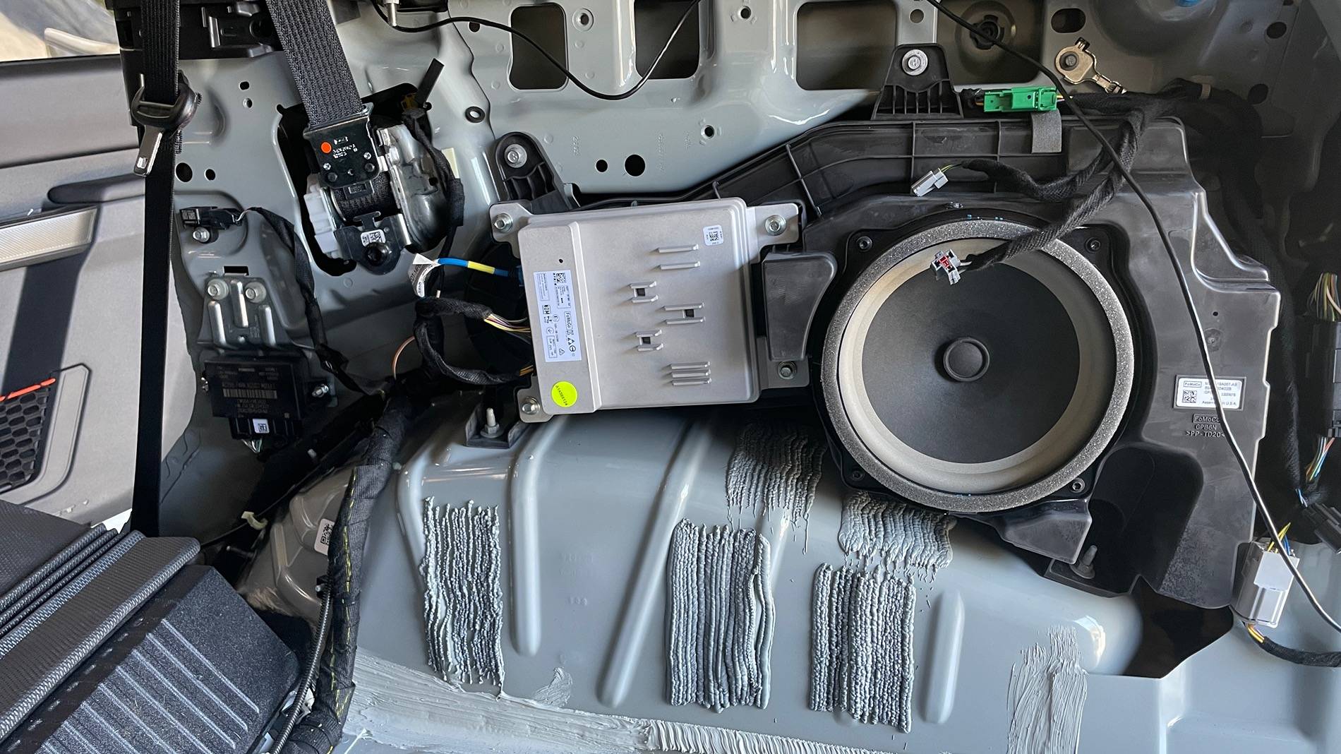

If I wan to change the speaker only anyone have a suggestion that won't break the bank and doesn't require any other mods...plug & play

If you are changing speaker only - i.e. no amp, then your only realistic option is to go with the 6.75" "sub" from Kicker - however that will likely prove to be futile at best and a waste of time and money to buy/install. The correct answer is the Kicker 8" Comp R with a Kicker Key 500.1 amp.

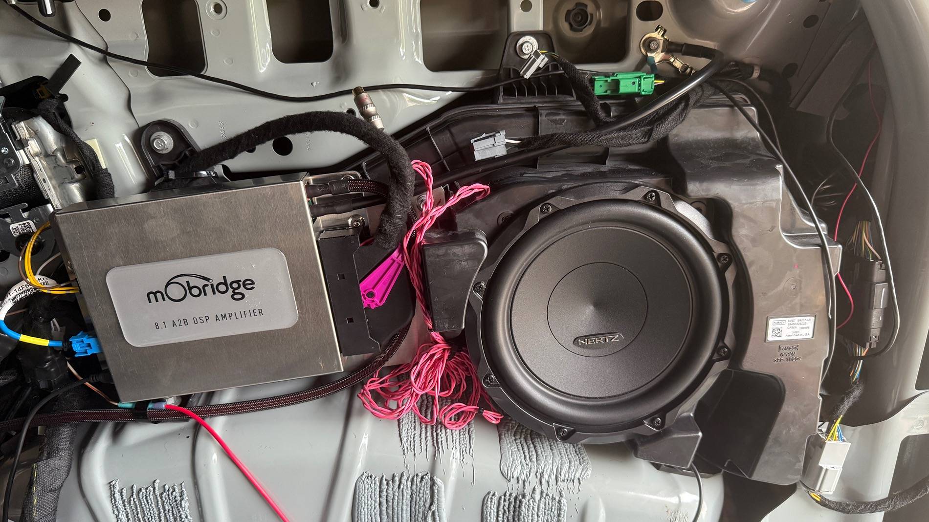

I replaced mine with a Hertz Cento CS 200 S4. It fits in the stock location but the screw holes do not line up so you'll need to either use an adapter or do like I did and just use the included screws.
There are plug and play harnesses although with my setup, you'd need to clip the subwoofer end off and "bridge" the wiring since it only has one positive and one negative terminal where the stock sub has two of each. But this would allow you to plug in to the stock wiring.
https://www.amazon.com/dp/B0007WTEVM?ref=ppx_yo2ov_dt_b_fed_asin_title
There was a mild improvement but I also did it just before installing a Mobridge amp/dsp which you can see just to the left of the sub. I don't listen to anything really "boomy" and I like my bass tight.
I'm pretty happy with the Mobridge but I still think the most important aspect that everyone bypasses is the source material. Even with the Mobridge, if it's a "flat" recording, it'll still sound less than optimal where great recordings that are at a higher bit rate sound really stellar.
Streaming and wireless bluetooth is admittedly, easy. If I had to go back and start over, I'd probably start with the source material first and work on that. Just my .02 cents.

If you don't want to add any power, just speakers, the only way to improve the low end would be to find a very sensitive dual coil subwoofer.
