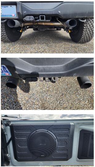

That's crazy, I don't know why ford would do that. Maybe on an EV I could see it. I have a 24' Badlands with the BnO system and haven't noticed it. I did the Corsa cat-back exhaust and I can tell you to GET IT, you'll love it. I was very happy with it. And also put in a Hertz 12" sub too. Now I wonder if it's going to sound different if I go in and make those forscan changes?
You WILL notice a difference. Will not sound like a v8 and you’ll hear the corsca
