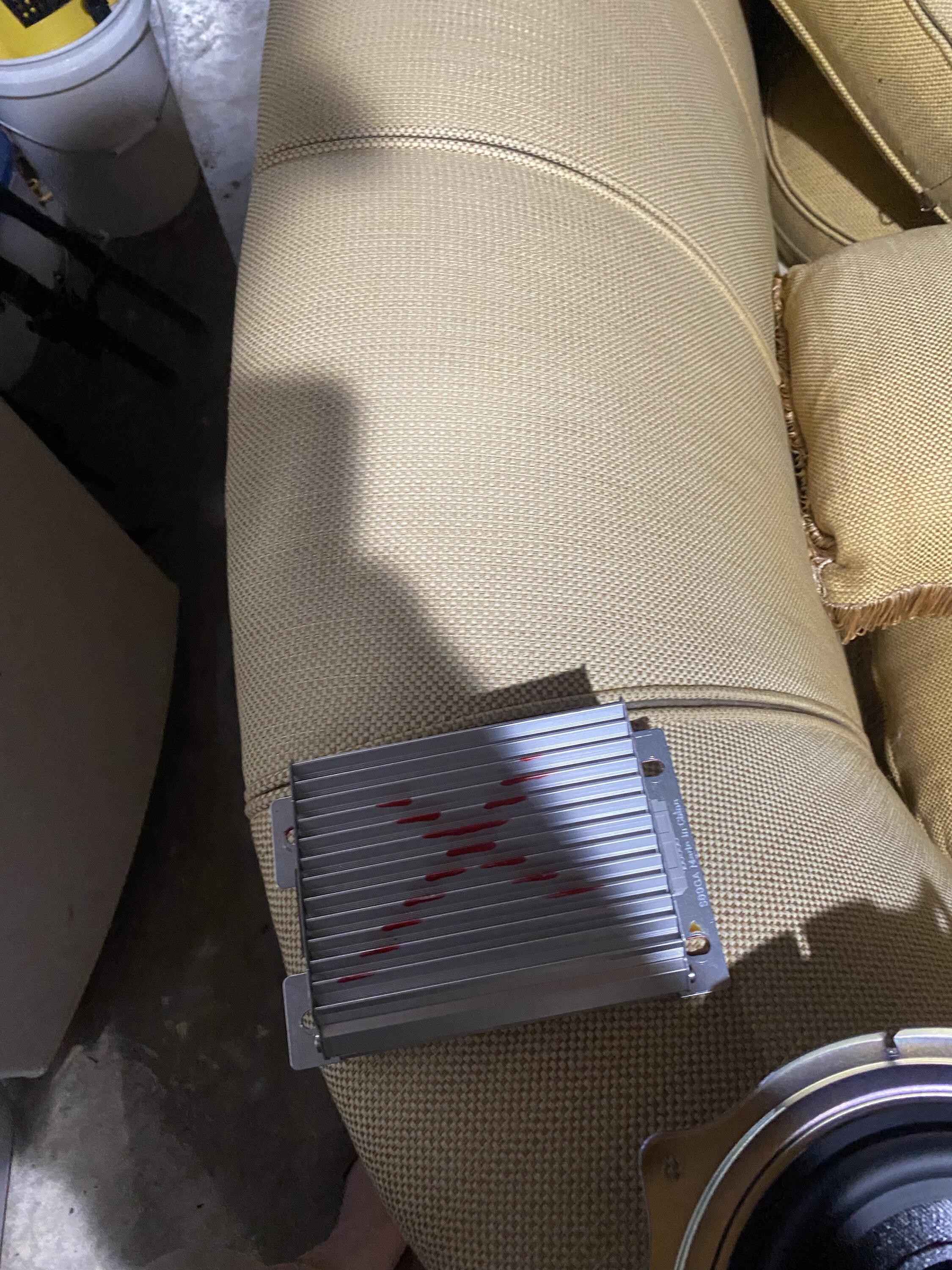

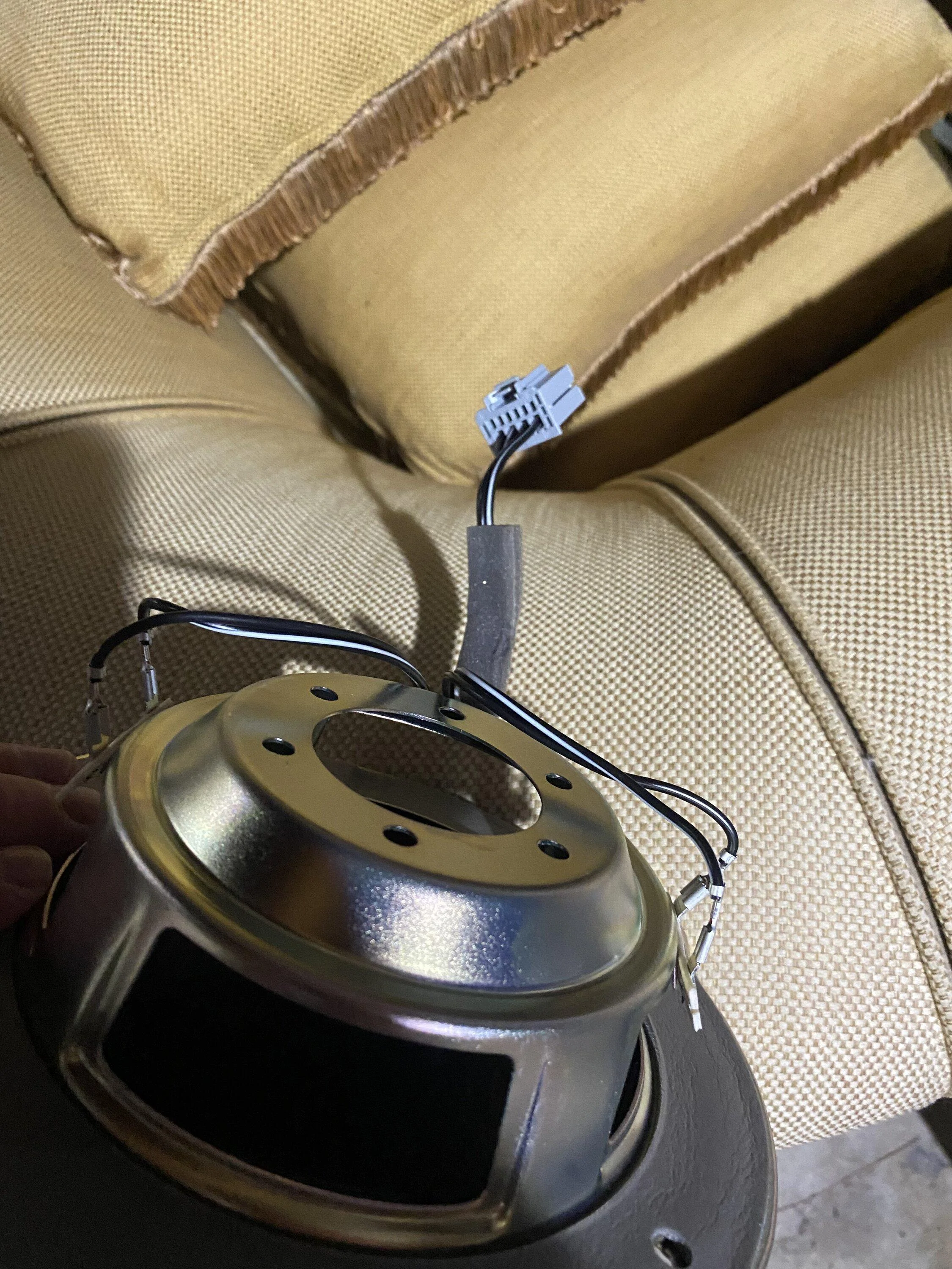

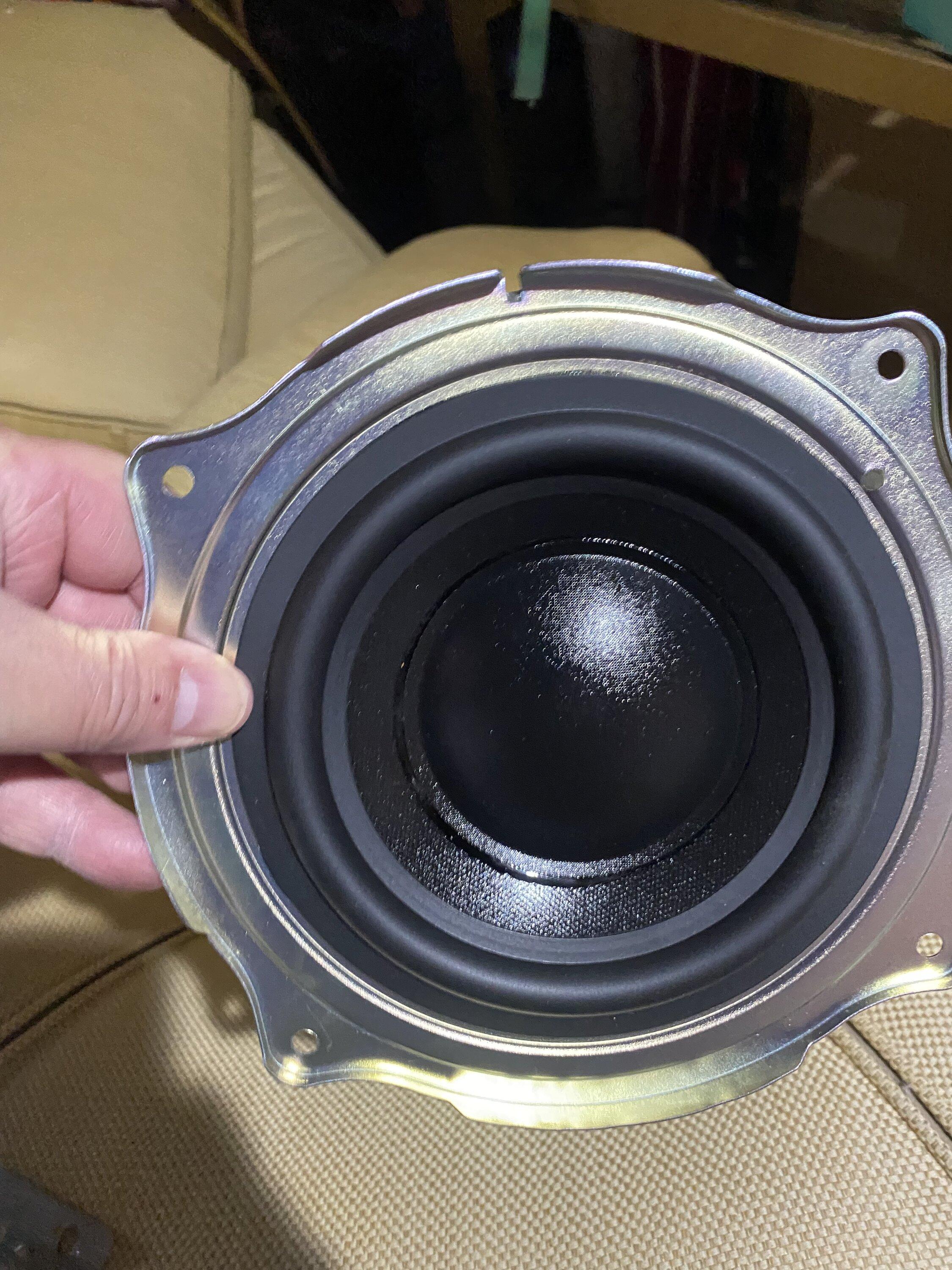

Ok so everyone knows that Ford deleted Subwoofers from the 6 speaker audio system and credited $250. Why did they put dummy speaker and amp in the hole? Wouldnt it be cheaper to leave it empty? The dummies cost something. Weird. I put a Kicker 8 inch and amp in the hole. It was hard working with that $250 budget.
