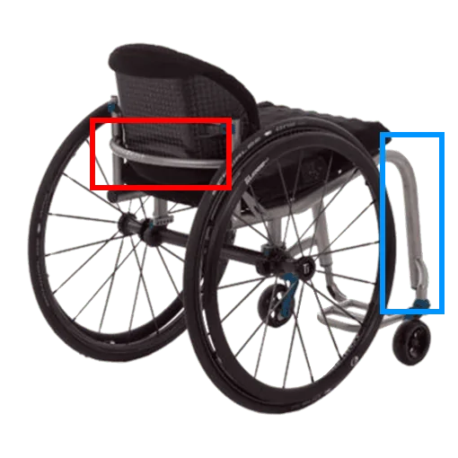

use the bar on the rear of my chair ( seen in red ) and clip / connect it to the gate. I think any type of hook / clips setup would need to be longer to get past the wheels but I don't think there would really be much of a drop when the door opens.​
I was thinking of some type of carabiner connection on both sides. That way I could remove it as needed. When the tailgate opens, the chair is hanging. This idea has gone all types of nutty, with thinking of a way to lower it etc but right now I'm just thinking of the connections.​
Idea 2
use the front bars ( seen in blue ). This is kinda the same setup but I just don't think there's any way for me to set this up and it work. But I wanted to call it out in case somebody has a great idea​

3. it's rigid frame and is the same model in the picture I tossed in there. All and all it has a pretty normal setup but sits a bit taller than other chairs I've used / seen

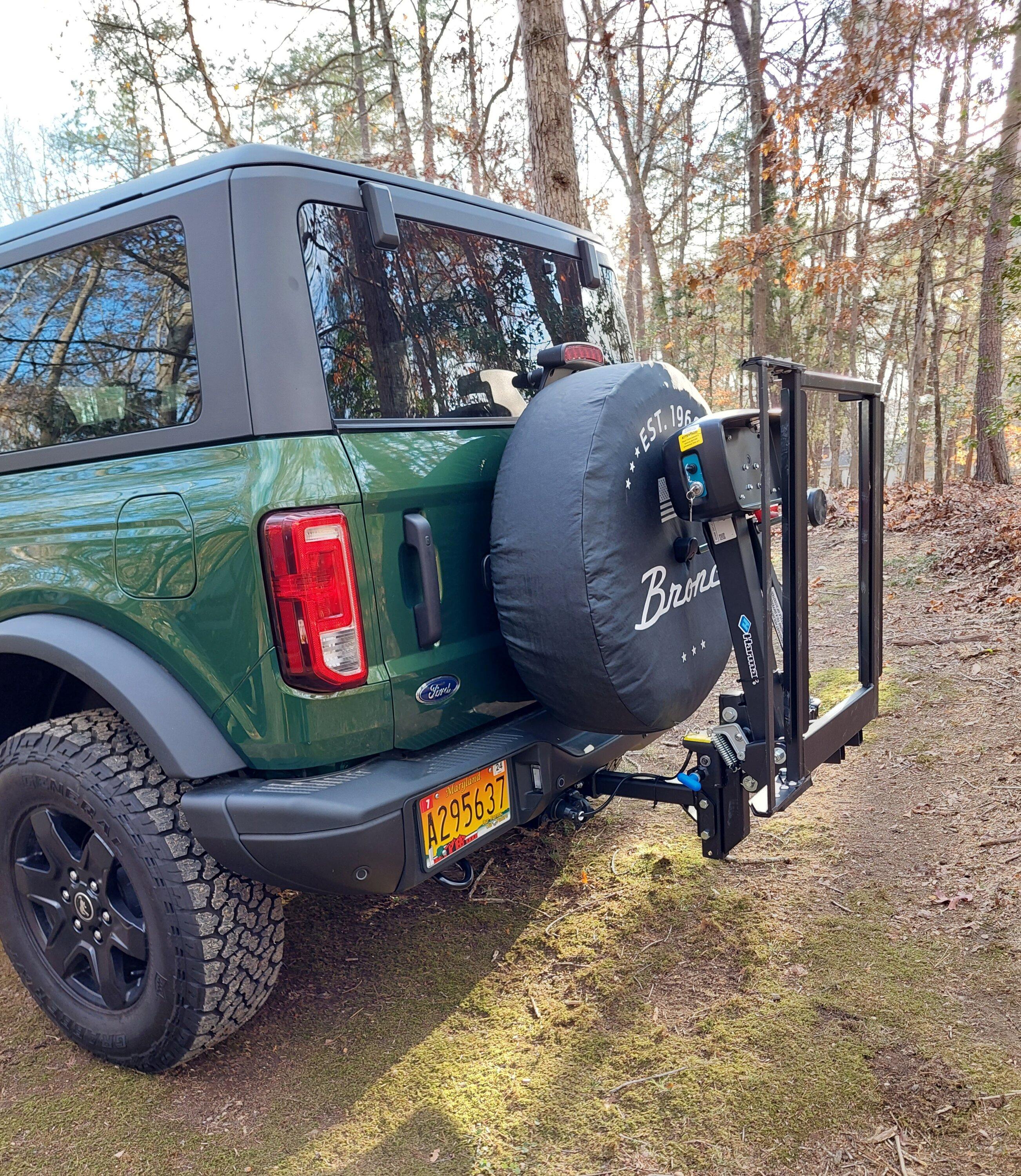

I have a 2dr and needed to haul my scooter. Not enough room inside so I installed a lift.
Ford Bronco Rear Tailgate Weight | Wheelchair Idea BR6RV_5_1024x682
Hi. I need to put a lift and mobility scooter on my Bronco for my parents. Curious if your lift came with a long bar to reach the hitch receiver, or did you use an extender? Also, do you know the total weight of the scooter and lift? Thanks!
I got the Harmar lift AL160 lift, ALA125 extra long hitch adapter, AL105L light weight swing adapter. I don't have my weight calculation handy, but with my Buzzaround EX 3-Wheel scooter total weight was less than 280lbs.
Thanks! Very helpful!

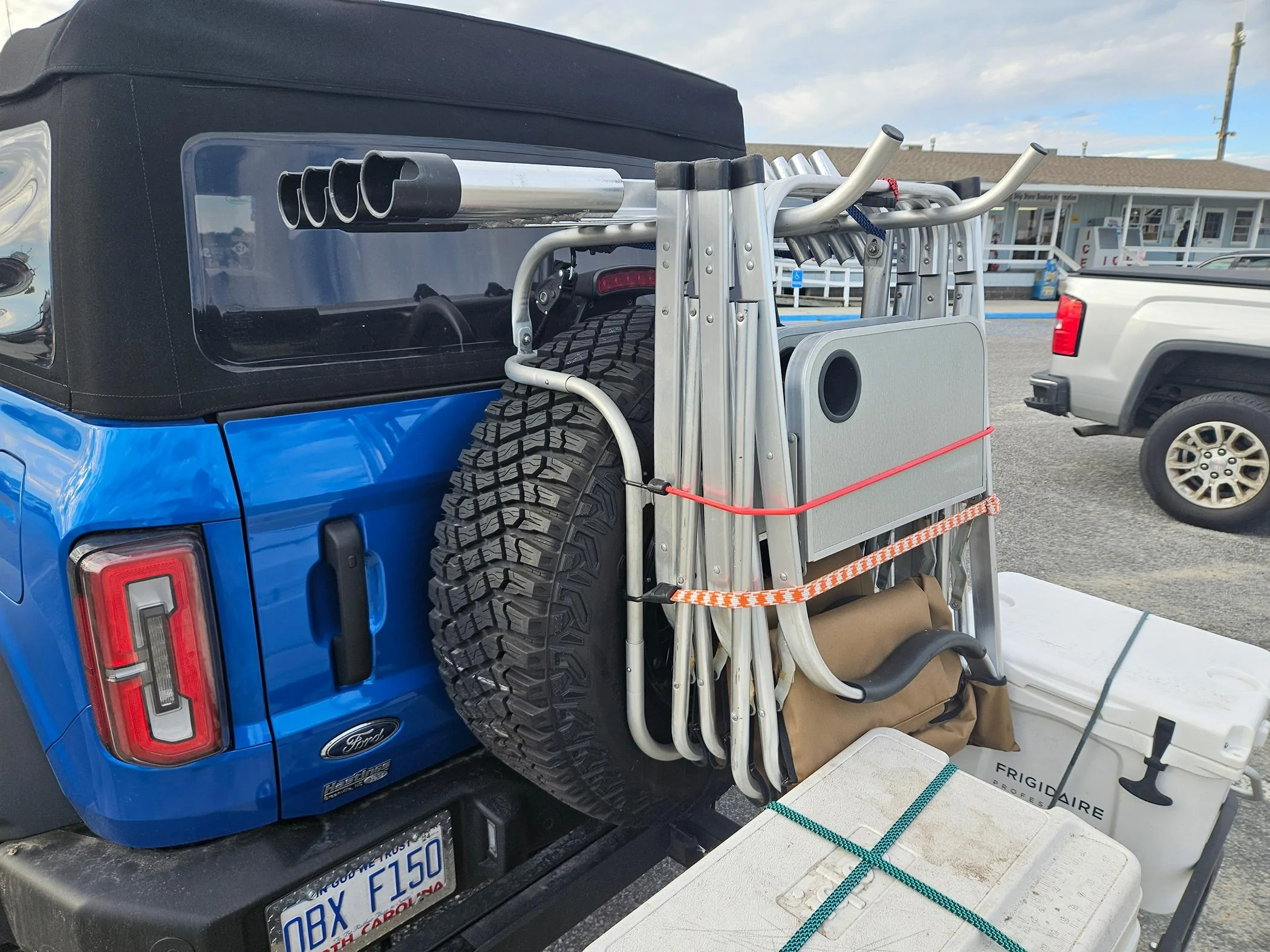

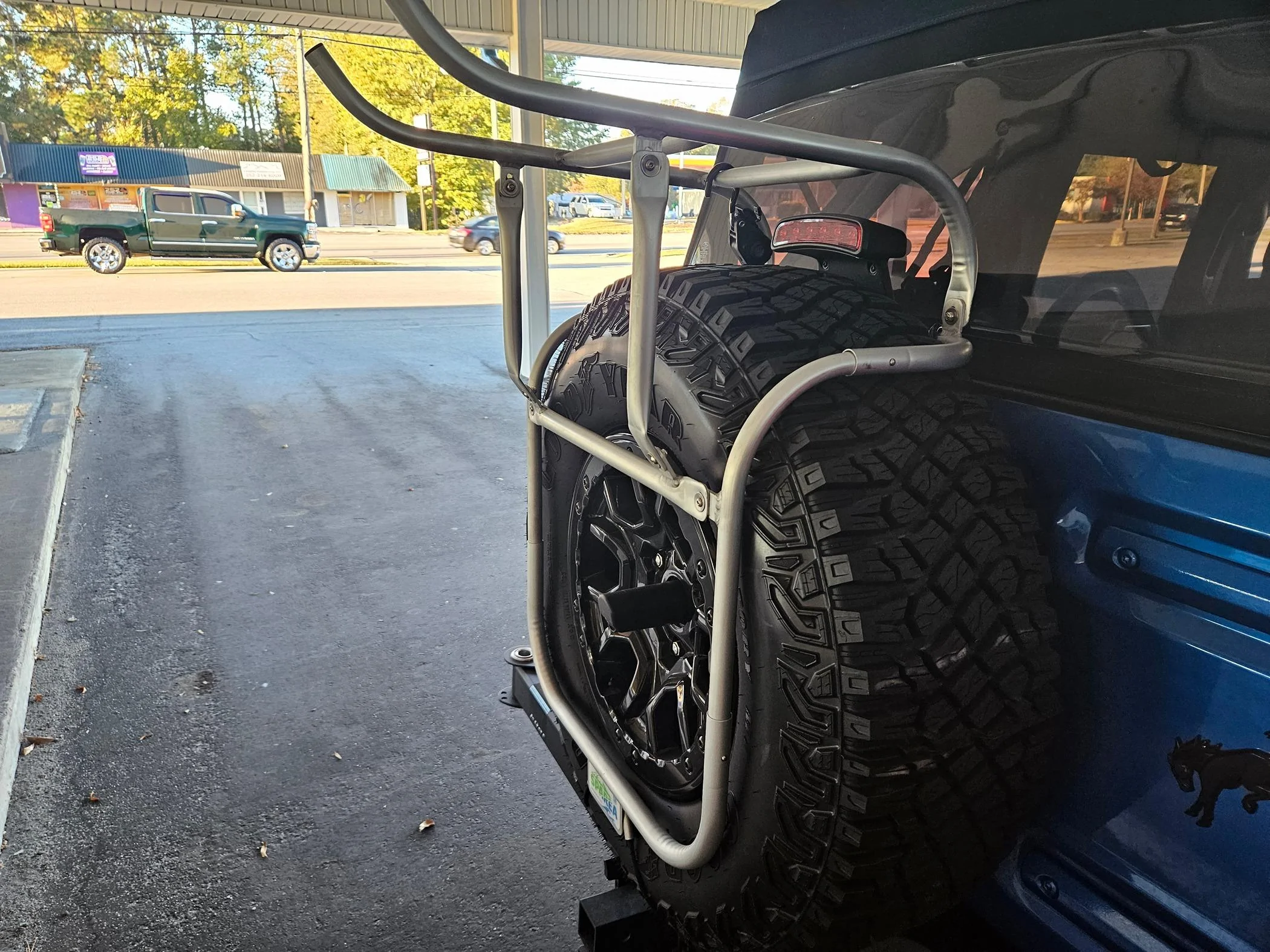

I use a spare tire rack from @sparea for my beach chairs. looks like it would work easily for a wheel chair.

you can get them with fixed or adjustable arms.

I bet that would work fine! And a low cost option as well. Looks like his chair only weighs 9lbs which is a hell of a lot lighter than some of the 37” tires folks are putting on the tailgate.
