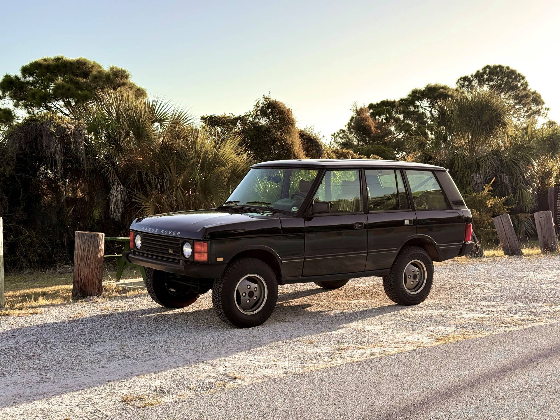

Oh I'm quite familiar with Land Rover reliability first hand lol.
All jokes aside though I think some of it is blown out of proportion.
But somewhat ironically, I currently have a stuck tailgate on the Rover lol.
However that's a discussion for another thread....and once I get my tailgate(s) open again hah.
