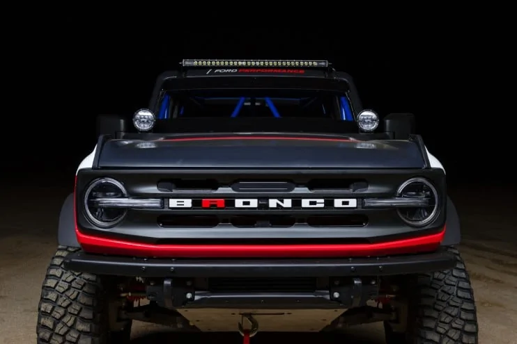

Does anyone know if any companies are planning on doing something like this?

Hoping fun haver does with that bumper they showed off.
goatman
Richard
Jul 3, 2021
552
1,523
Bakersfield
A bunch of Jeeps
You have to be able to get to the winch release handle to free spool. Is that the 4600 Bronco? Very likely they are using a Gigglepin winch, from Europe, that has a VERY fast spool speed, and a solenoid controlled free spool, so no need to get to the winch. I like that, still waiting to see that truck in person. Will go over it carefully the 1st week of Feb.

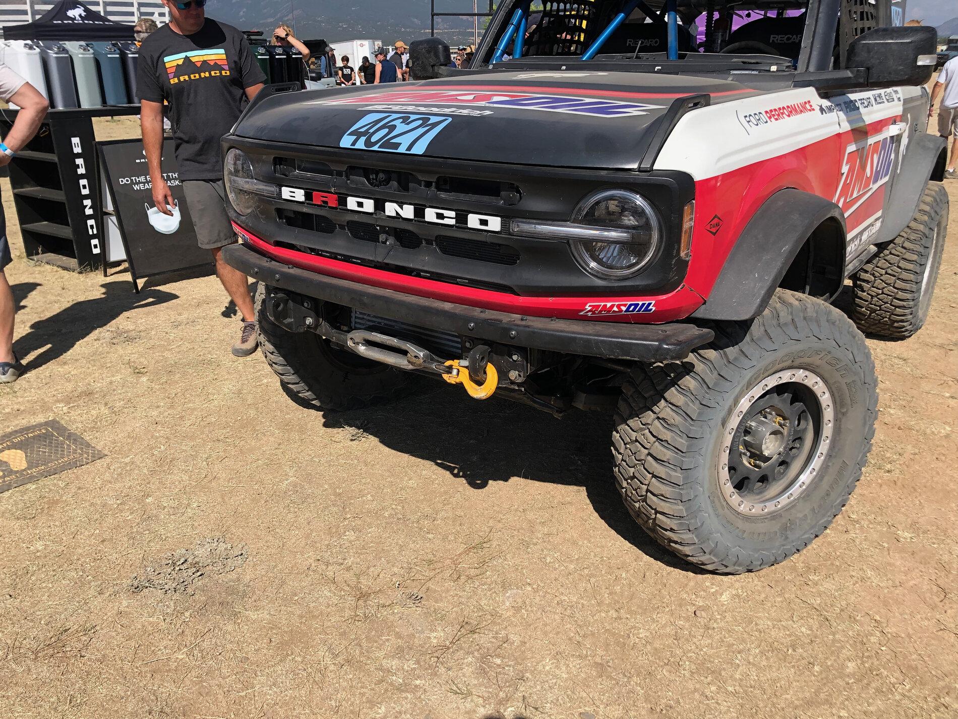

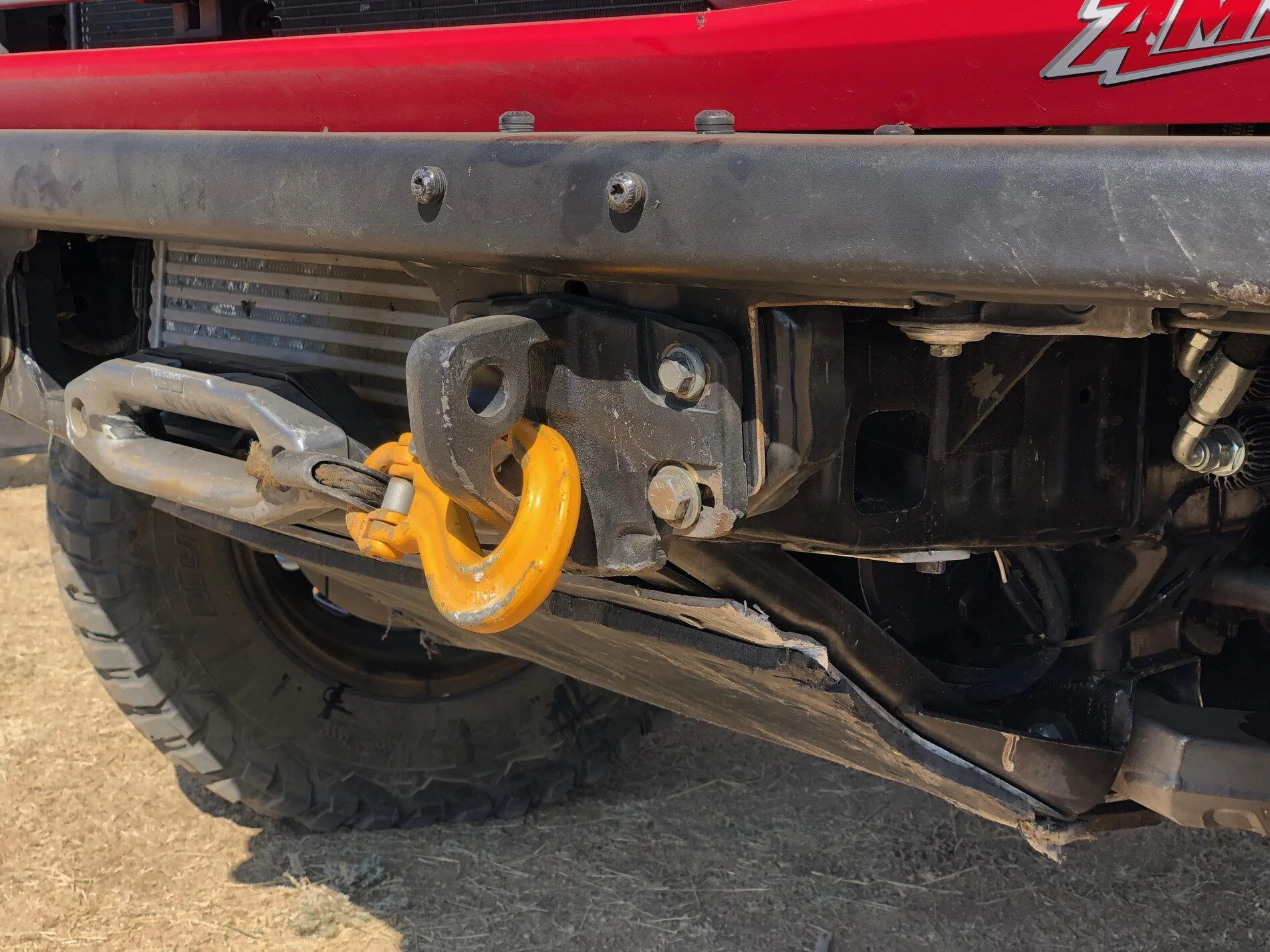

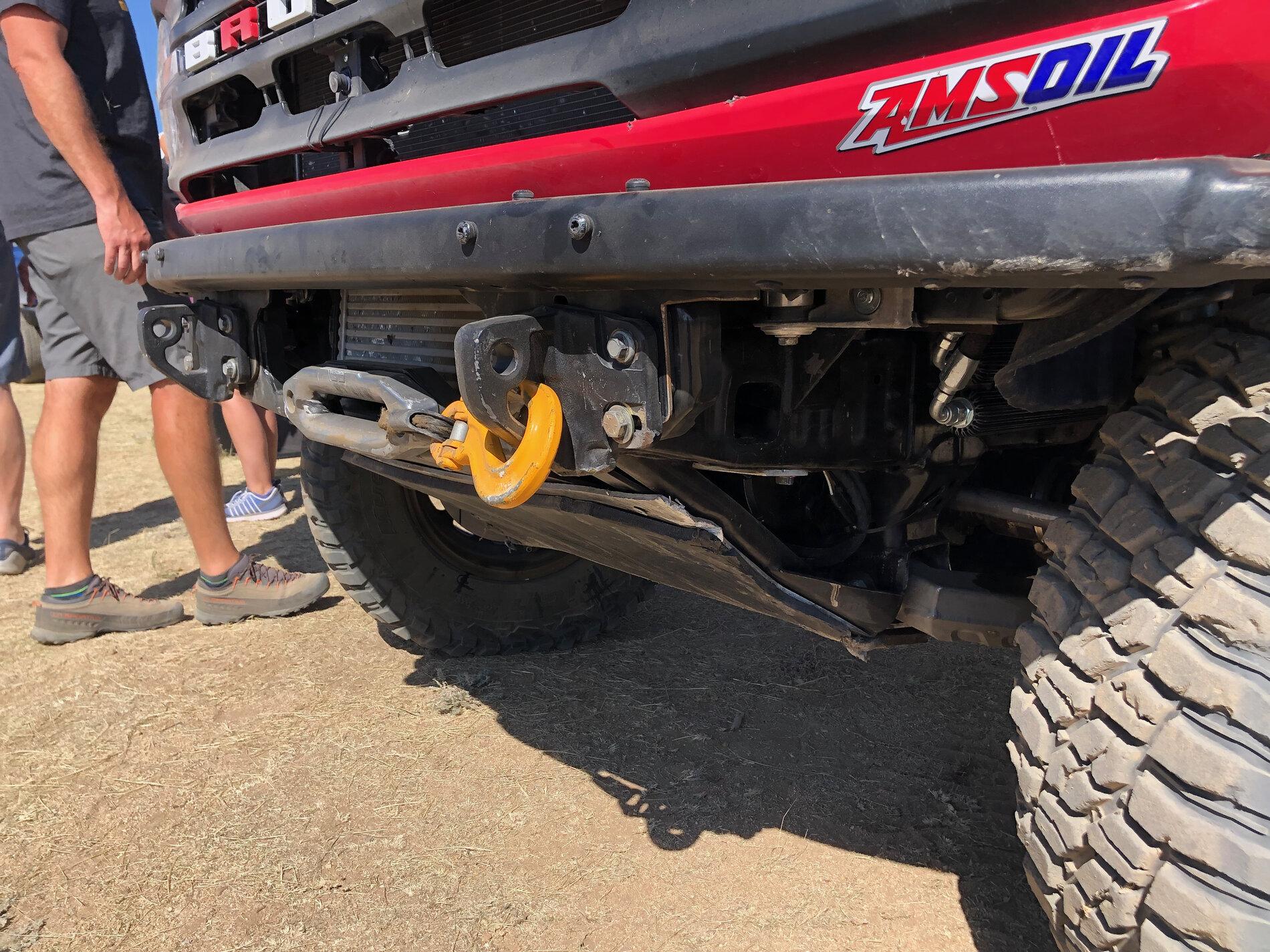

This started life as the stock modular bumper but somehow they hid a Warn winch (one of the sponsors) behind the intercooler above the skid plate. I don't know what special other changes were involved, but at least we know it's possible.

Thats exciting!

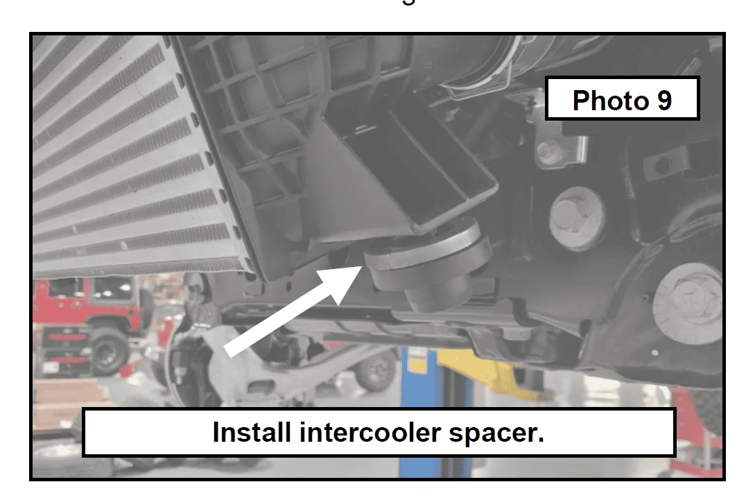

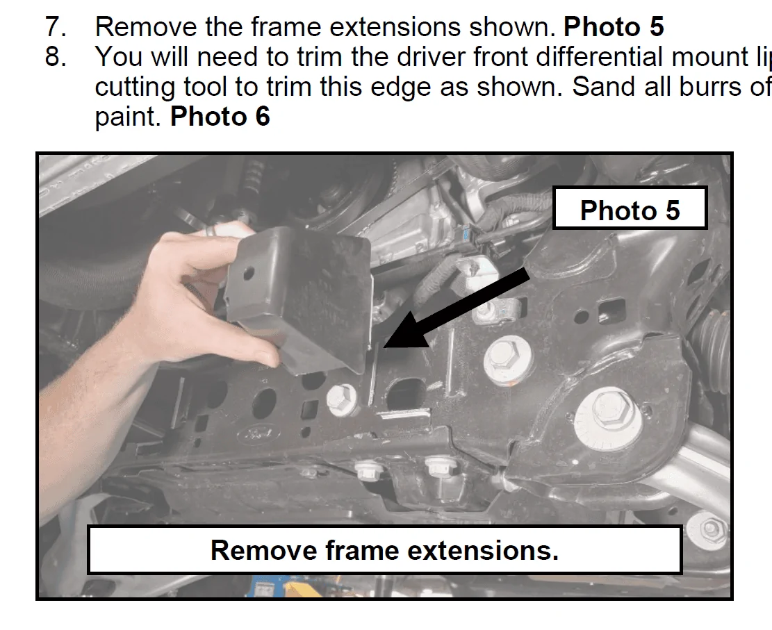

As it turns out, it is trivial to make a hidden mount if you cut off the unused frame tabs and shift the intercooler slightly. RoughCountry has a cheap hidden mounting kit, but currently only for the plastic bumper. Hopefully we'll see some options soon for the modular bumper.
RoughCountry instructions:
Ford Bronco Recessed Winch Bumper? 1632934892598
Ford Bronco Recessed Winch Bumper? 1632934915927

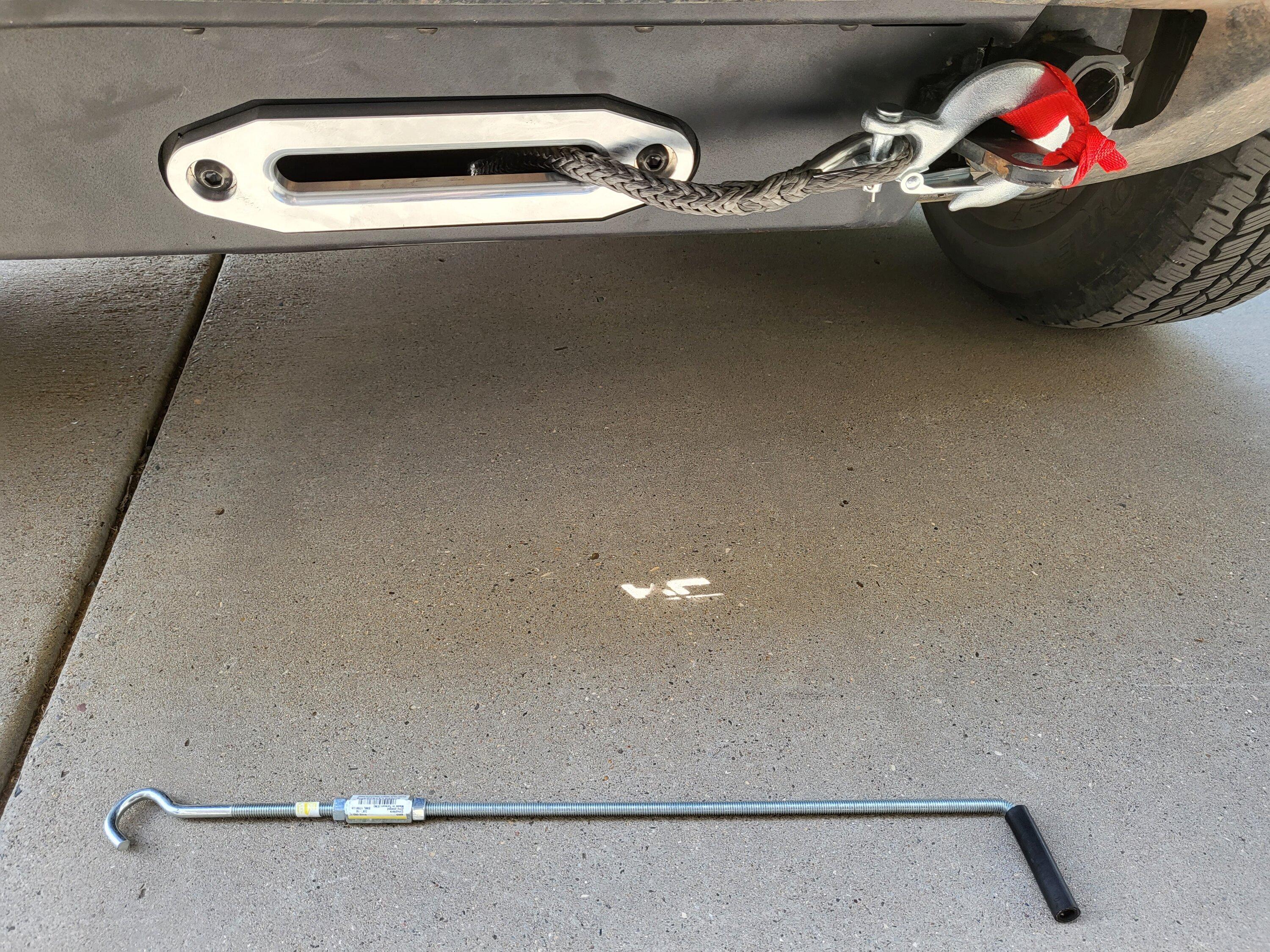

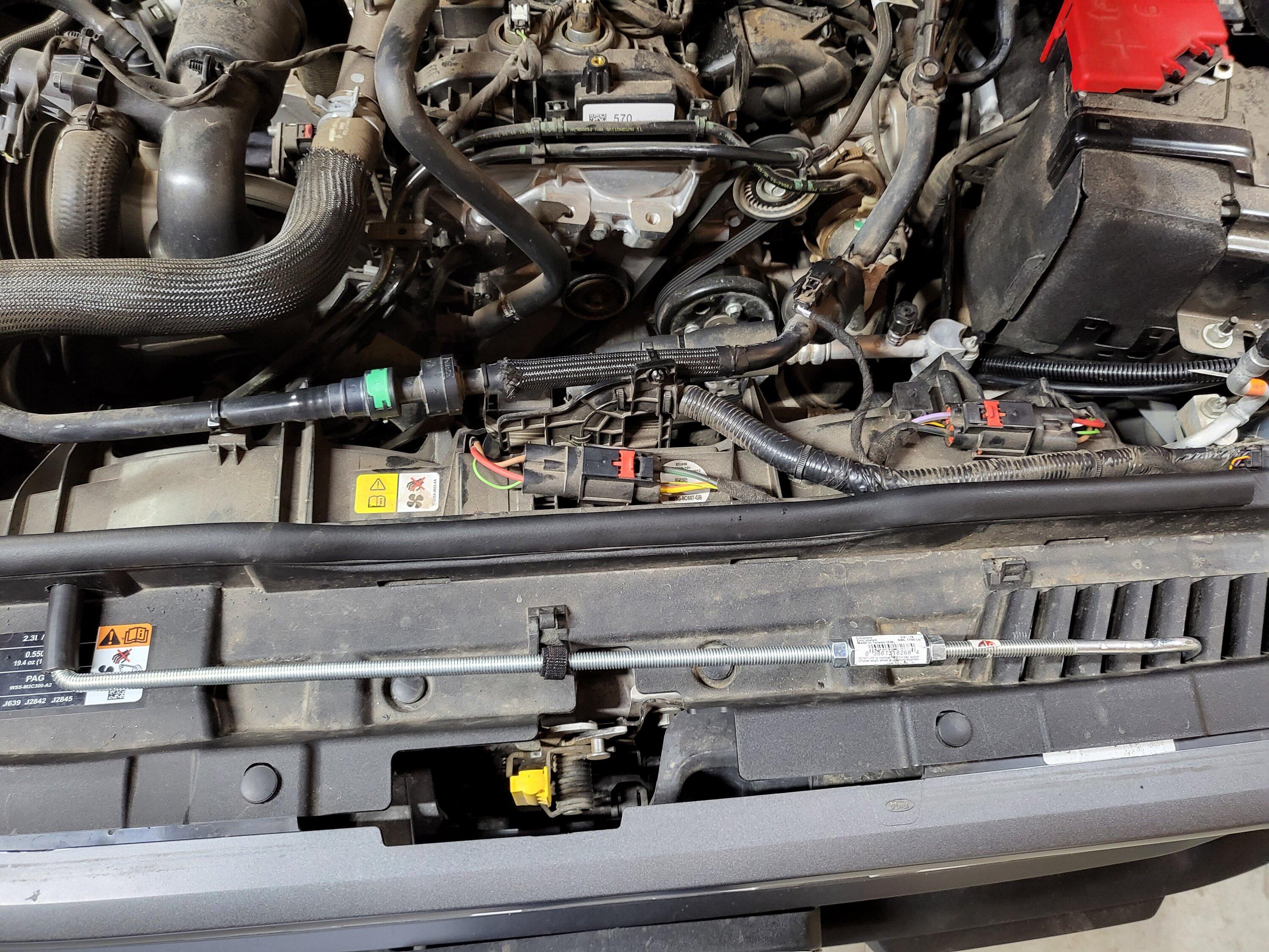

Hidden winch + cylinder = cannot reach free spool lever and you need to make a custom tool to turn it on a 4 cylinder.
Just remote mount the winch controller
dgorsett
Apr 3, 2019
3,776
7,585
colorado
F250, Mustang, Explorer
On my 2.3 I could leave the control box as is but did make a clutch tool.
