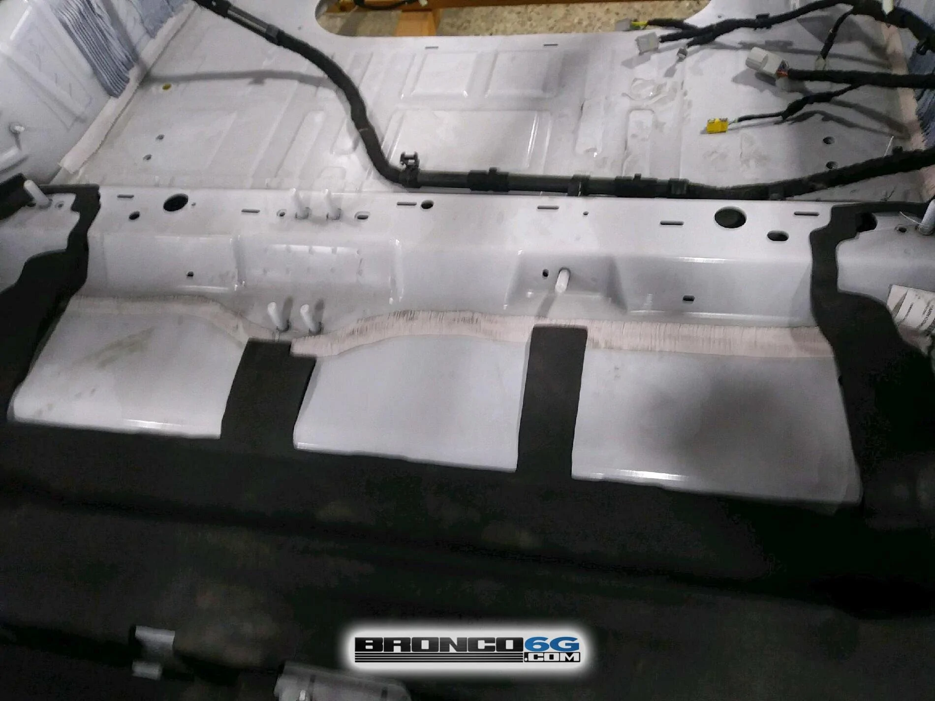

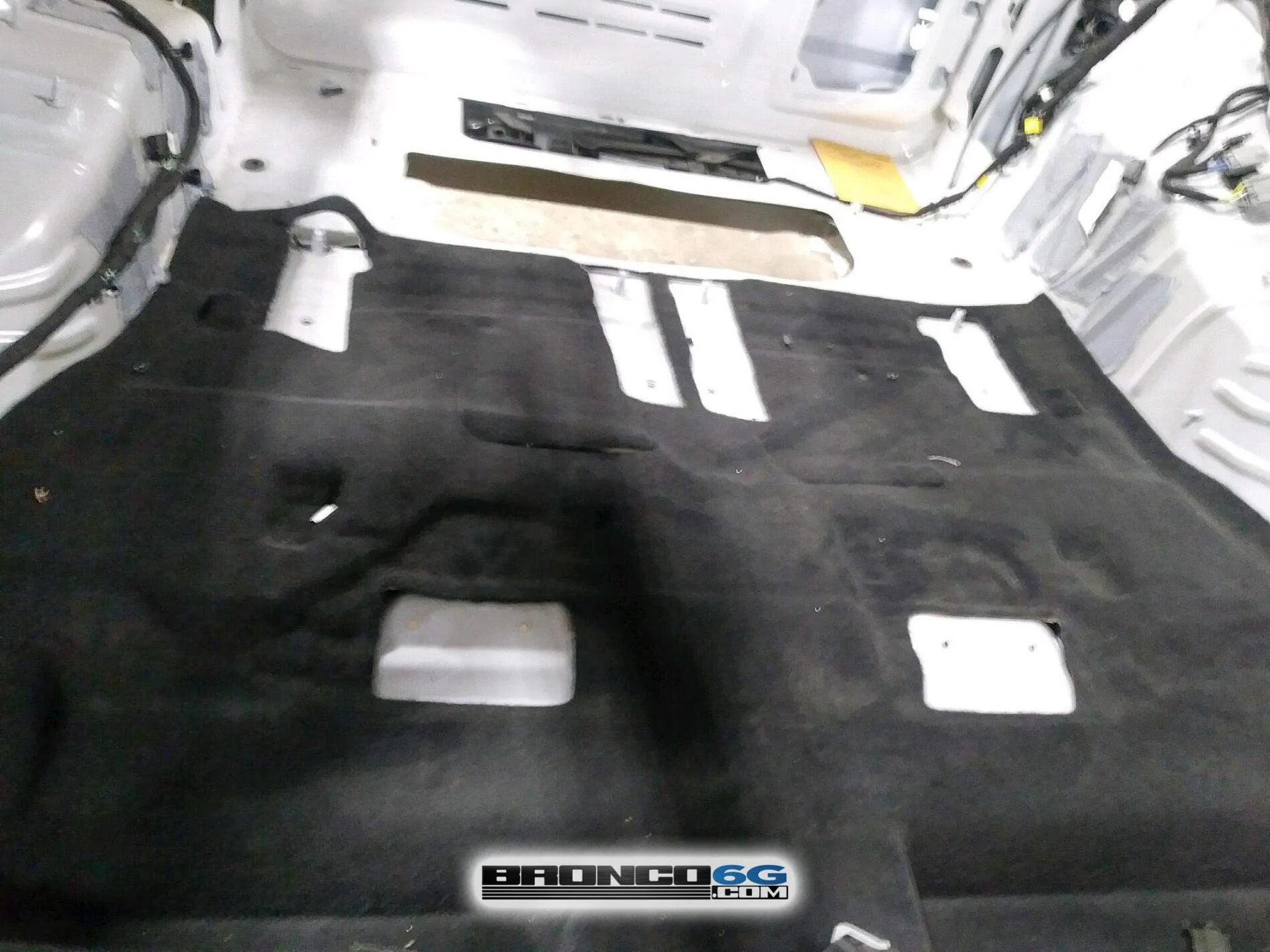

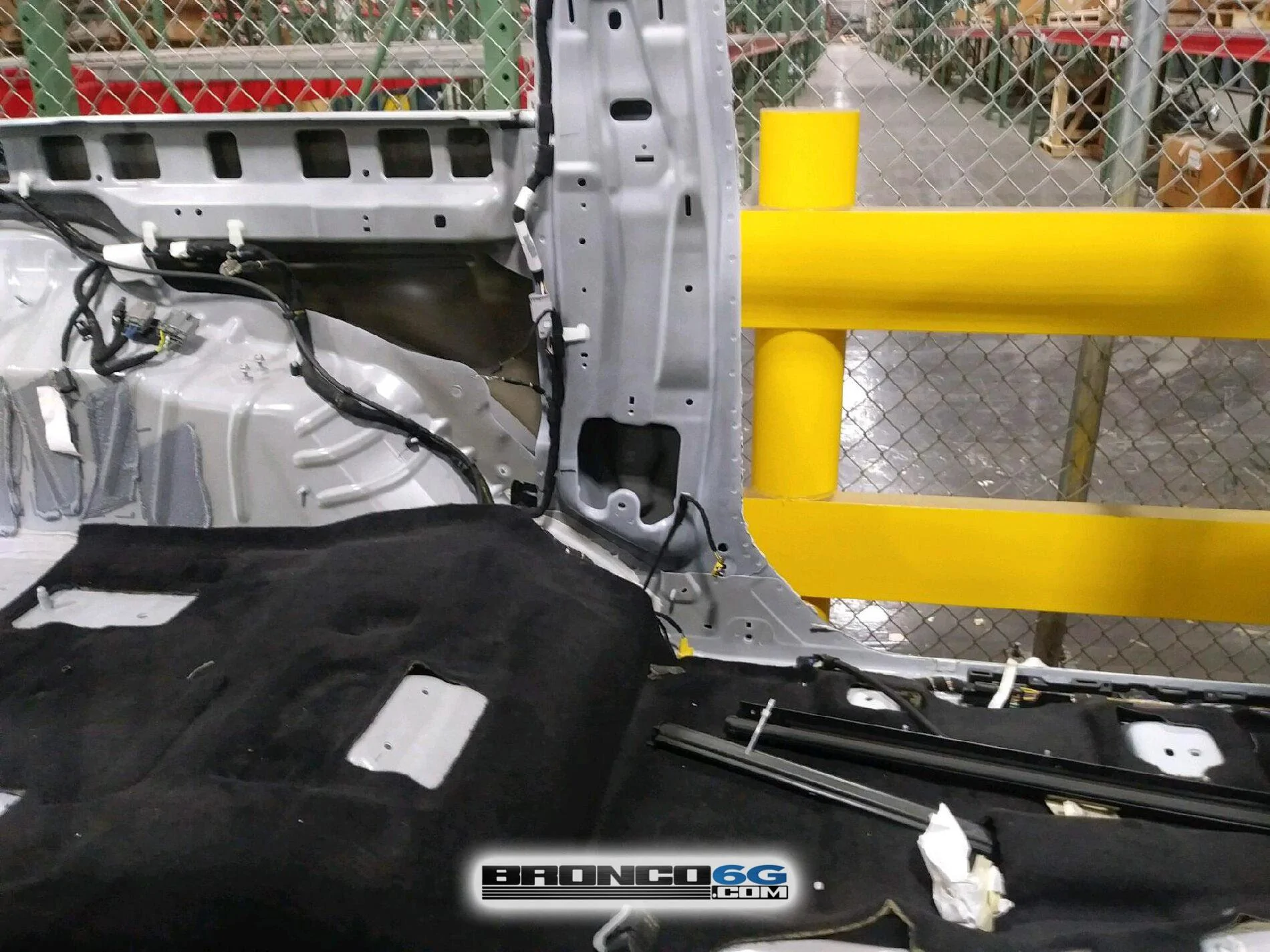

Did some more digging on this, and found the thread I was thinking of from a while back showing those bare-ass-naked seat mounting studs. First two pics are 2-door, third pic is 4-door. I think. (Ashley's original thread here.)
Ford Bronco Remove those back seats! 2021 Bronco parts wiring 1
Ford Bronco Remove those back seats! 2021 Bronco parts wiring 6
Ford Bronco Remove those back seats! 2021 Bronco parts wiring 2

Those were clearly taken with Stig's super high-resolution Spy Tater, so it's hard to make out any real details other than their height and placement. But looking closely at the 4-door pic, it almost looks like the studs might be threaded into the floor panel, as opposed to welded. Is… that a thing? If so, having the studs be removable would be ideal.
EDIT: Nevermind. I see that has likely been answered in the thread I linked. It's been a minute since I read through it, so I forgot about that.
