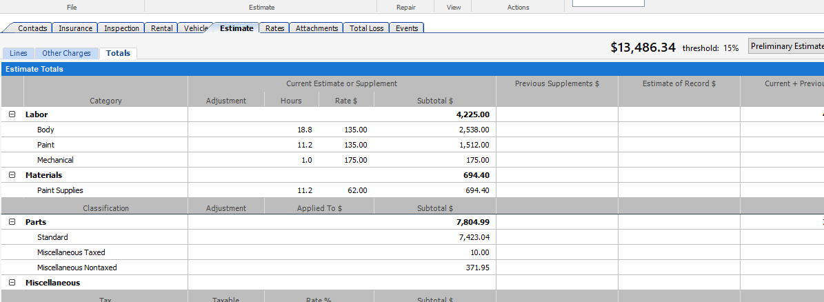

Now as far as repairs go, I work in the autobody industry. By the looks of the vehicle it is likely repairable. New fender, RF fender flare, RF fender liner RF door, RR door, RT Running board, RT QP flare, hard to see RT QP extent of dmgs besides flare, tire(s), wheel(s), RF lower control arm, 4WA can be seen as of now. Possibly some other suspension but will need dis-assy for that. I wrote a prelim estimate based off of this (photos you uploaded) for you and its around $13.5k and showing only at 15% of threshold total value. This is also based off of higher body and refn rates due to the fact I didnt enter an insurance carriers rates which are lower. You'd have to add about 30k more to total this thing. Either way best of luck in whatever happens :)
