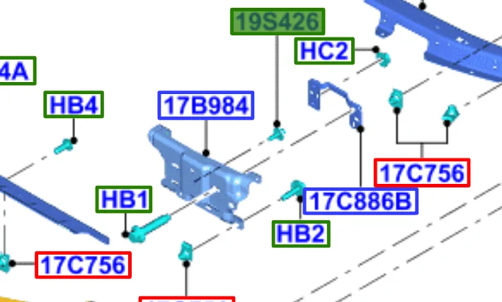

https://www.ruxerparts.com/oem-parts/ford-end-cap-bolt-w721180s450b
https://www.ruxerparts.com/oem-parts/ford-reinforcement-bolt-w721447s900
The W72221447-S900 is the bolts marked as HB4, M8 X 23MM. The first link is the bronco bolts marked as HB3 in the pic. and M8 X 30. I really don't think 7mm is going to make much of a difference in the grand scheme of things.

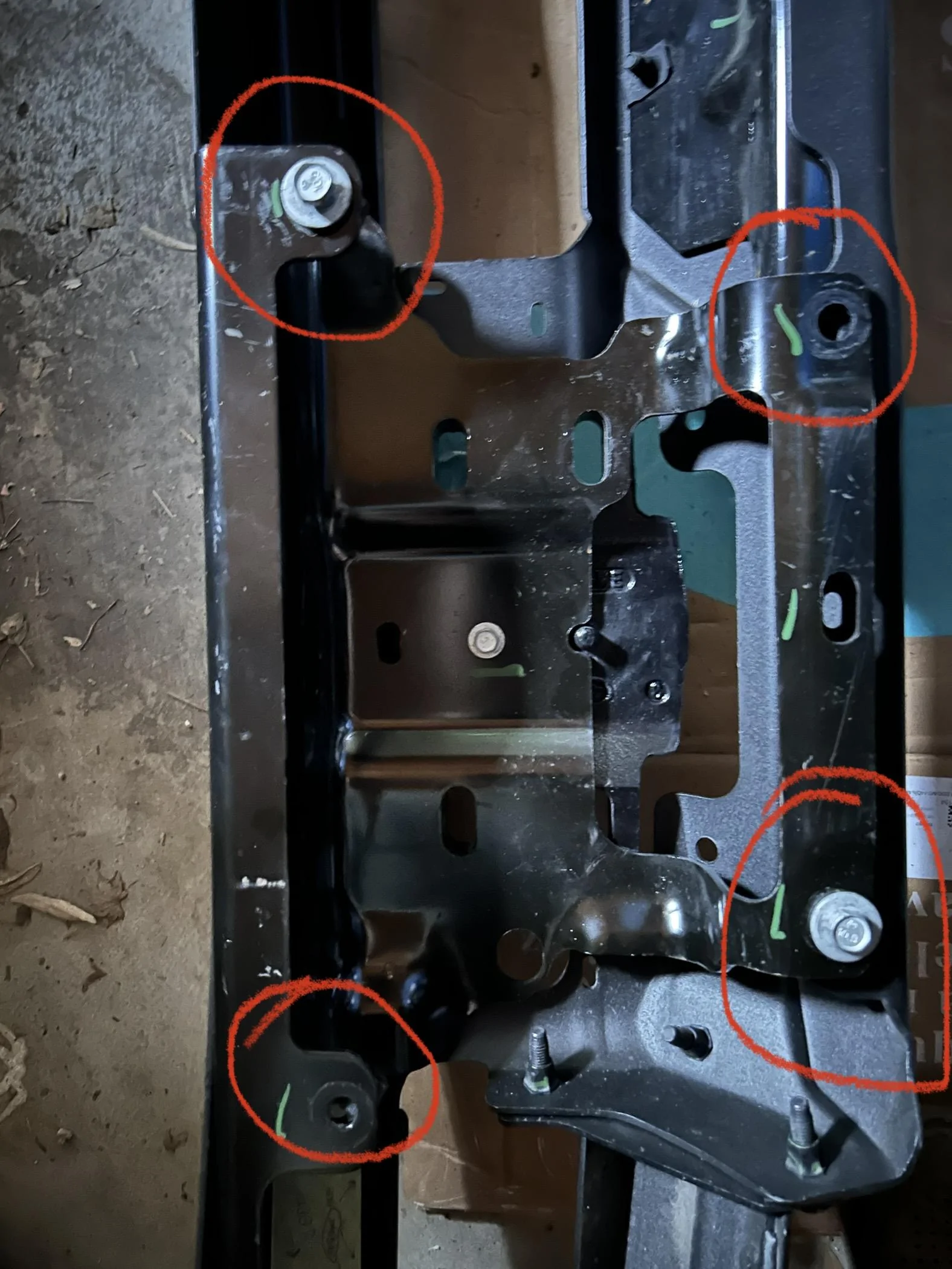

Does anyone know the part number for the bolt marked "HB2" here?
It seems like I need 4x for each side but don't have all 8
flip
Base Sponsor (Level 1)
Phil
4,312
14,287
IN
www.ruxerparts.com
Fords
Edit: I think this is it -- W500741-S439
HB2 is W717964-S450B BOLT, M8 X 29MM
ar1
Jan 7, 2022
117
61
Norcal
4dr WT
Hm
Hmm - there seem to be two bolts marked HB2 in that diagram. I'm looking for the one that connects the four corners of the hook bracket to the bumper frame. I think its a 14 or 15mm
