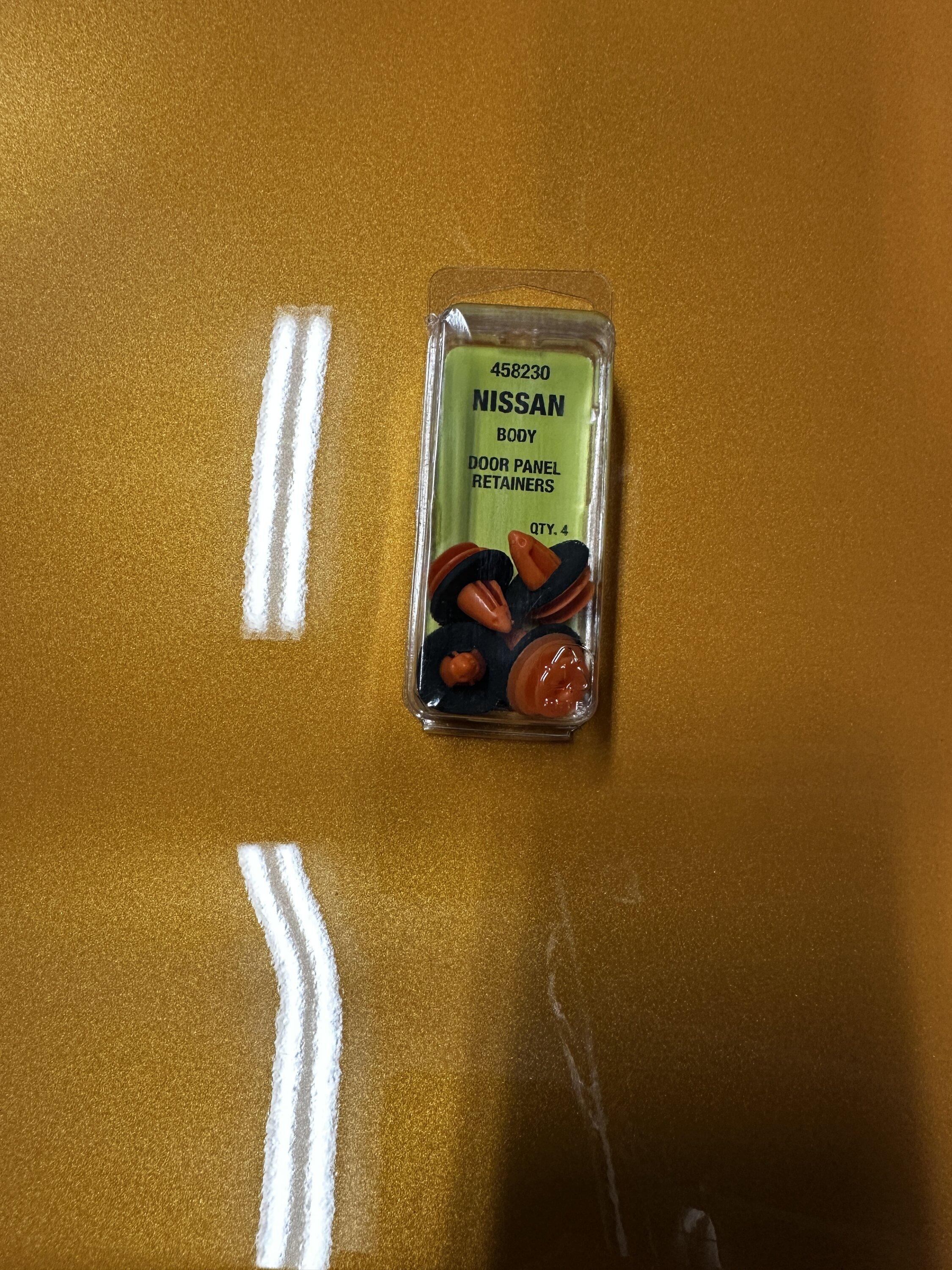

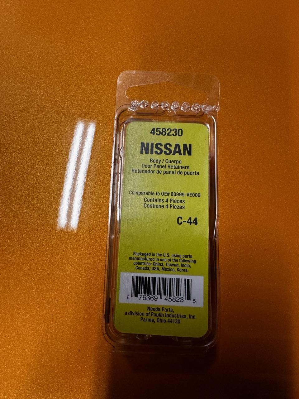

By chance do you have a part number?
Might want to check the subwoofer rattle TSB thread first, but I think these are the ones I used and they worked.
Ford Bronco Replacement clips for rear side panels IMG_5131
Ford Bronco Replacement clips for rear side panels IMG_5132

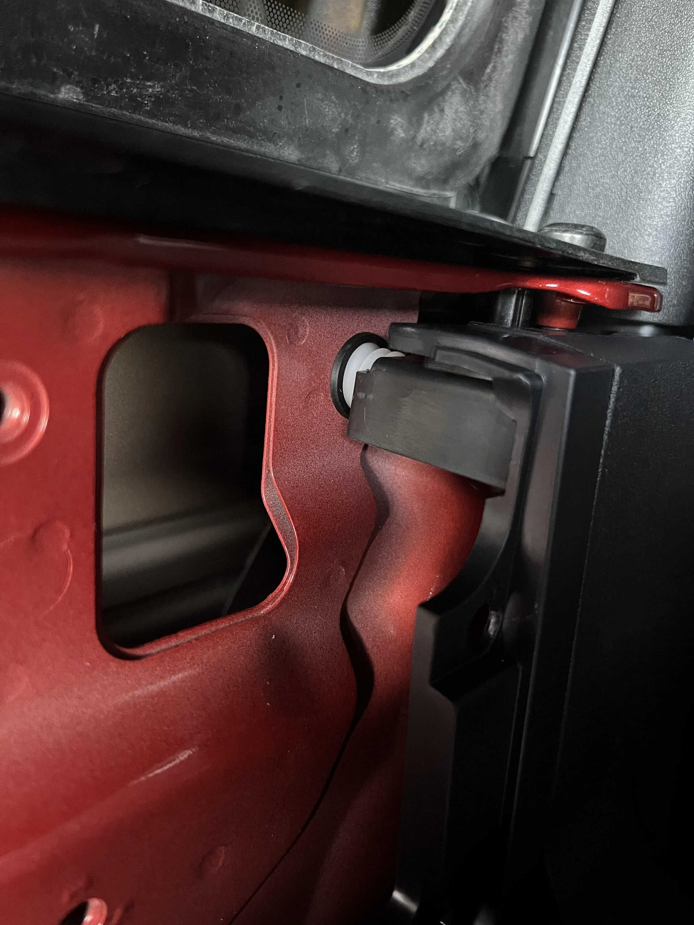

Yep, used these as well and they actually work better than the original “split” design fasteners as the part that plugs into the metal hole is a single piece not subject to breaking off like the flanges on the original fasteners. Despite trying to separate the original fasteners when removing - three on my drivers side panel broke and needed replacement.
