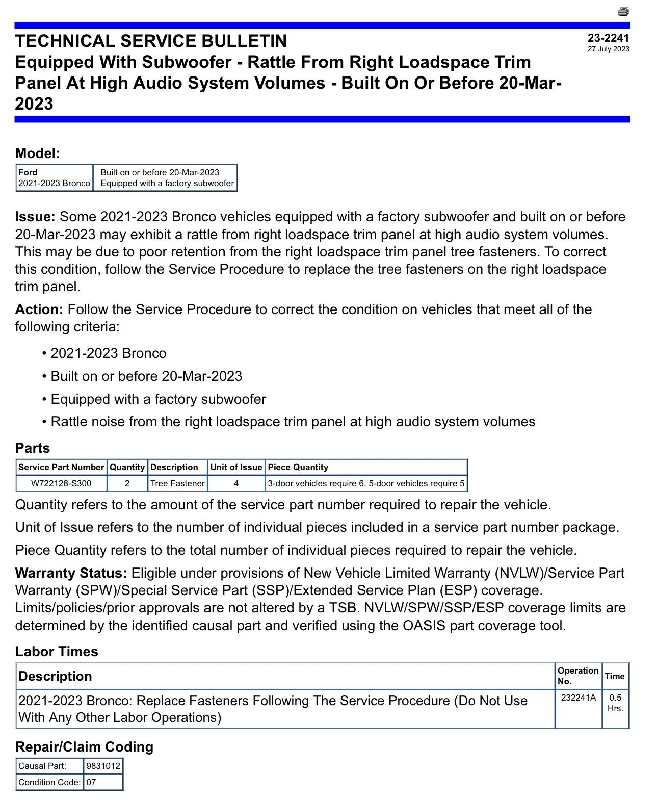

Brought my 23 in for another repair and they checked the subwoofer rattle. Came back with TSB 23-2241 for the rattle. I searched on here and online but don't see it mentioned anywhere so I thought I would pass this along since many have posted about it. Parts are on backorder.
Thanks Ducati1098 for the screen shots.
Ford Bronco TSB for subwoofer rattle issue, 23-2241 1691012325581
Ford Bronco TSB for subwoofer rattle issue, 23-2241 1691012382678

was that online somewhere? looks better than a phone screen shot :)

Yeah just a cropped screen shot of the TSB
your google skillz are better than mine. could you post the link so i can edit my original post?
I work at a dealership lol here you go.

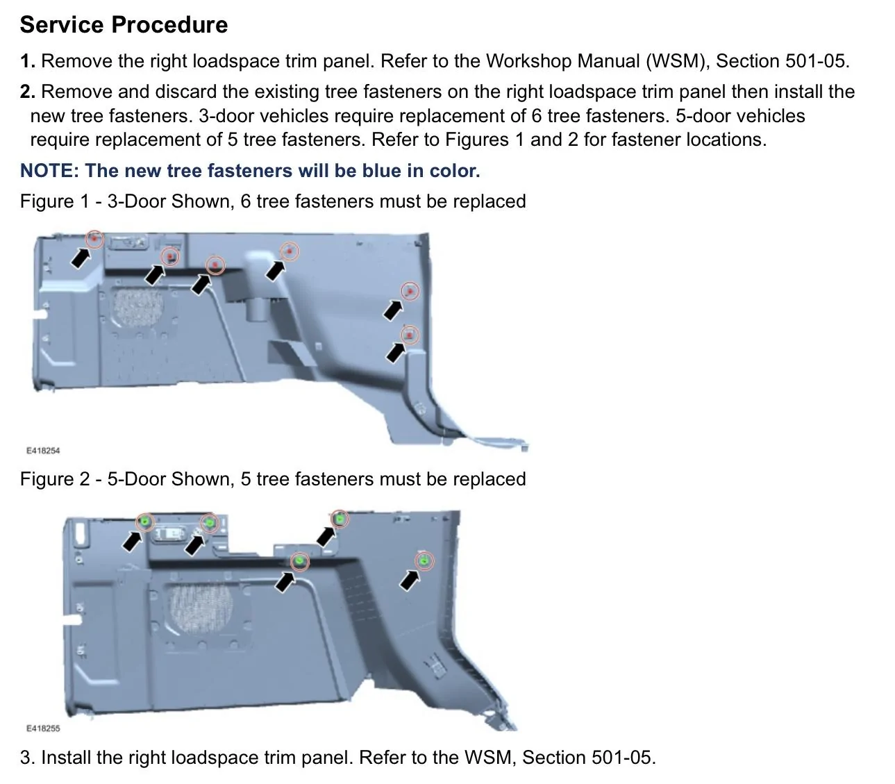

My panel has blue 1 piece fasteners instead of those white 2 piece ones that everyone reports issues with. I wonder if those clips being 2 piece are causing this. My 2D was built in April with the deleted sub, though.
Also, interesting to see that there's a spot for a clip at the 90 degree bend toward the door jam, but this doesn't show it being replaced. When I took my panel off, I thought I lost that clip, but I guess it just doesn't exist?

Ahh, guess that helps explain the "why are these trees blue instead of white" question that was posed by pics from someone's Bronco here. Thanks Ducati.
