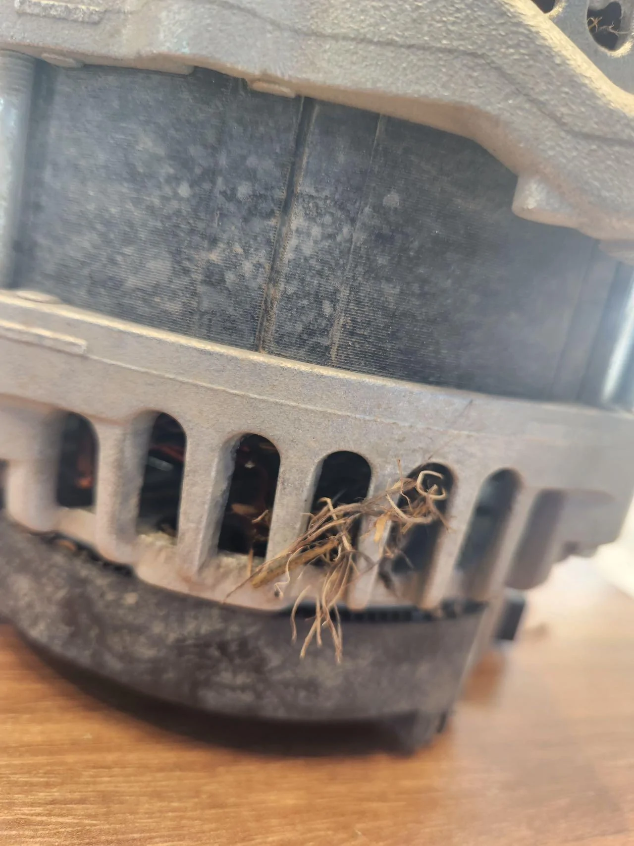

So apparently when I killed the alternator in the mud, it also wiped out 2 or more pulleys says the Tech note. The alternator was covered under warranty but the pulleys won’t be ffs
They want to replace the three idler pulleys and the tensioner. When I asked why they don’t just replace the ones that failed instead of all 4, the advisor looked at me I was in the wrong and started humming and hawing. Guess it’s too much work to diagnose properly. Ford said they couldn’t reverse the judgment due to the Dealership saying it had too much water/mud to be warranty eligible.

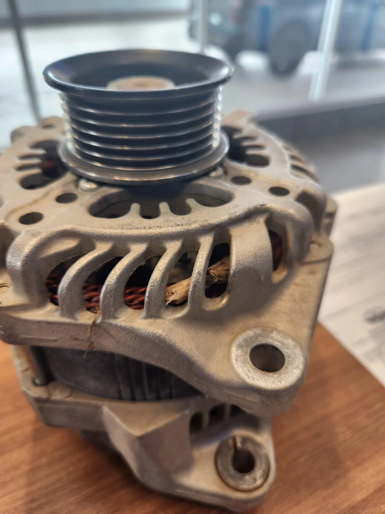

just want to make sure If there is something wrong with Bronco alternator, with TSB, should all repairs be covered by the warranty?
After checking my alternator, the dealer said that the problems caused by the rocks, grass twigs inside were not caused by mud, and were not covered by the warranty. Then I took out the TSB to them, and now the dealer said that they are finding solutions to see how to solve it.
not sure how you got twigs inside of the housing, but bet you had fun doing it :cool:.
If you don’t have twigs in your mud, you’re doing it wrong. :cool:
Besides, why just take a bath with water when you can enjoy a real mud spa?!? ;)
