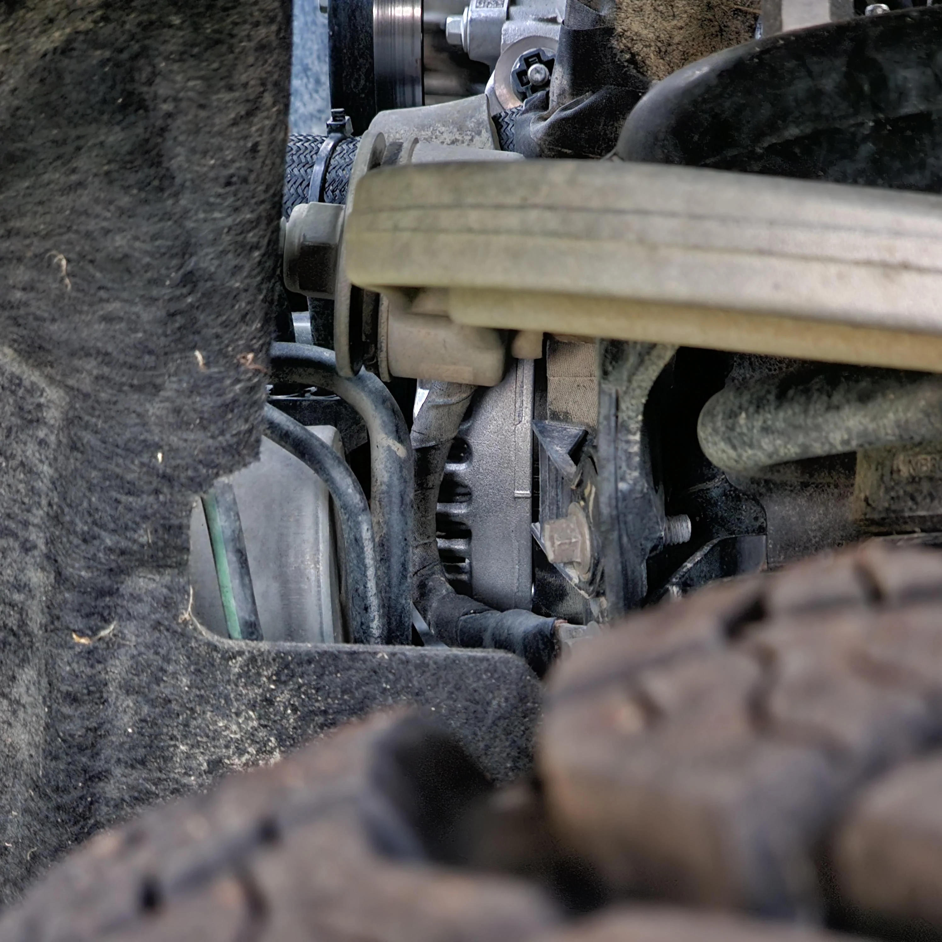

Not even close to that deep for me. I was spinning to throw mud everywhere. Finally got it back today. I must say my service writer has been awesome with ALL the crap wrong with my Bronco.
Take a look at the view of my alternator from my wheel well. Ford needs to do better!

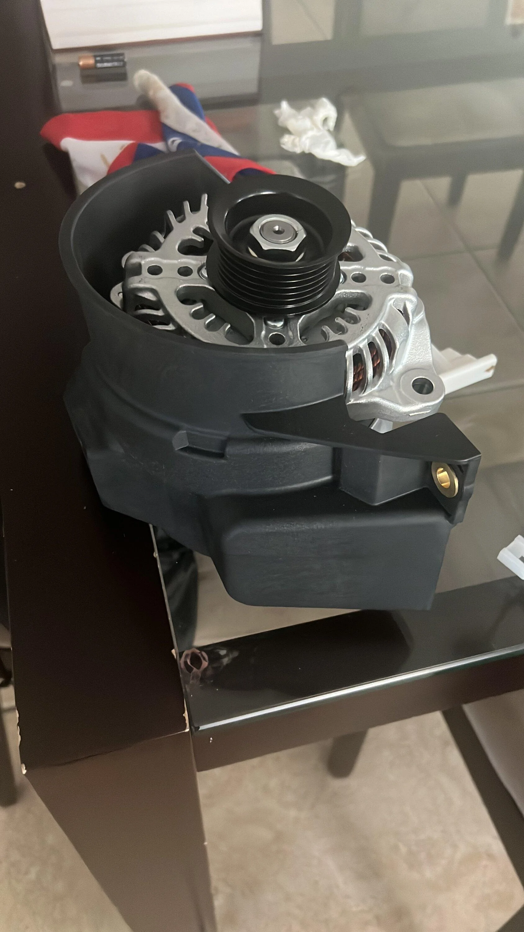

I still think a filter sock over the Alt may be the real fix. Just need to figure a way to make sure it doesn't touch the pully/belt
It's just going to melt and then you got bigger issues.
You think? I mean these are designed to be ran inside a hot engine bay. Or the exhaust so close to the alternator that it would cook it?

On the alternator it's coming into physical contact with hot metal. The alternator gets hot an air filter does not.
