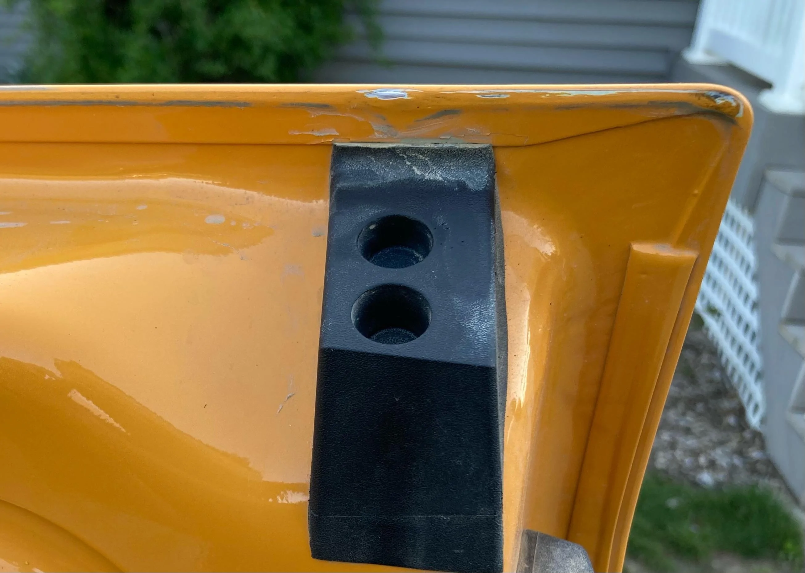

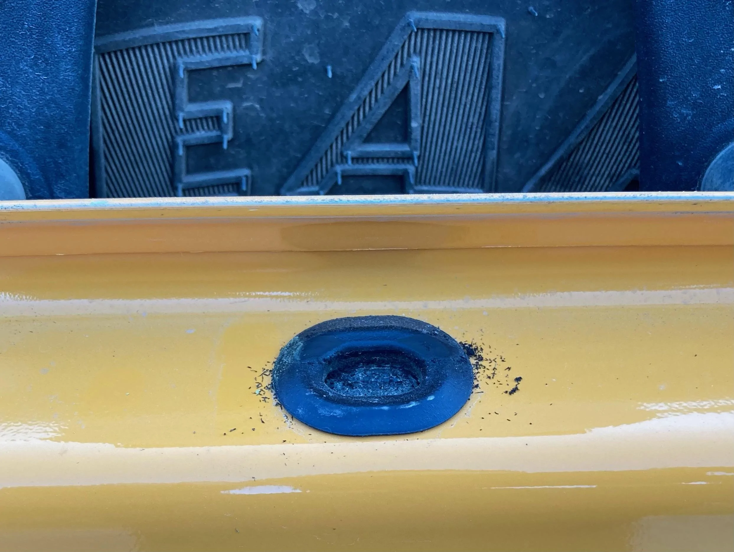

I had the same thought, that the paint wear could be caused by dirt or soaps. But it finally made sense to me once I started noticing small pieces of black rubber debris on the top of my tailgate which was wearing off of my window seal. My dealer replaced that window seal at the same time I had the TSB completed, at my request because it had worn down a significant amount.
