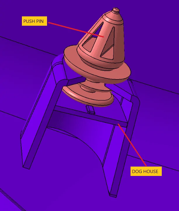

Does anyone know where to purchase these clips? This is a picture of the rear panel.

I think it's this however the diagram does not show that specific location.
W721378-S300

These look closer... but not exactly the same.
Ford Bronco Replacement clips for rear side panels pins
In the old days, we called these Door Trim Dog House Pins
Ford Bronco Replacement clips for rear side panels doghouse
I'm guessing that rubber ring on the pin is for preventing squeak and rattle. Good luck with it.

I wouldn’t remove one of the rear quarter panels without having some on hand. I broke one on both sides and I was very careful with proper diagrams and trim tools.
W721378-S300
I think your right, I ordered that part # but haven’t gotten them in yet. They show as the Bronco as being the only vehicle they are used in, so of course they are slow to be available. At first I ordered the other clip on the parts diagram, W718240-S300, but those are the orange one piece that are also on the panel. Those should be hard to break.

What diagram are you referencing? Can you post it?

Tried those. They are too big and one piece, not two piece.
