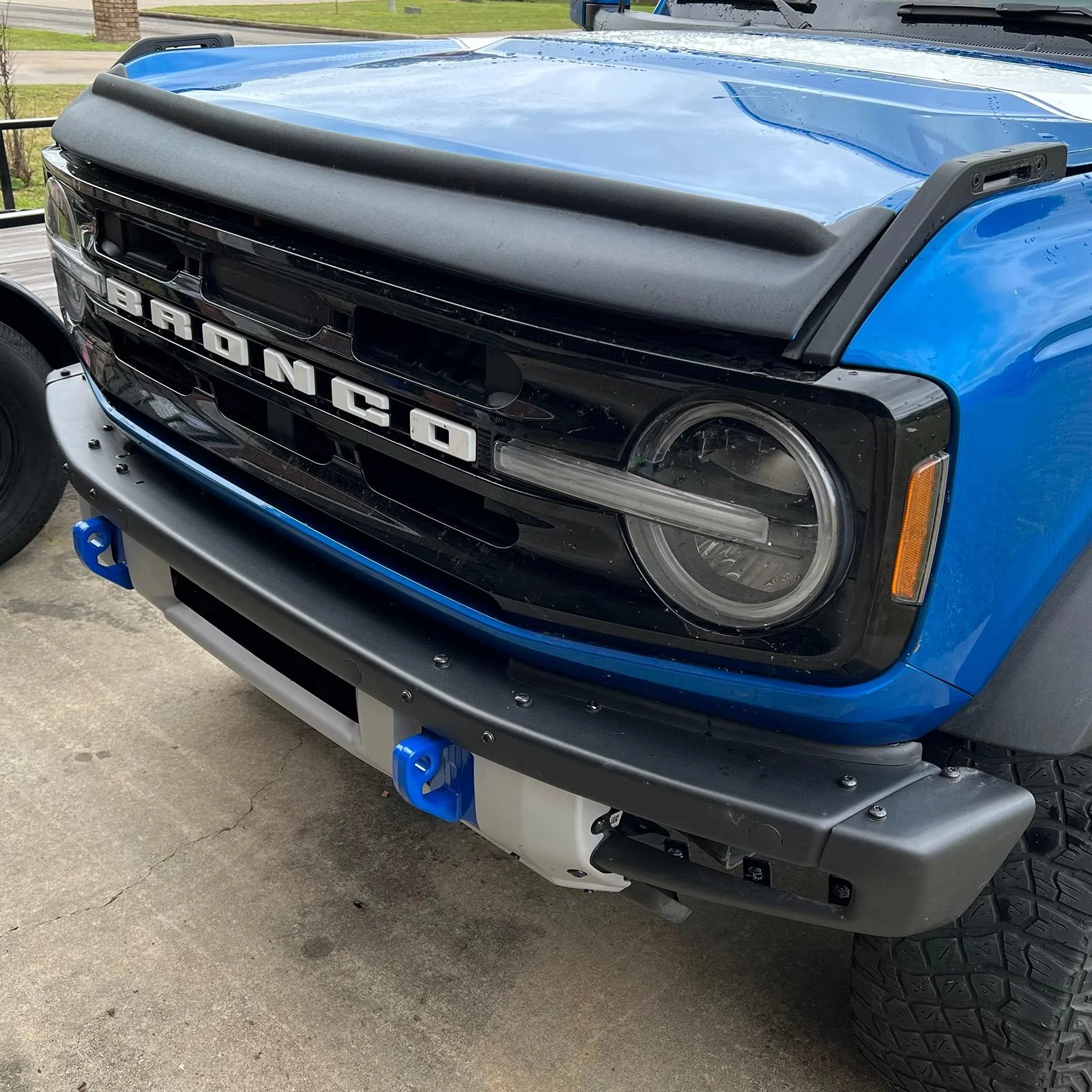

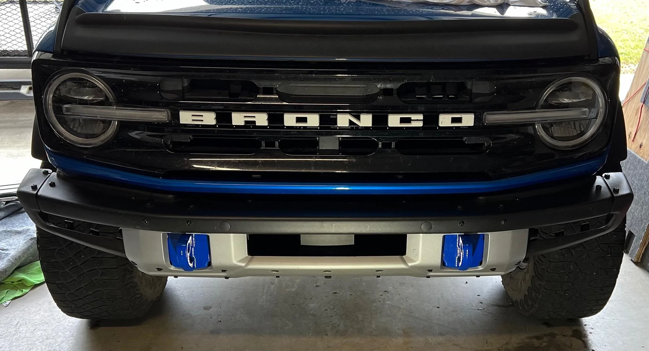

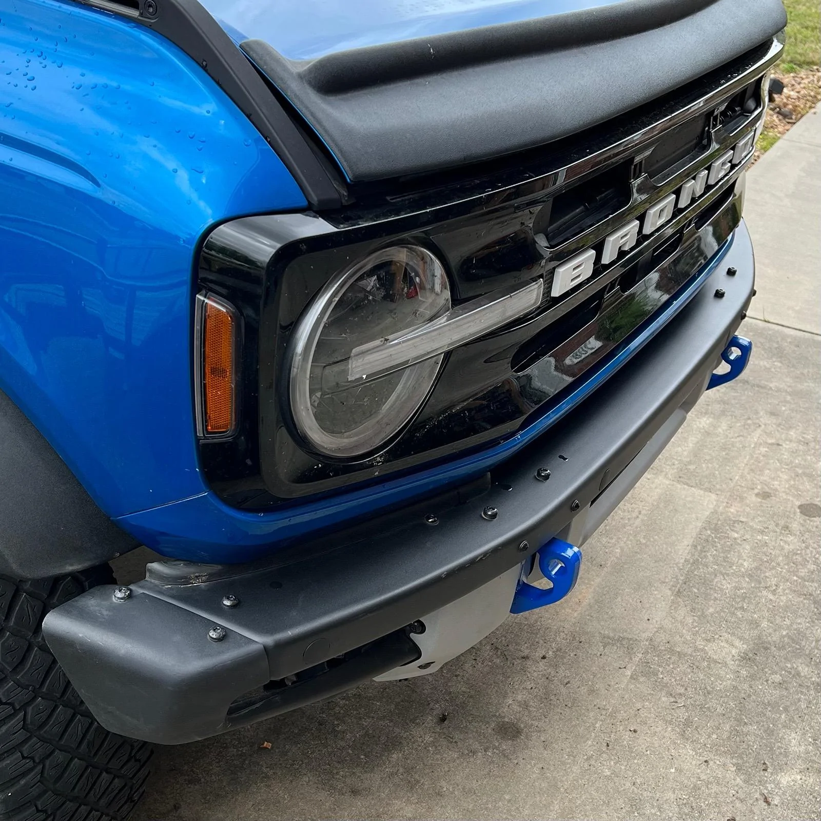

Finally got it done!
Ford Bronco Replacing factory bumper with modular bumper IMG_9780
MaestroFlores
Ricardo
Dec 14, 2022
San Jose ,CA
Ford Bronco
Swapped my standard for a modular one. I installed a bull bar and KC rally lights to replace my fog lights. I don’t have sensors so I have to find plugs for the holes. Anyone know where I can get some?
