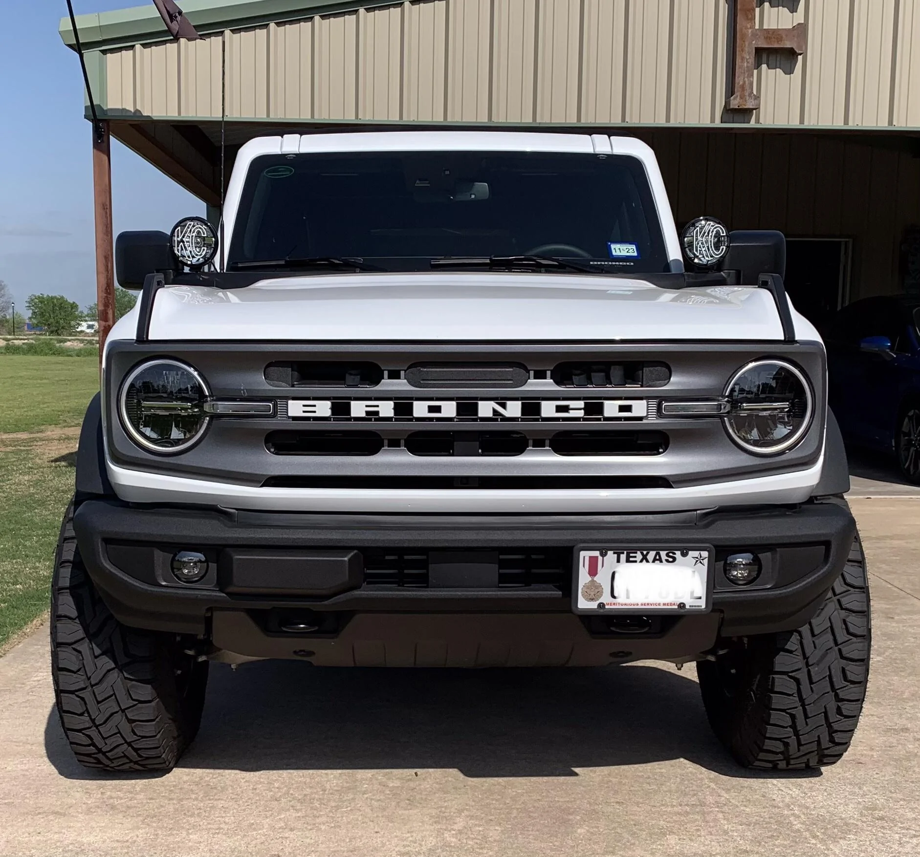

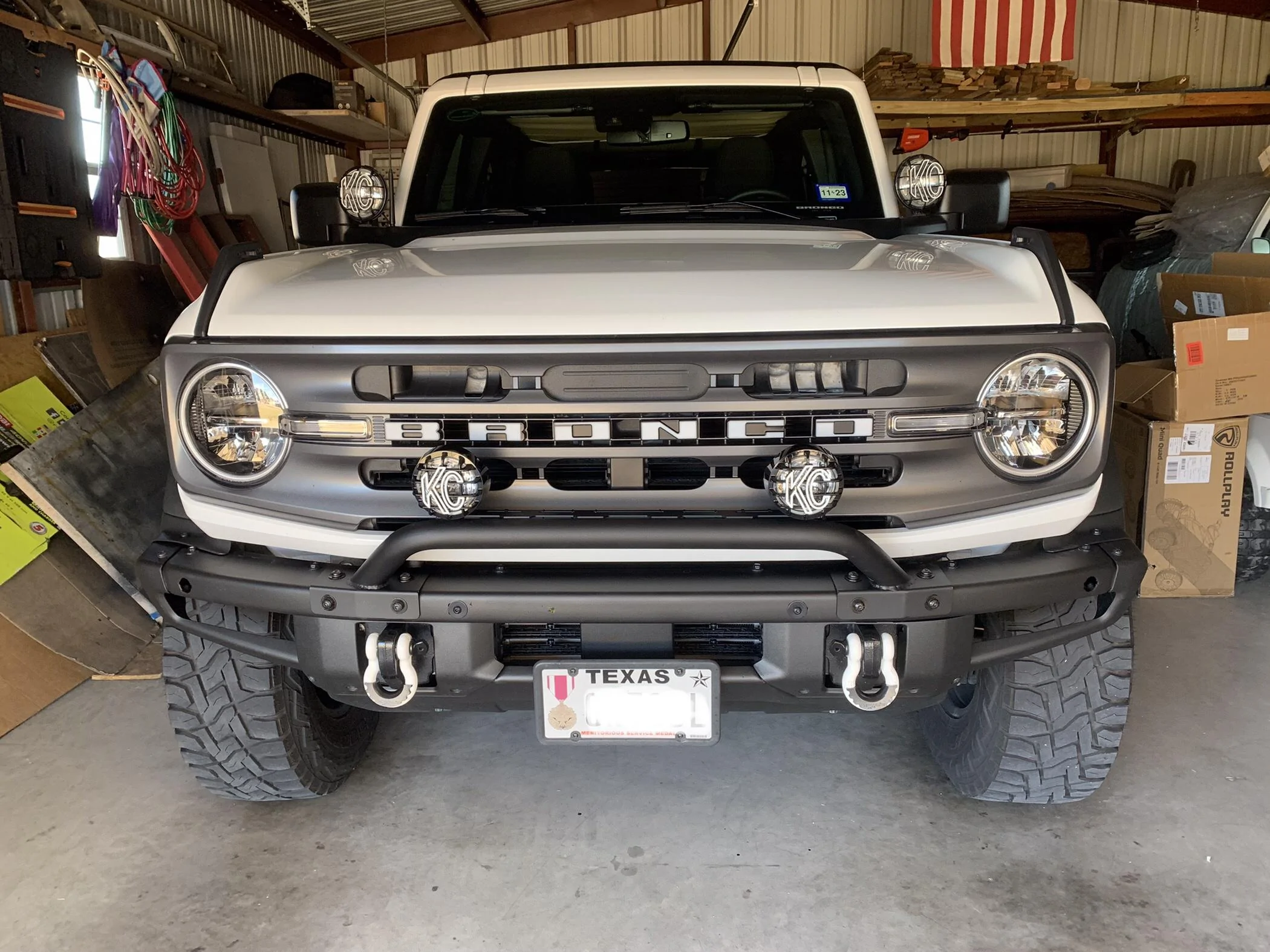

Swapped my standard for a modular one. I installed a bull bar and KC rally lights to replace my fog lights. I don’t have sensors so I have to find plugs for the holes. Anyone know where I can get some?

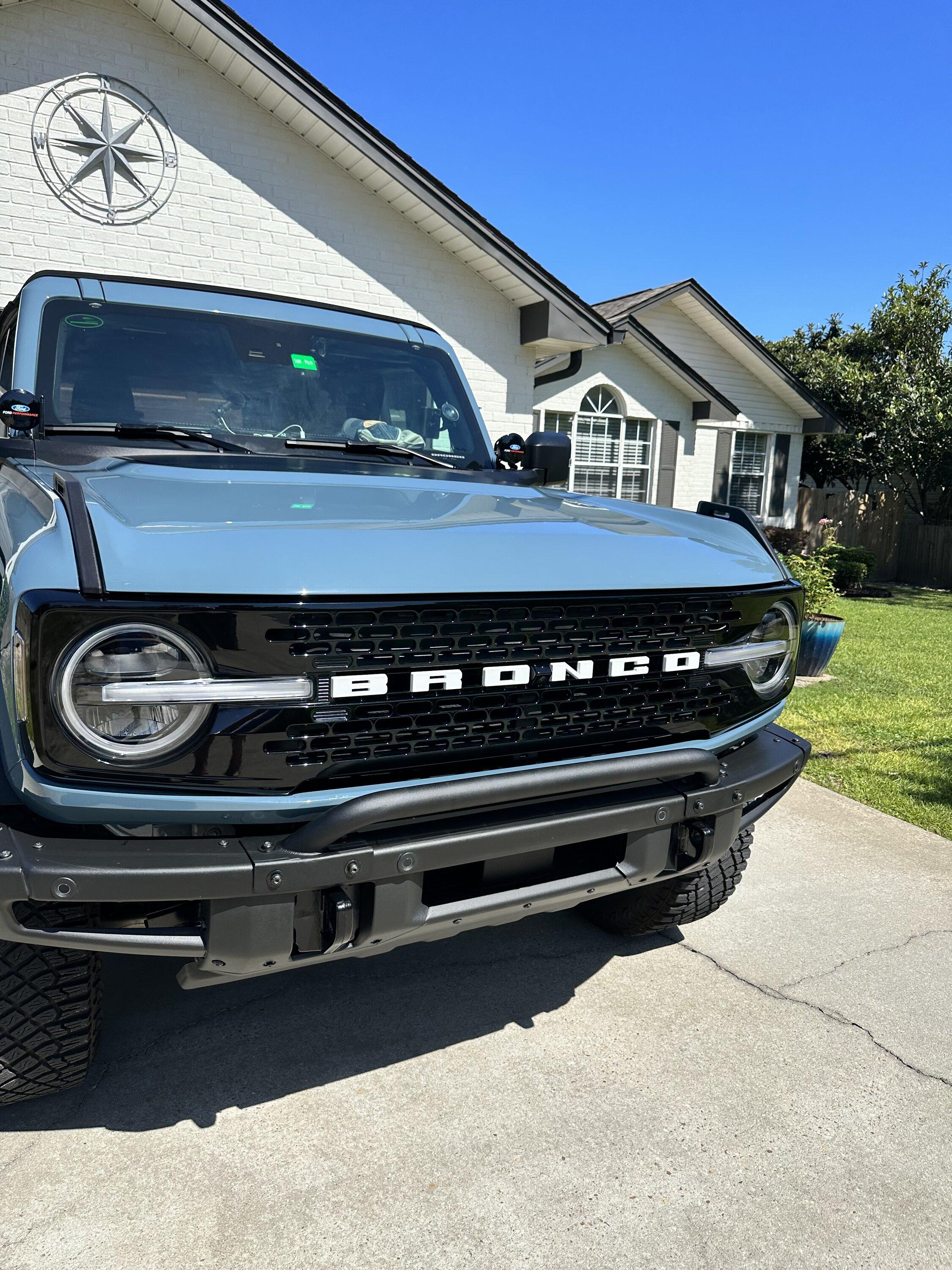

Here are some pics, we are getting close. Just missing the plastic covers surrounding the recovery hooks on both sides.
Wow I love those lights, who makes those?
