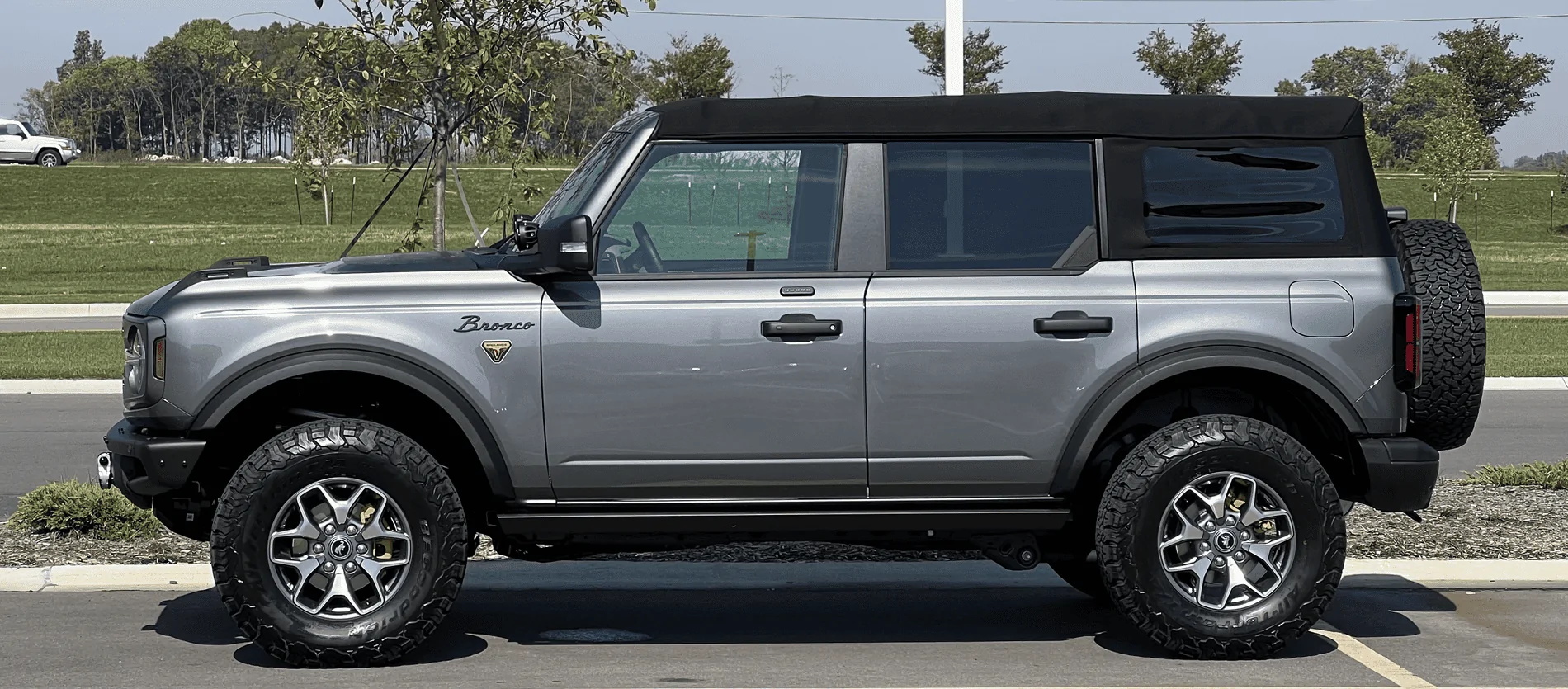

It seems to me the factory badges would fit and look great under the Bronco badge. Is nobody doing this? EDIT: I just saw the pic a few post up. This looks perfect!!

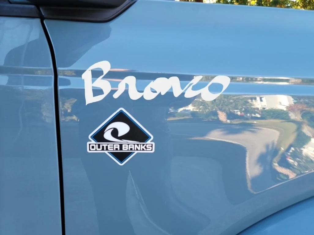

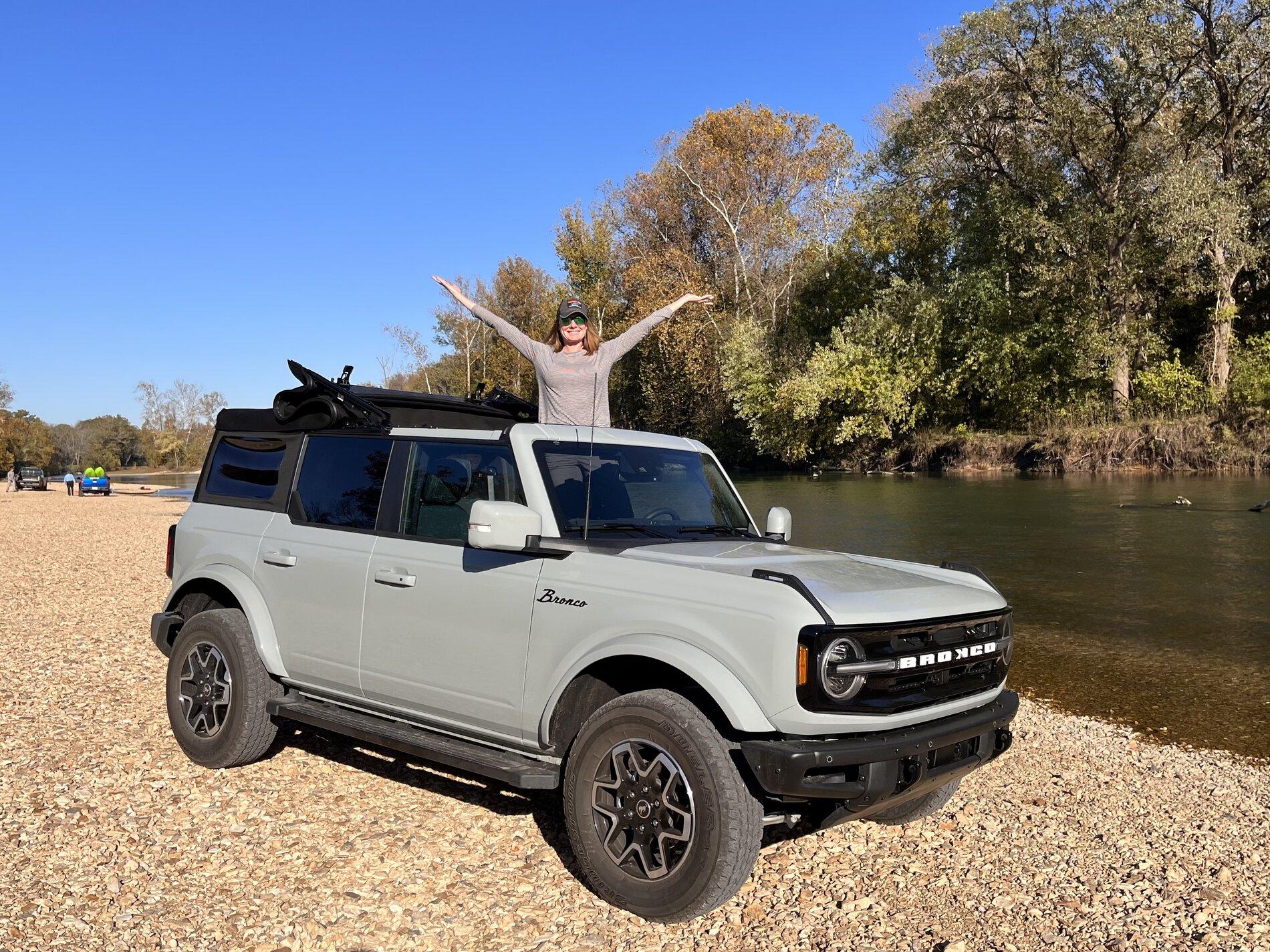

Once removed with a hair dryer, can the existing badge be re-applied a few inches down? How? I want the look of my former full size Broncos, where the BRONCO name was over the model name, same as SCOUT did as well.
Yes it can be reapplied after removal. Hit it with some heat before you reapply it so it can flatten out, it tends to stretch a bit from removal.
