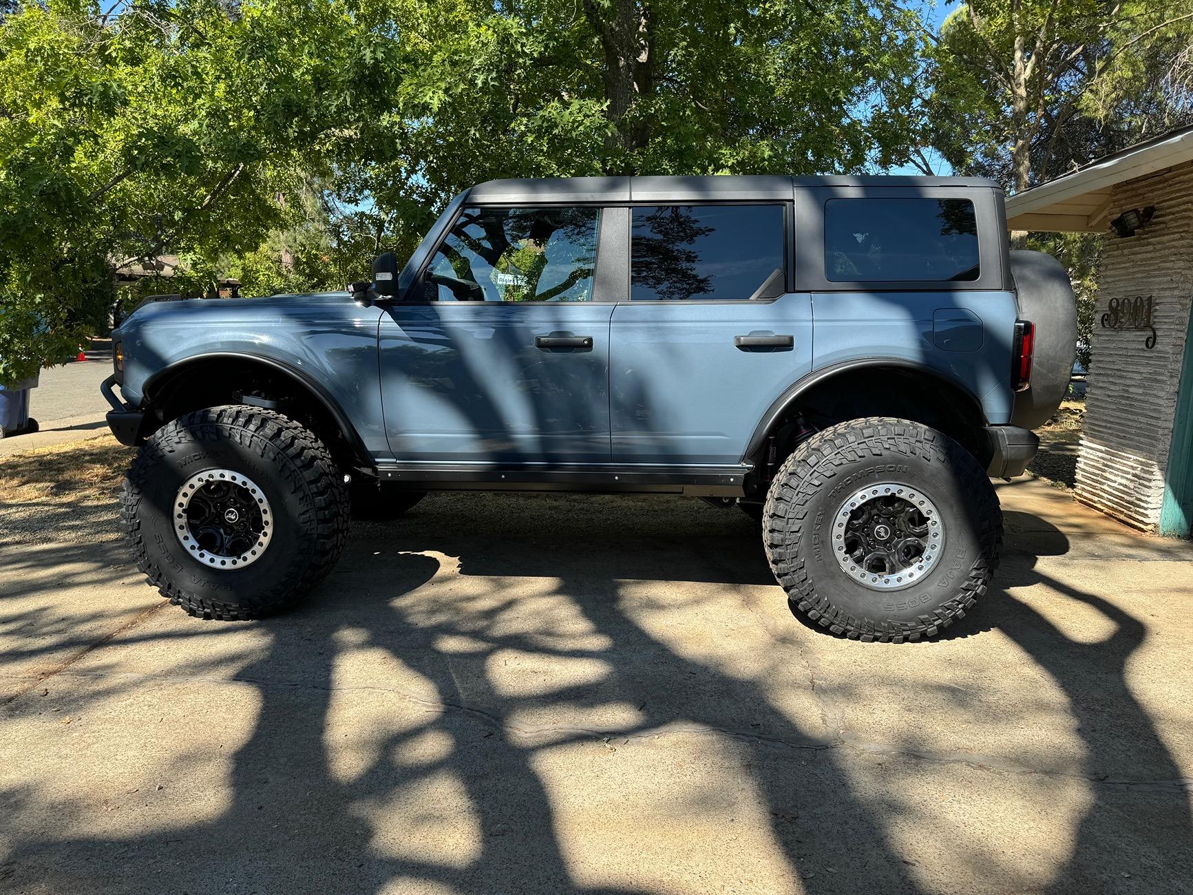

Rides very tight. I haven’t been off road yet. I have portals on a Badlands with no lift. Gained about 3”. Just squeaks into my garage. Gratuitous action photo.
