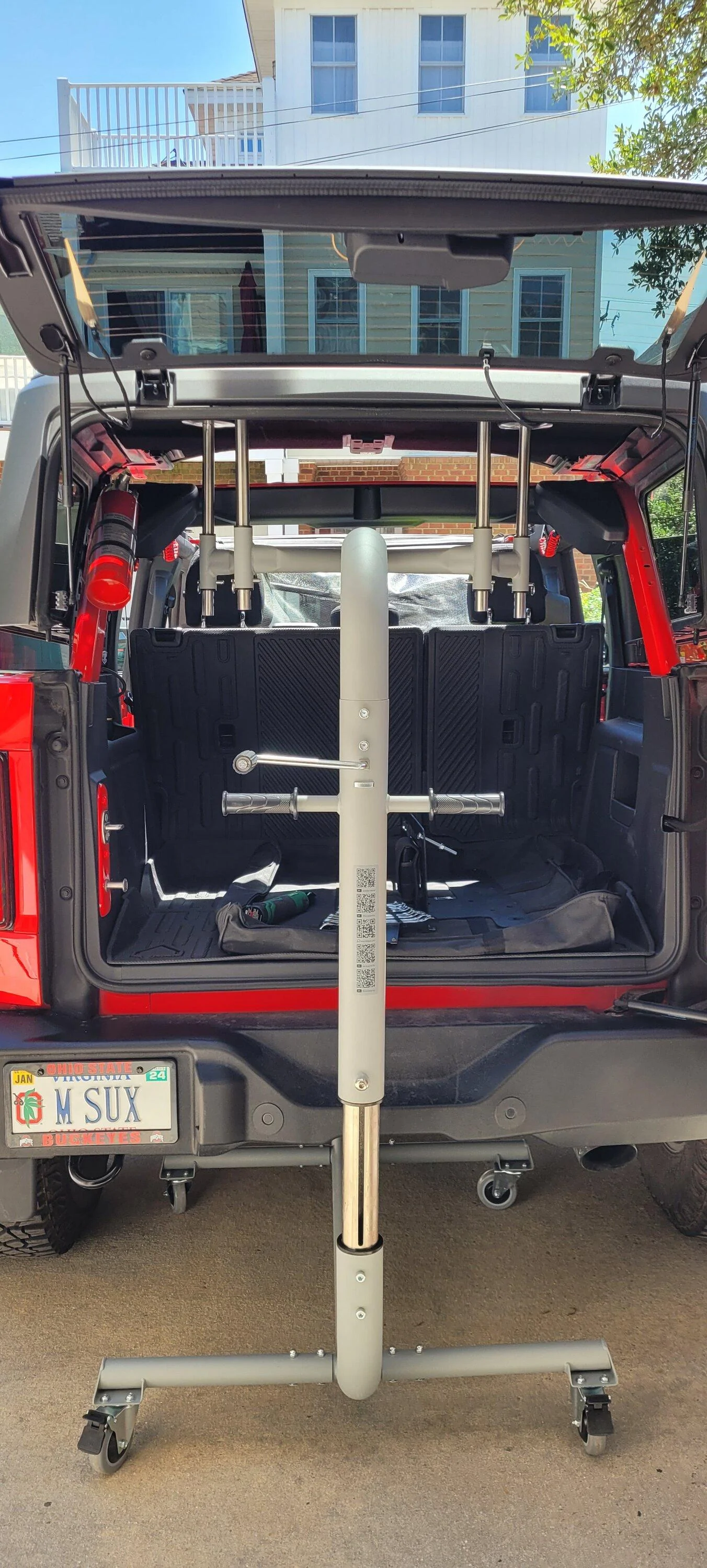

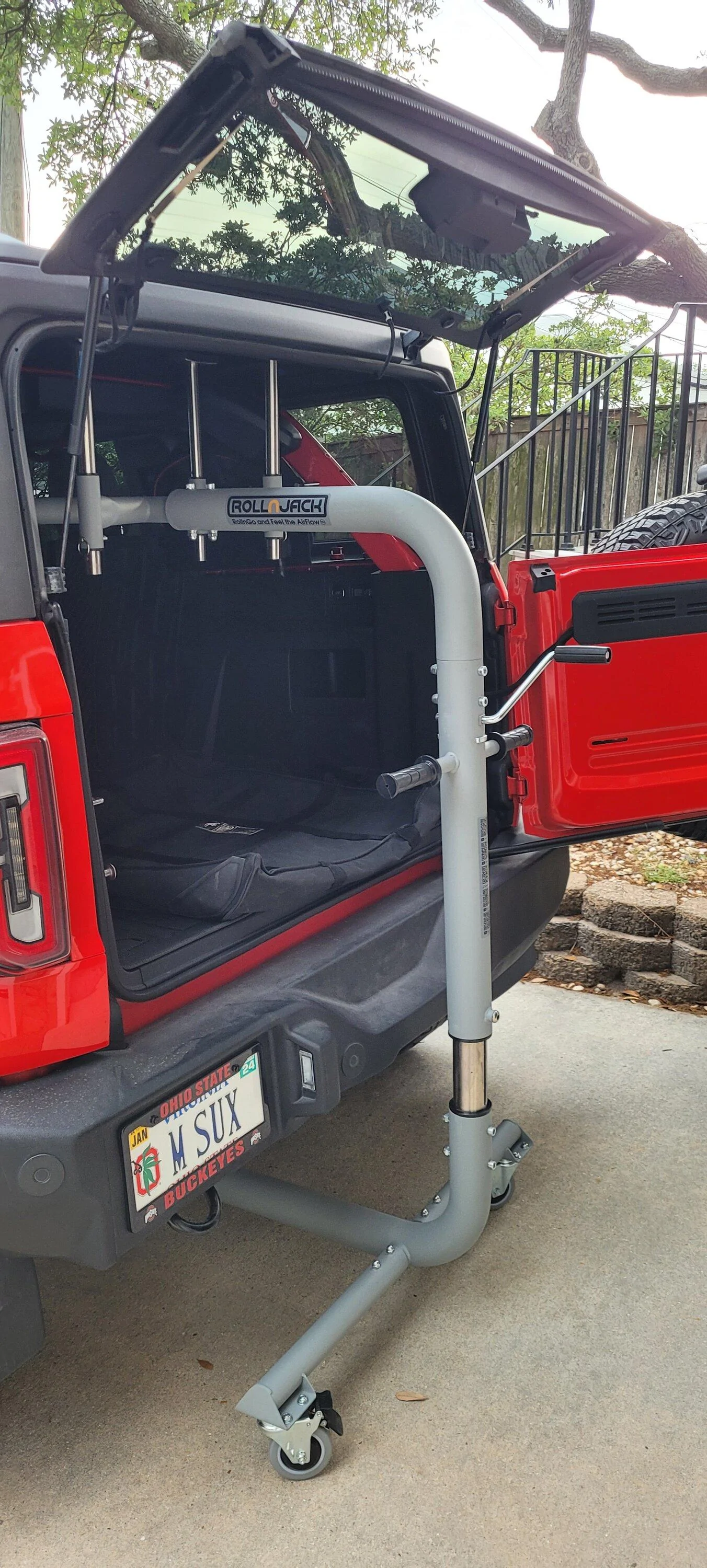

So you dont use the 5th (4-door) post?

I have one too and love it! I don't use the fifth post, nor did I get the half moon posts that they recommend.

Yep, same don't use the forward post. I did end up cutting the supplied post into 1/2 moons only to find it wasn't really needed :sneaky:
Nice easy controlled system & packs away easy enough 🤠

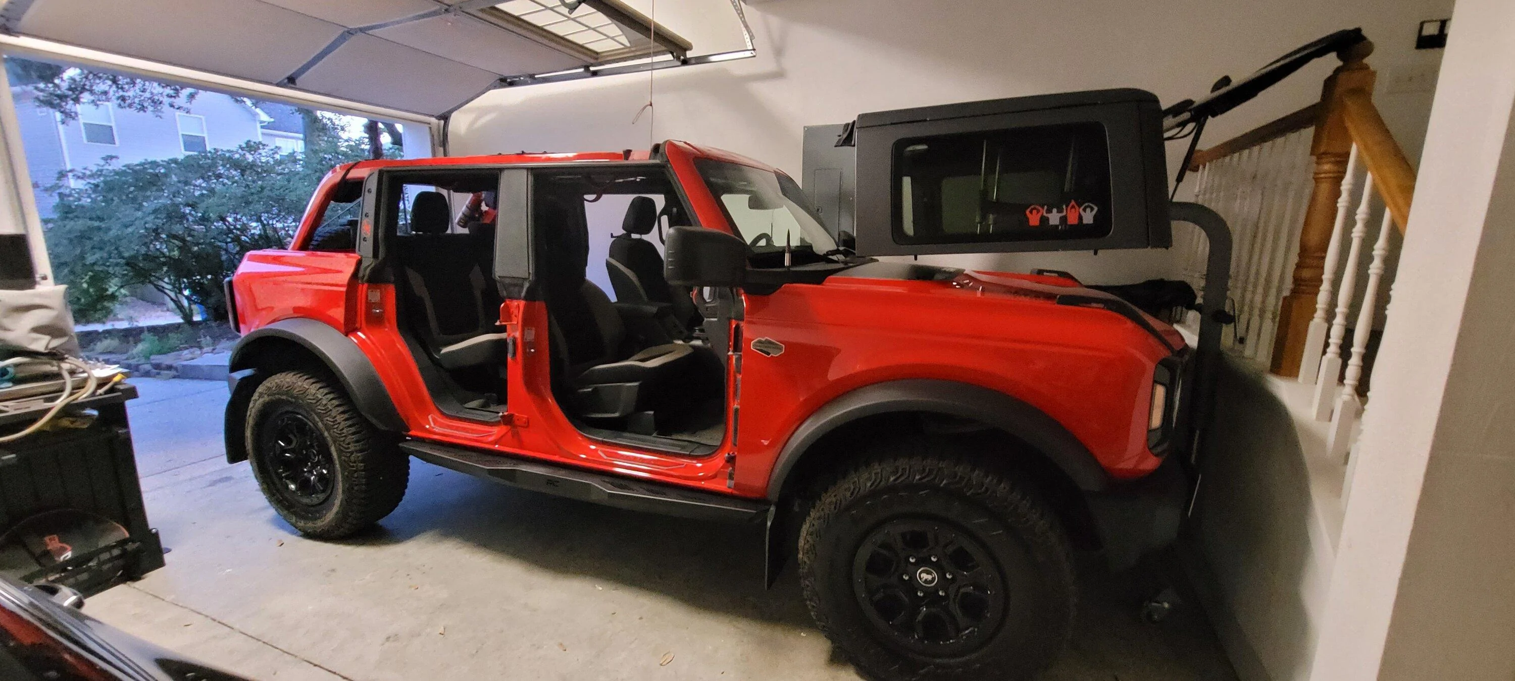

I can switch from hard top to TrekTop in about an hour anytime I want now. Most of the time is with the soft top install or removal.

I found in order to use the forward post, you need 2 of the half moon post in the back, because with ithe roll-n-jack pulled all the way to the back, the forward post just grabs the center latch point.
I do use the forward post for extra support, but only because my kids have been known to bump into it in the garage.
I do agree that it is plenty stable with just the 4 regular post and not the forward post under normal circumstances.
Other than the fact that they sell you 4 half moon post instead of just 2 for half the price, I have no complaints and absolutely love my roll-n-jack.

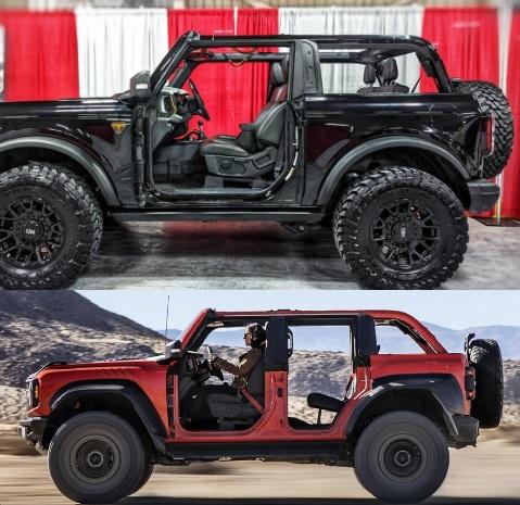

I think the sport bar rear cross piece you mentioned, is located further forward on the 4-door. So maybe it doesn't interfere as much with the lift contact points?

Yes! The bar on the 2dr, is right in front of the rear window. Right in the way.

@CapeCodCash I'v had both a 2-door and a 4-door. Much easier with the 4-door since there is no rear roll bar. For the 2-Door I used the same method. No way to get around it honestly unless you have a second set of hands. Also if you have 6.5" speaker pods you may want to wrap the pole in felt tape because there is contact (same with the raptor/fp rear brace).
