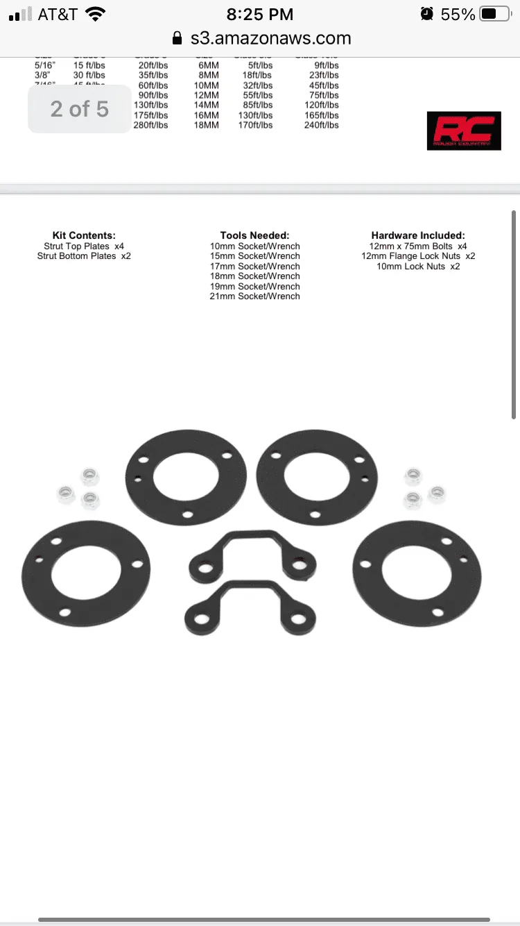

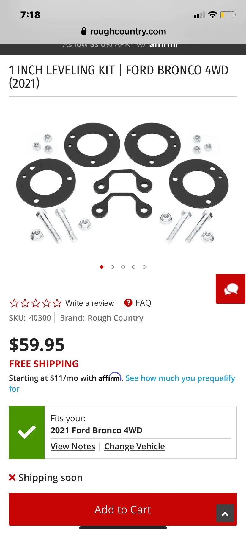

If the general consensus turns out to be that a 1" spacer will not cause binding on a BL, I would 100% get this with no qualms. A chunk of steel isn't going to go bad just because of the name on it. The double stacked spacers is a little weird but it won't hurt anything.
This is a good opportunity to flip those lower shock bolts to threads pointing up.

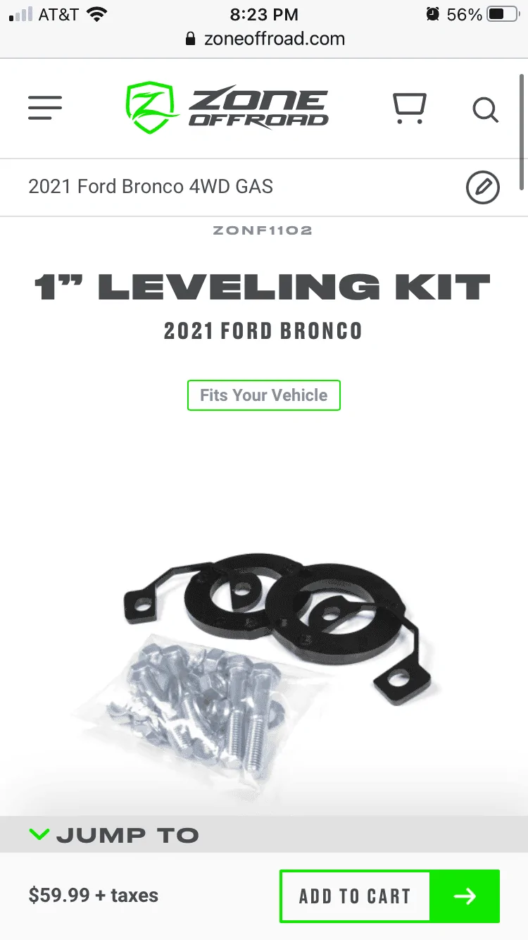

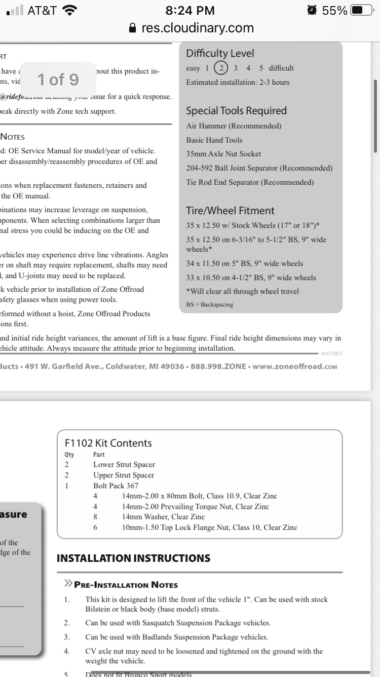

I’m liking the Zone 1” leveling kit more F1102. I’m all about the little details. Zone uses 14mm bolts versus RC uses 12mm. Zone also has a single upper plate versus the 2 stacked plates in RC which I think is weird. Zone also has a flange nut versus just a regular nut with no washer which I also find weird. For the same price I am thinking I am gonna do Zone. And way more thorough in their instructions.
Easy choice. For some reason I thought Zone was a lot more.
