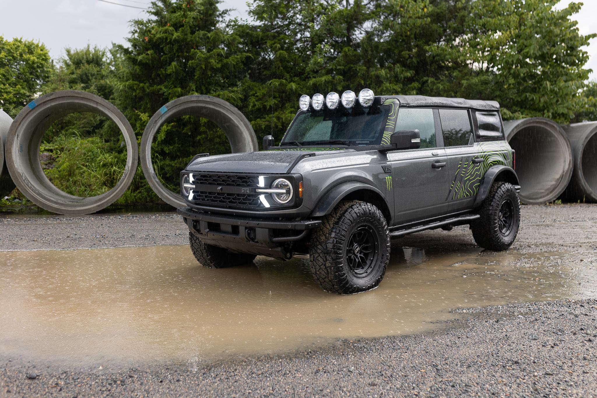

Monster Energy Bronco sitting on a set of RTR EVO 6 wheels in Satin Black. 17x9 +0

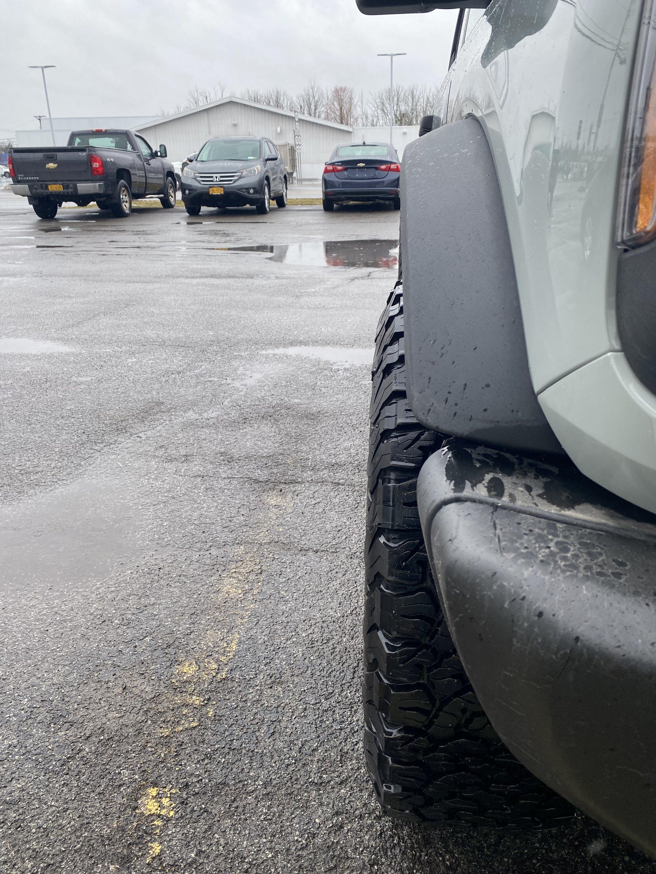

BUT he is going to 35s. He may have clearance issues with 35s at 30mm offset
Probably not, but he will need to pull the crash bars.
I have the +30 rims with a 1/2" lift (in theory) and I have plenty of room. I am running 33.5" but running 35's looks totally doable. With a narrow 35" (285/75), I am pretty sure that I can a +55 offset factory OBX 18" rim.
